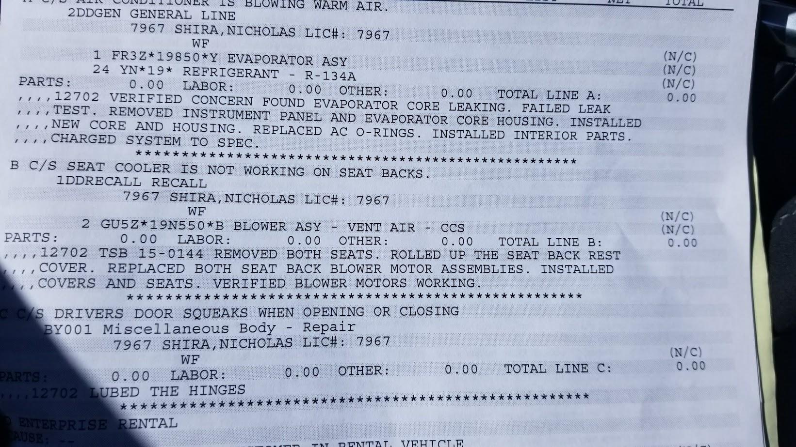

If FR3Z-19850-W is the evaporator part # it looks to be on backorder through Ford Parts. :doh:
ryant601
Feb 12, 2015
88
994
162
Ryan
'16 GT - Black Accent Package
mine ended in y, but i think was was a difference between models, i forget
Damn, that tech earned his keep.
I think Y is for the dual zone. Of course that one isn't on backorder. I'm hoping it's not the evap and maybe something stupid. I had to replace the oil switch a few weeks ago after flooding, wondering if it hit the ac switch too and it's messing with it.
I'm overly optimistic sometimes.
