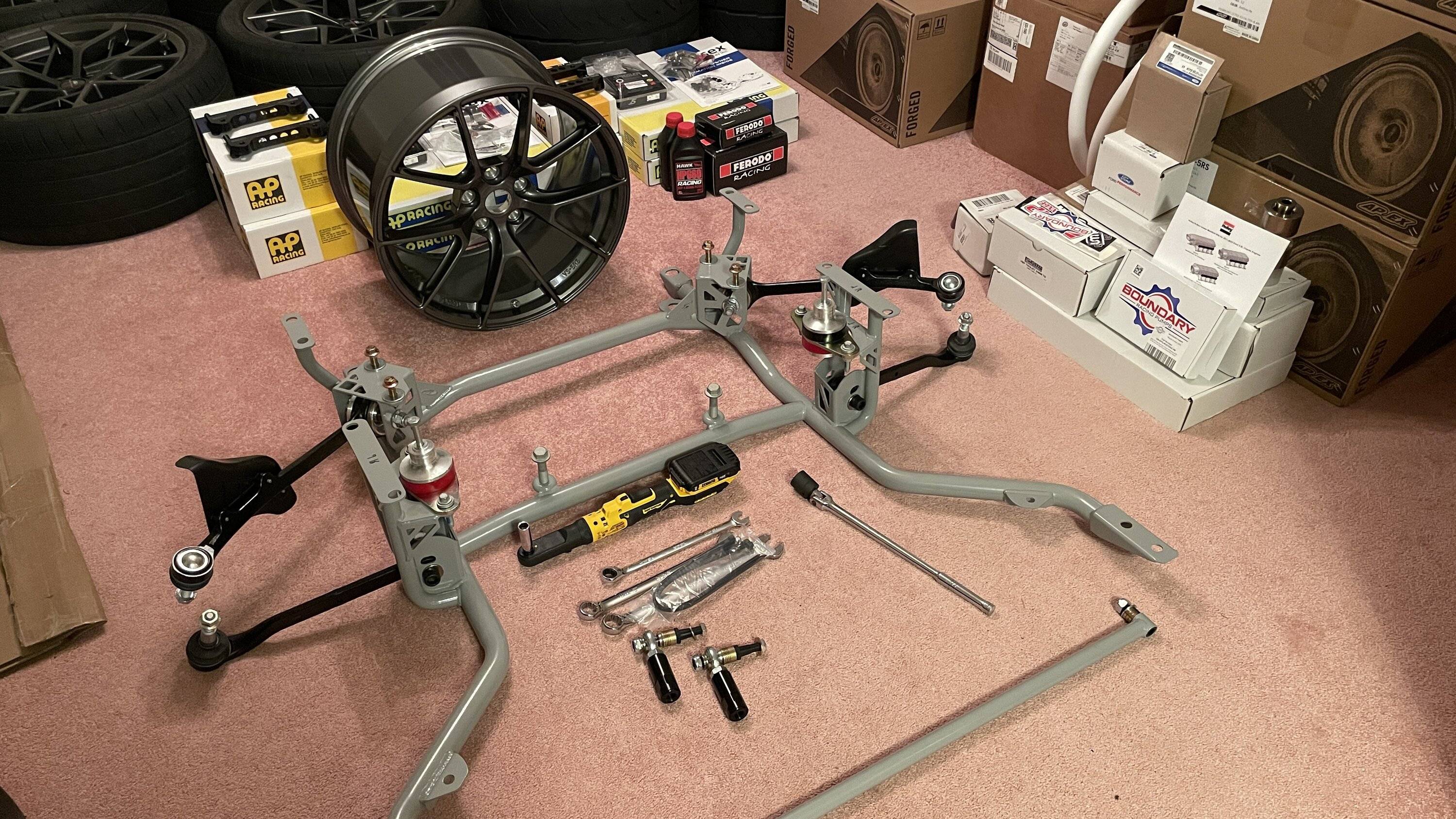

Yeah, I have to remove the unit from the frame to do the full calibration. But that’s the first step in any alignment. I don’t approximate driver weight. I’ve never seen a shop do it. Maybe in a race shop. I’m in the middle of swapping into the road race K member from Steeda along with bearing lateral and tension links, and numerous other mods. ‘tis the season for car mods in chilly Ohio. And another alignment. The adjustable track width will be interesting.
