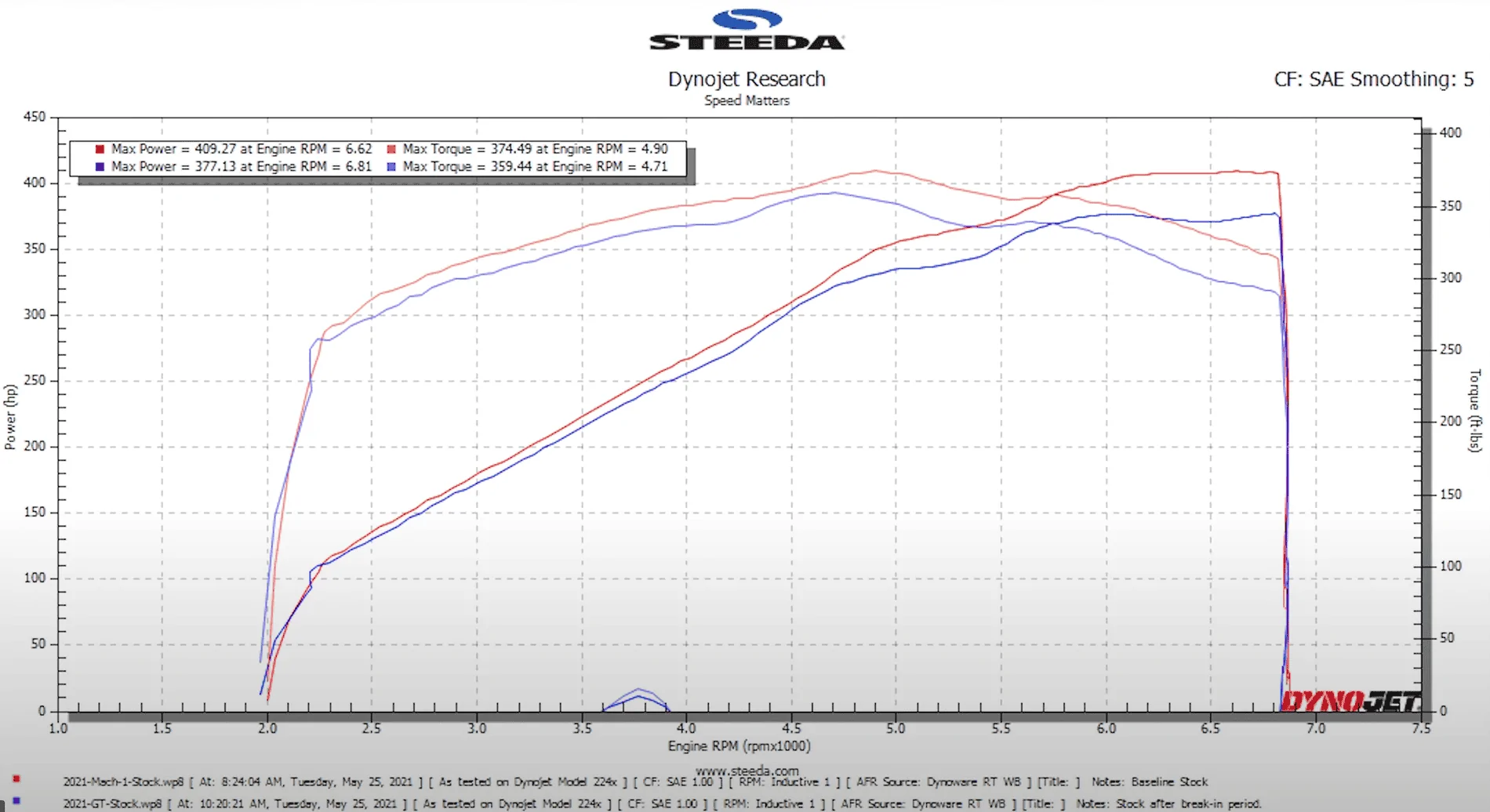

I guess my first question is, what exactly are you doing? Like mashing the pedal at a green? Because we know how that can turn out....
This was posted on the Mach subforum, it compares a 2021 GT to a 2021 Mach on a dyno run. The GT really doesn't have a ton of power at low RPM's (of course coming from a Miata, 'a ton' is very much a relative term)
Per this you really need to get the revs up a bit before power kicks in. If you want to replicate the Mach's curve, I'm pretty sure the biggest difference is the GT350 air intake and throttle body, which I would imagine shouldn't be all that difficult to replace/install since the GT/Mach/GT350 share so much commonality.
EDIT: Here's a link to said parts for $1k
https://www.cjponyparts.com/ford-pe...kit-procal-4-mustang-gt-2018-2020/p/M9603M8B/

I'm not mashing my gas at all honestly. I feel like revving the engine feels unnatural to me since I have not done that with previous cars that I have owned. I just feel like from first to second gear car feels so slow that I got tailgated sometimes but cars that are automatic.
