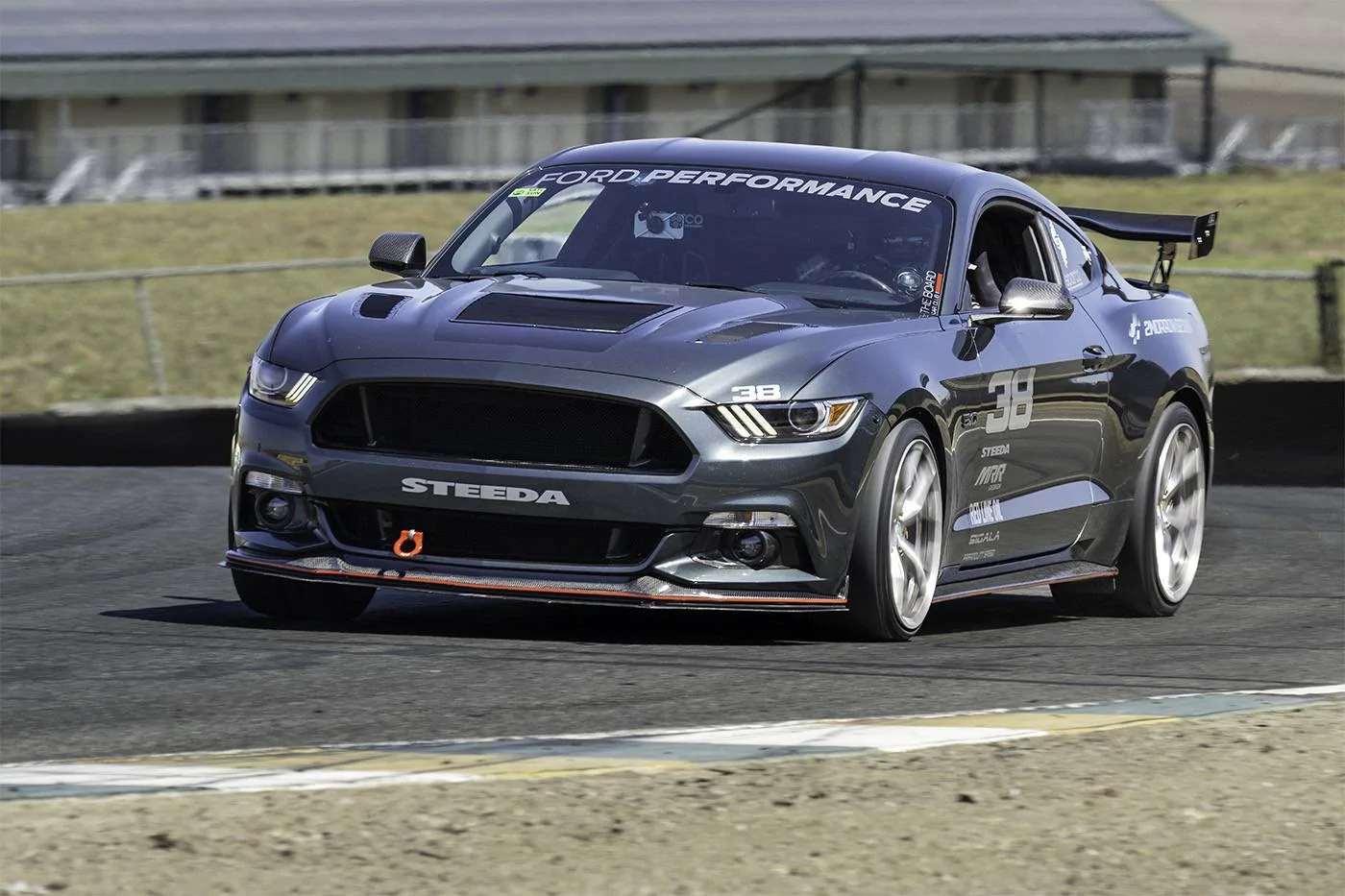

Maybe my frame of reference differs from most as this is my usual activity in this car lol
Well, um, yes I’ll admit that’s a little past my frame of reference for sure. Not counting what’s in my mind!
