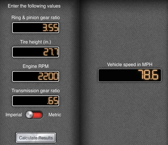

I just bought a 2020 GT, Performance Pack, automatic and I'm turning about 2,200 rpm at 80mph and I'm wondering if that sounds about right for the stock 3:55's or do you think the gearing has been changed?

You didn't mention what tire size you are using.
But, 3.73's would be closer to 73mph and 3.15's would be closer to 86mph

Depending on whether your tires are stock or not that sounds right. My Bullitt with 3:73s and 315-30/20 rears is about 2400 at 80mph

I'm guessing that's right because on my car I'm turning about 2000 rpm with my 3.15 gears.
