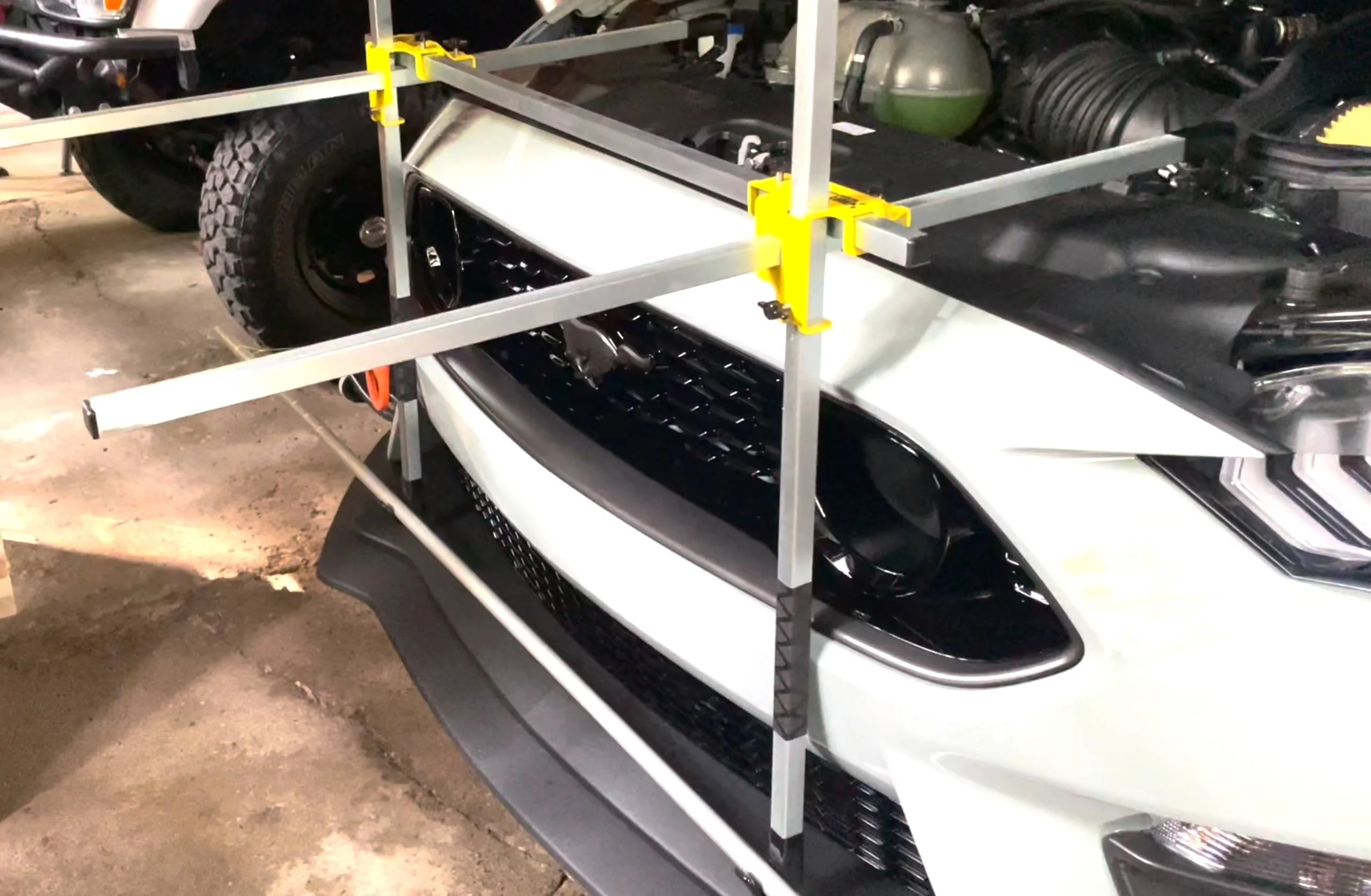

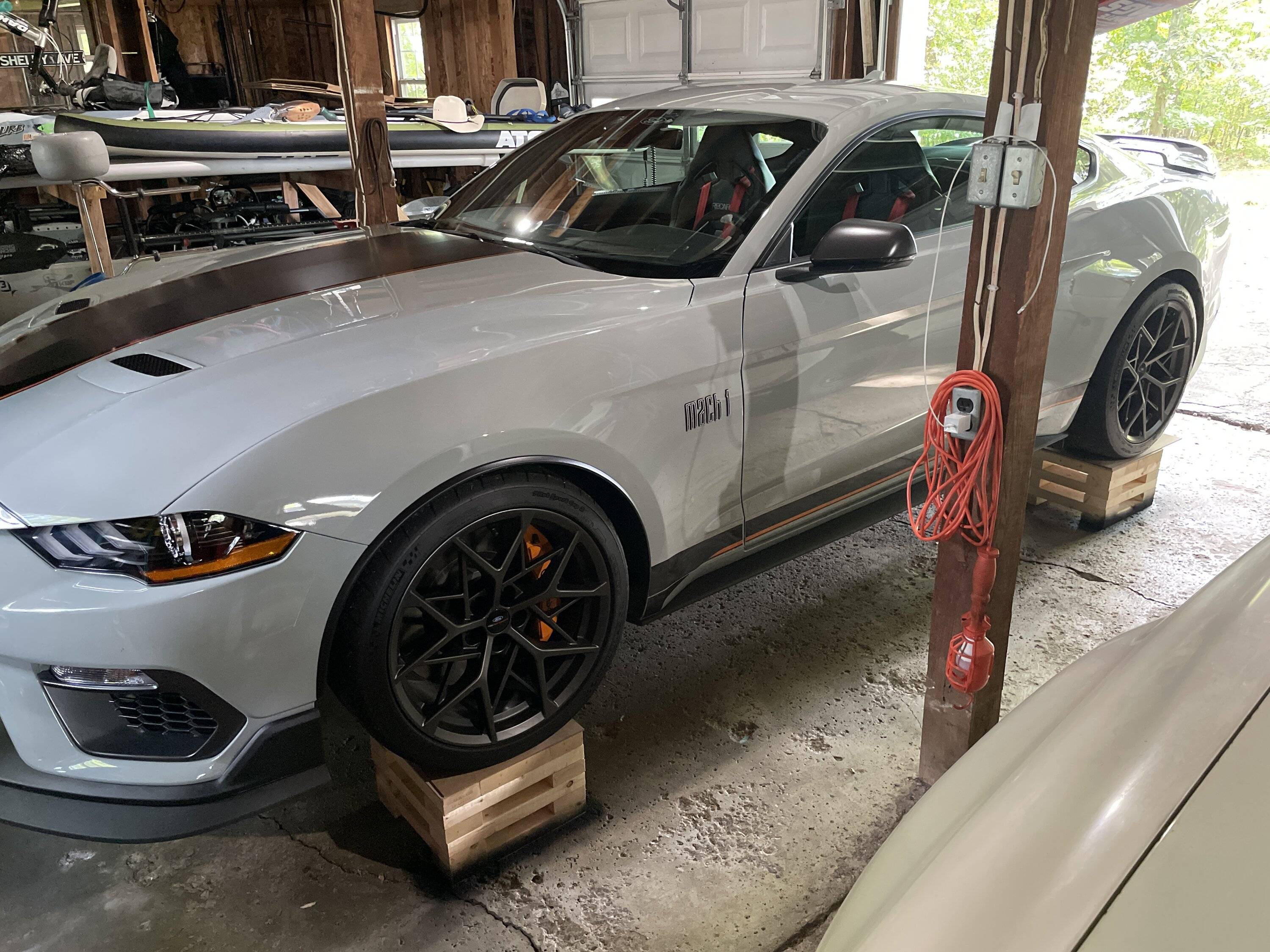

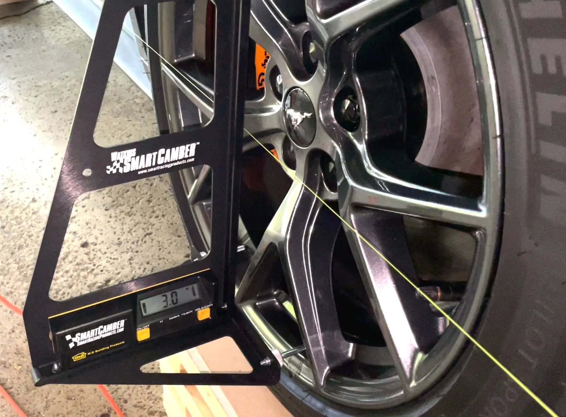

Be careful with who does your alignments. I took my Mach to a shop to check what I had done myself. they changed the front camber. I told them to set -2.8 front. when I got it home set it up on my stands and discovered -1.7 left and -3.0 right side. I thought maybe it was my garage but couldn't measure any more than a tenth of a degree in the lateral angle of my garage floor. The next track day confirmed my readings and I haven't let another shop touch it. I have a Smart Strings setup that is pretty easy to use with their electronic camber gauge and frame.

Im amazed no one has a rig that bolts to a stud, or uses an expanding collet for the wheel bore.
