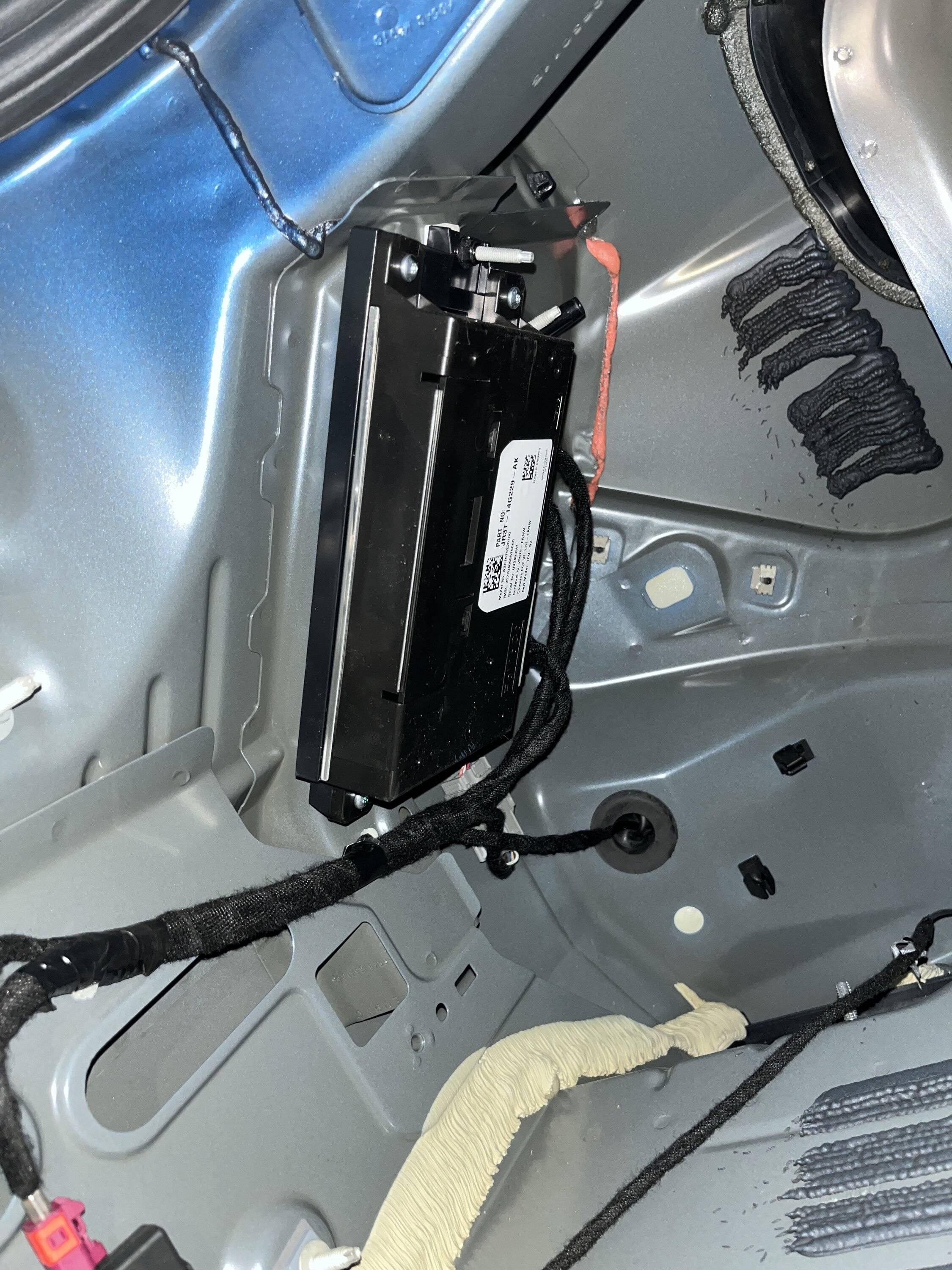

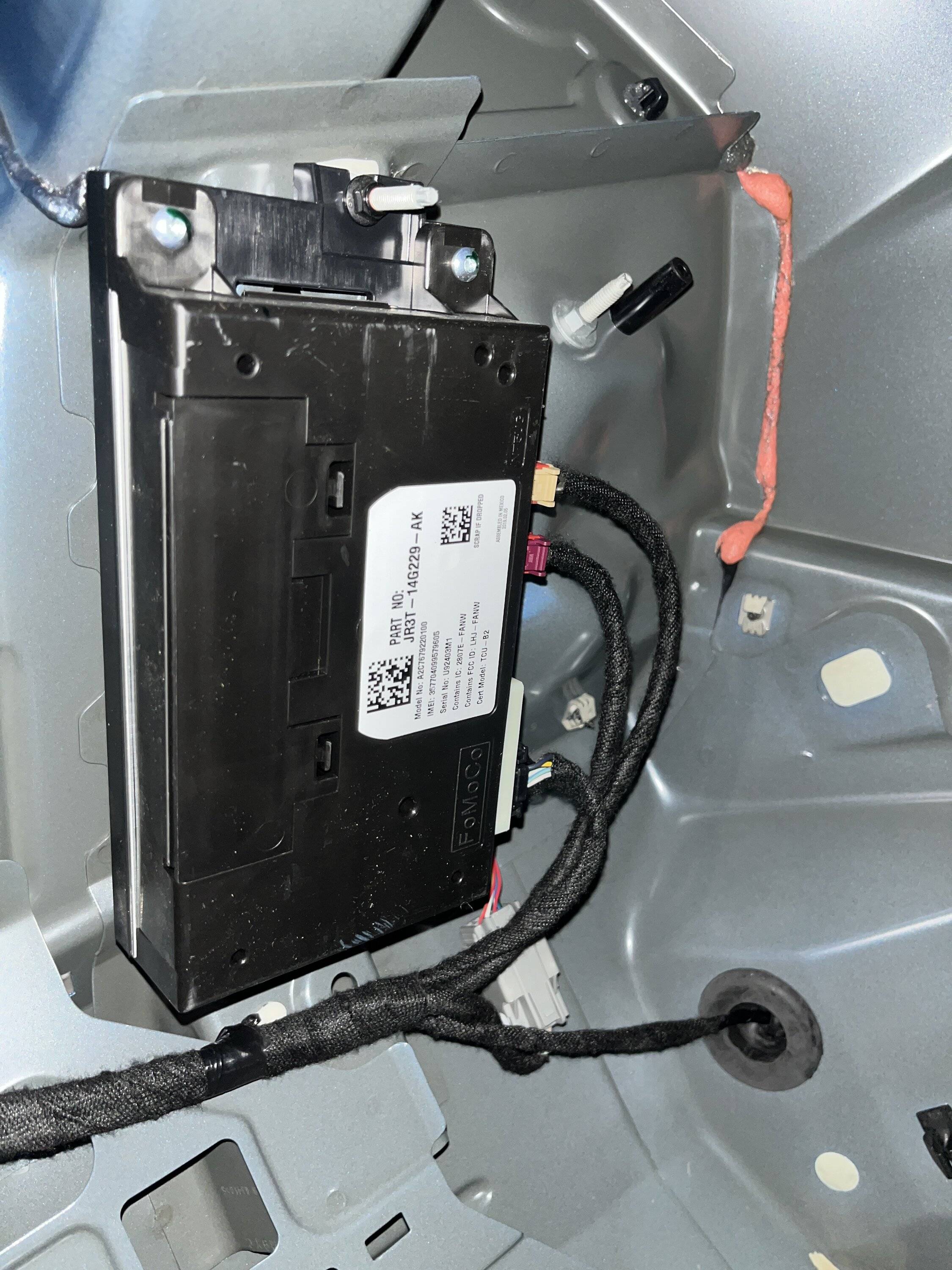

So I have my entire trunk liner and plastic removed for another project. I see the box I think you are referring to by the drivers side trunk area inside the trunk behind the plastic panel. Do I just unplug that vs trying to dig out the fuse? Does that box do anything other than acting as the modem?
Yes, that's the one. Pull the wiring/data harness. For good measure pull out the two coaxial leads too.
You will get no CEL lights, but a scan will show diagnostics in relation.
Pull the plugs!
