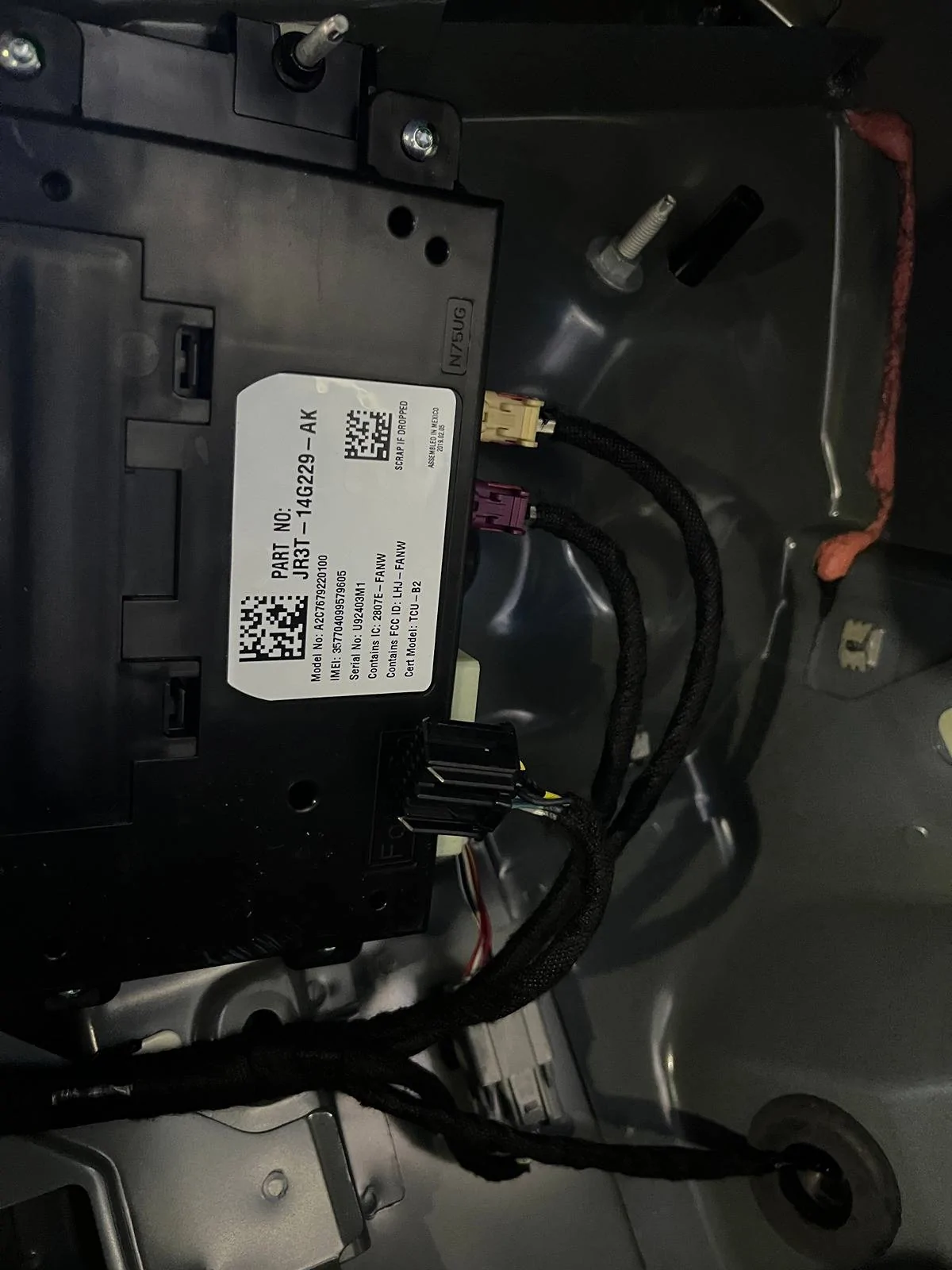

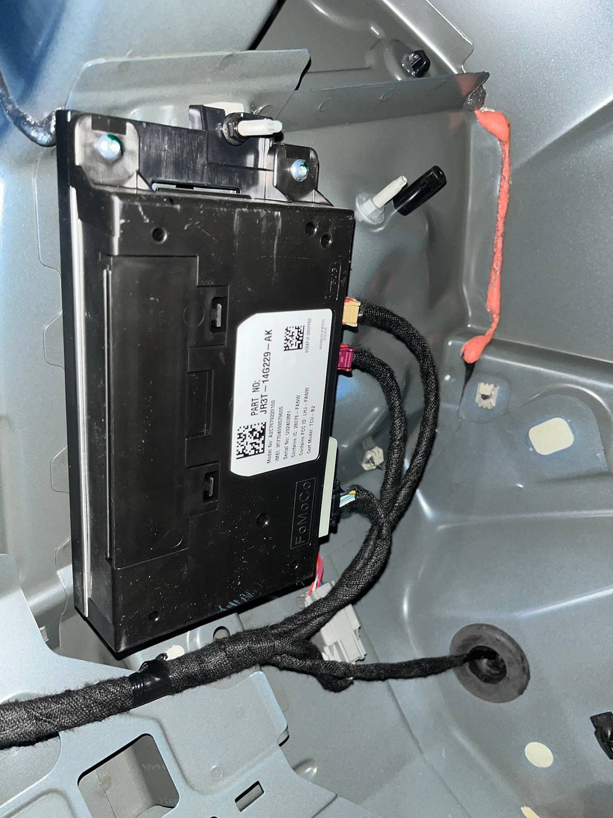

Finally got it done this past week. I had a buzz/rattle in the trunk area and had to remove the whole liner and plastic trim piece at the front of trunk, thus exposing the modem.
Felt better about unplugging there instead of messing with the fuses.

Just pull the wiring on the modem itself. See the last couple of posts on how to...

Ah, interesting thanks, the trunk sounds less intimidating than interior footwell trim... Is that just around where the spare wheel well is? And I guess you left the yellow and red in place, but yanked the black-ended cable, which was likely power?
it's right behind the taillights on the left as you are looking down into the trunk, there are 3-4 plastic knobs that you have to unscrew to remove that panel, then pull the left hand side (facing) of the liner back to view the modem. I pulled the power plug but left the coax connections in there. I don't think there is a reason to unplug all 3 as long as there is no power going to the unit

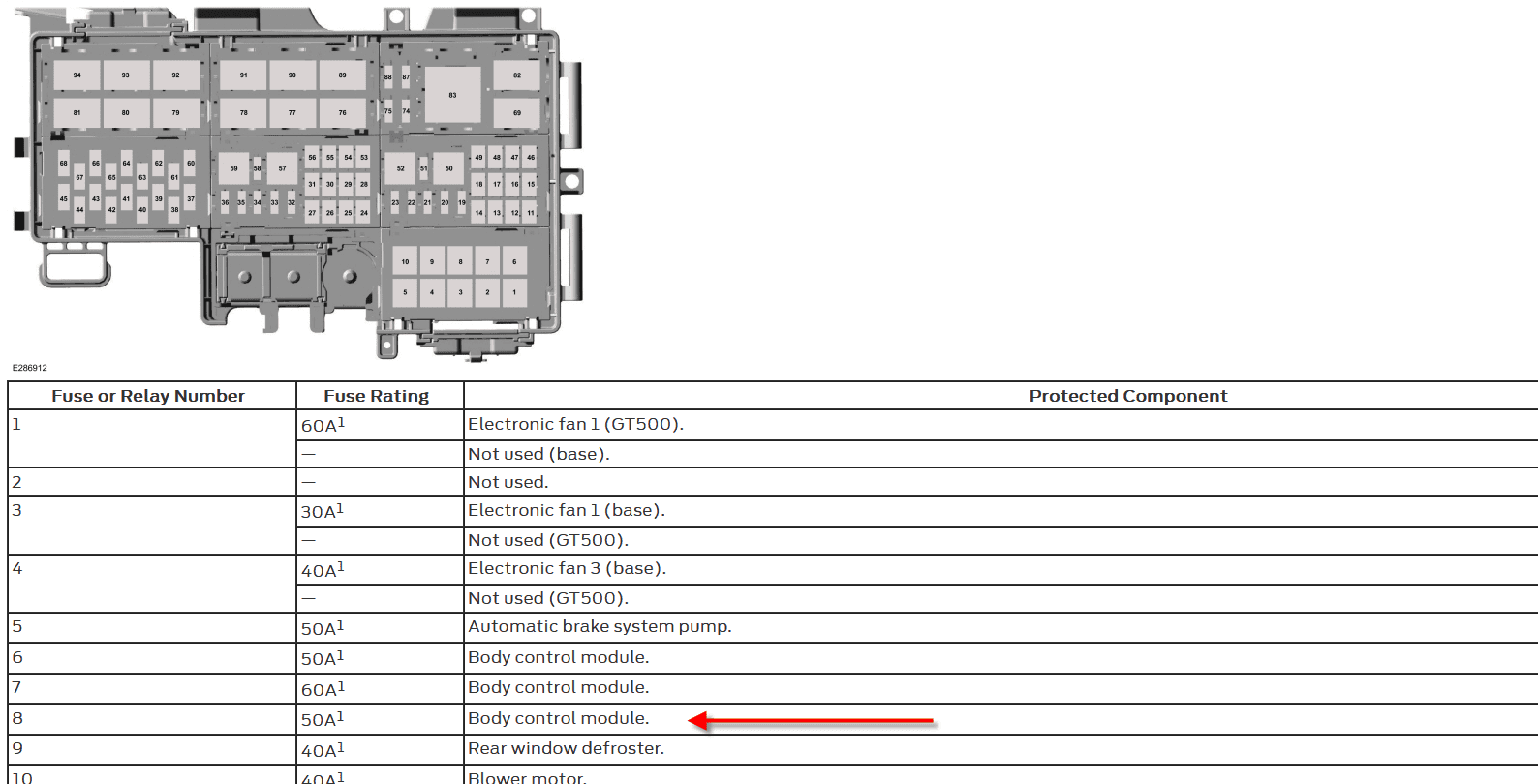

I just looked at the 2022 owners manual for fuses and not one fuse is named telematics or modem. Am I just missing it?
I don't like to mess with the fuses.. that is why I pulled the plug on the modem itself.
#8, 5A, Telematic Control Unit - Modem. Passenger compartment fuse panel. My manual for my '22 had this and I confirmed that that fuse worked
This is on the Ford site for 2022 Mustang. I haven't looked in my actual book yet as it is at home.
