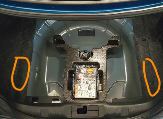

Here's some additional data on where different antennas are located:
Thanks to previous diagrams, I was quickly able to locate very strong signal from two antennas (circled). They are below the sheetmetal, so access would be from below the car:
When vehicle hotspot is turned on, these two above are pulsing to beat the band. I do not know what purpose they serve other than creating the in-car Wi-Fi hotspot network, if any. I was unable to detect any RF from these locations except when hotspot was on.
