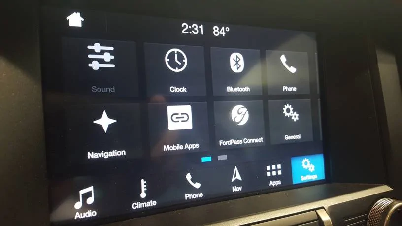

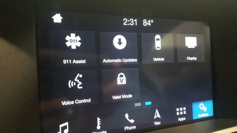

I could have sworn I previously connected my GT350 to my Wi-Fi, but yesterday I could not find the settings in the infotainment screen. Maybe I did that on a different car? Do our cars have the ability to connect to the Wi-Fi or not?
I figured I'd go ahead and turn my Wi-Fi on and test for you guys if the car is able to send its data this way, but I just couldn't find the setting!
EDIT:
The car can in fact scan for and connect to Wi-Fi networks even when the modem fuse is pulled.

I think you lost the WiFi + hotspot icon because you pulled the fuse. Put it back and see what happens.
drummerboy
drummerboy
Mar 15, 2019
478
432
SoCal
'19 GT350
Hotspot menu is available at all times, just pops up an error if the fuse isn't in. Wi-Fi nowhere to be found with fuse in or out.
Bikeman315
Apr 12, 2015
583
16,194
21,915
Myrtle Beach, SC
Ira

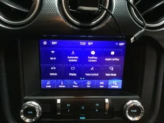

Gee, that’s nuts. Maybe do a master reset? Can you find the controls for auto updates?
drummerboy
drummerboy
Mar 15, 2019
478
432
SoCal
'19 GT350
Bingo, all of the Wi-Fi settings are under automatic updates. Thanks!!
The car can in fact scan and connect to Wi-Fi networks even when the fuse to the modem is pulled.

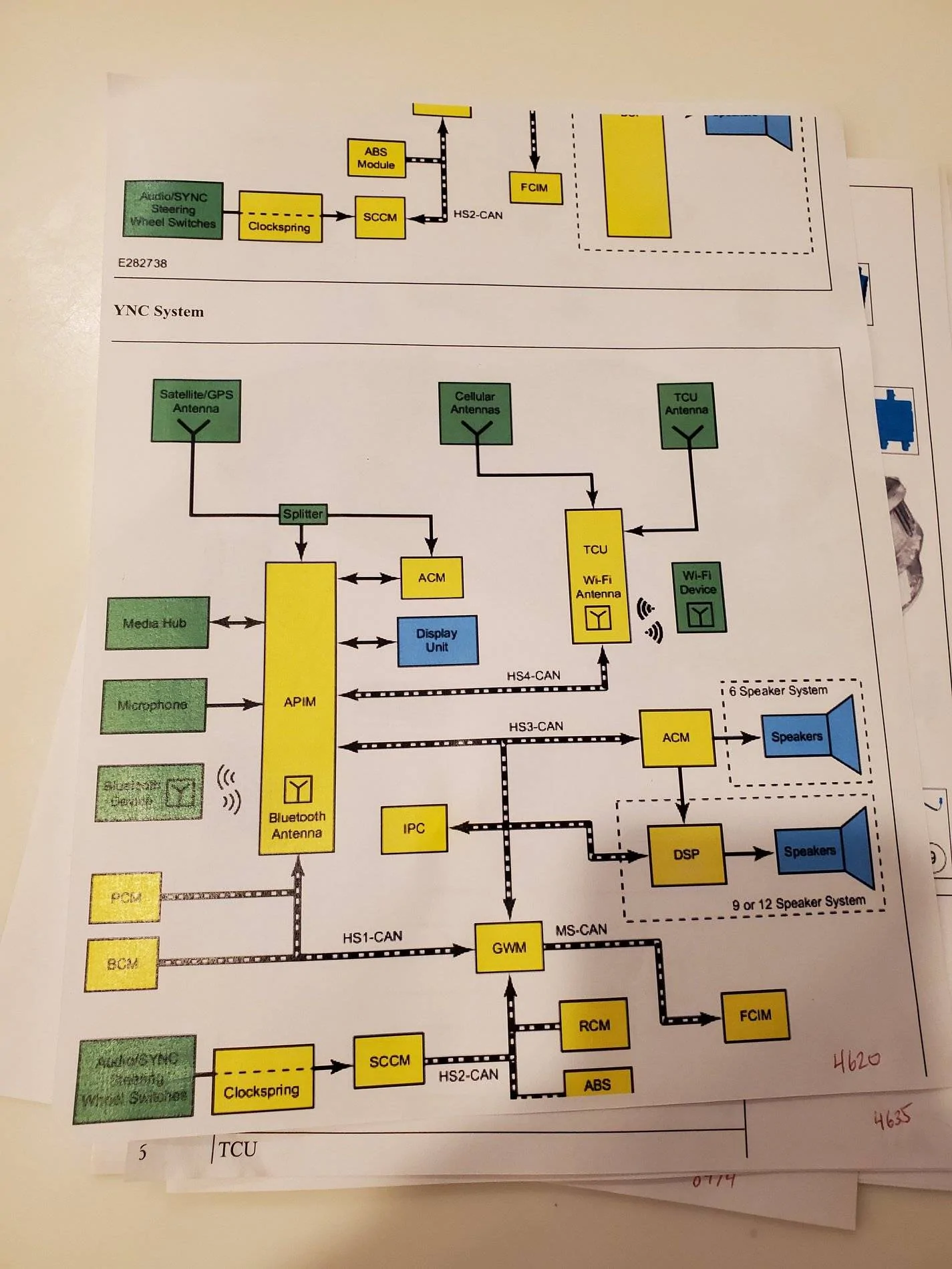

Alright, ill bite.... how is the wifi disabled? The below diagram is not useful. It is showing the TCU to contain both the cellular and wifi module.
drummerboy
drummerboy
Mar 15, 2019
478
432
SoCal
'19 GT350
Well... haha... Isn't that interesting. Is that diagram accurate to a 2019 GT350?
