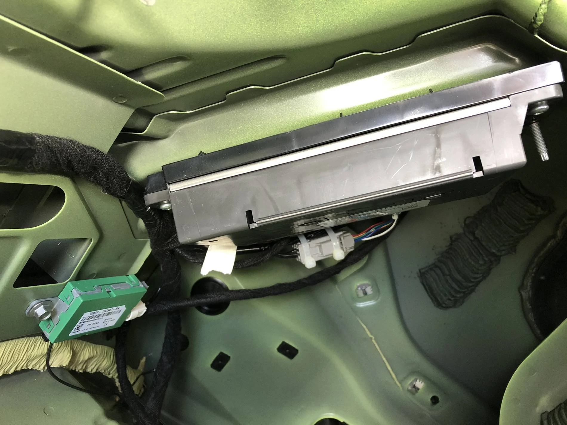

Modem on 2020 UK spec car :
One multi plug and one coax going to it.
Apologies if this is duplicated info, I’ve only skimmed the later pages of this thread :like:
WD :like:

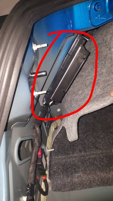

Right on. I didn't look at mine too close after locating it. Just a plug and a coax, eh? I think it's a pretty safe bet the coax eventually ends up at an antenna under the package tray.
Don't know what your little green box there is, didn't look too closely at that either. Mine's a bit different:

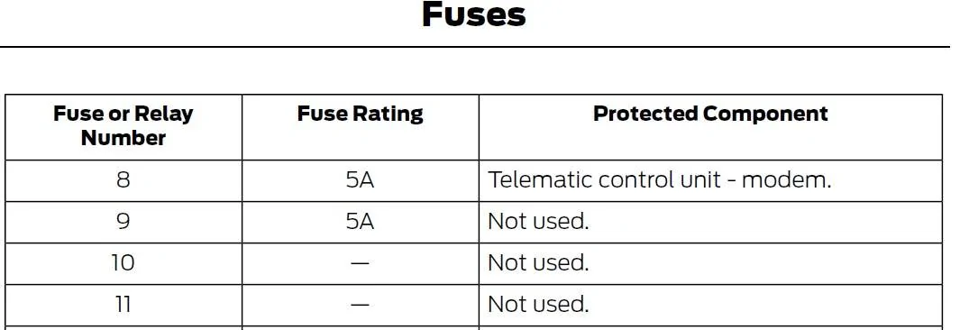

STEP 1) Disconnect fuse #10: Telematics
The 2020 manual shows it now as fuse 8. I removed fuse 8 and noticed nothing amiss.

What MY did this start?
Can anyone say when the fuse moved to #8.
Until someone replies and knows exactly, I think I remember this first started with the '19 model year, and the fuse moved to 8 in '20.
I found it in the manual, you can find which one it is in there or also do a quick search for 2019 Mustang Owners Manual and download your manual from the Ford site.
And recapping earlier conversation to the best of my memory, for now I don't think anyone has found that the circuit the modem is on has anything else in there with it on a Mustang, though I believe I saw other things tied in on other models. Unplugging the modem itself would also suffice, it is easily accessed in the trunk (I think I have pics of this in this thread). Additionally, Tomster has some great content on this topic in his thread in the GT500 forum. Between these two threads, the fuse, the modem, and the antennas are all located with details in the discussion. On mine, just the fuse completely disables it, so I'm a member of the #PullTheFuse gang, but the other disabling methods are also simple. YMMV, but you can test if it's working with the FordPass app.
Yes, I am also a #PullTheFuse gang member ... lol
It was also number 8 on mine (euro 2020) and I haven't found anything that doesn't work (other than the modem) after pulling that fuse :like:
Pulling the fuse just seemed like the quickest easiest way for me.
