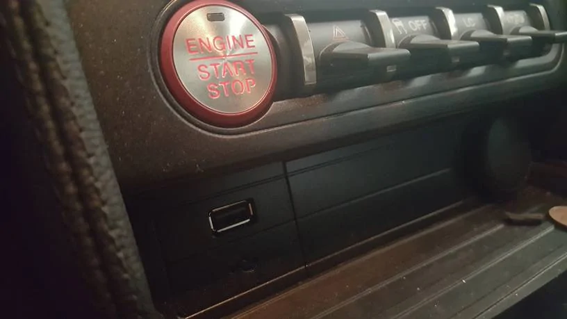

how is the wifi disabled?
Ok, your plan A should be checking for a powerful Wi-Fi antenna directly below the ignition button behind the USB port. RF meter showing a huge broadcast from precisely that location as the car scans for Wi-Fi.

Thanks. It is a collaboration of all interested parties. Next on the list is the wifi.
Its gonna be a while before I get my car back, so sit tight
Edited to add:
What meter are you using to measure wifi output? Link?
For this purpose and other fun, I'd imagine any RF meter would do, but the best bang:buck and ease of use is honestly this one, with the speaker and the info on the display being absolutely critical to being able to pinpoint the Wi-Fi antenna location in a cramped space like a car in about 30sec. It's extremely accurate and easy.

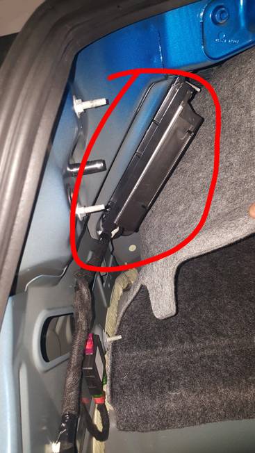

Hey I was eyeballing that one 3D diagram again and decided to go take a peek. Literally took 30sec to locate the physical TCU/modem, part number JR3T-14G229-AK and IMEI printed on the label. It's directly behind the left rear tail light, peel back the trunk liner a few inches and you'll see it.
