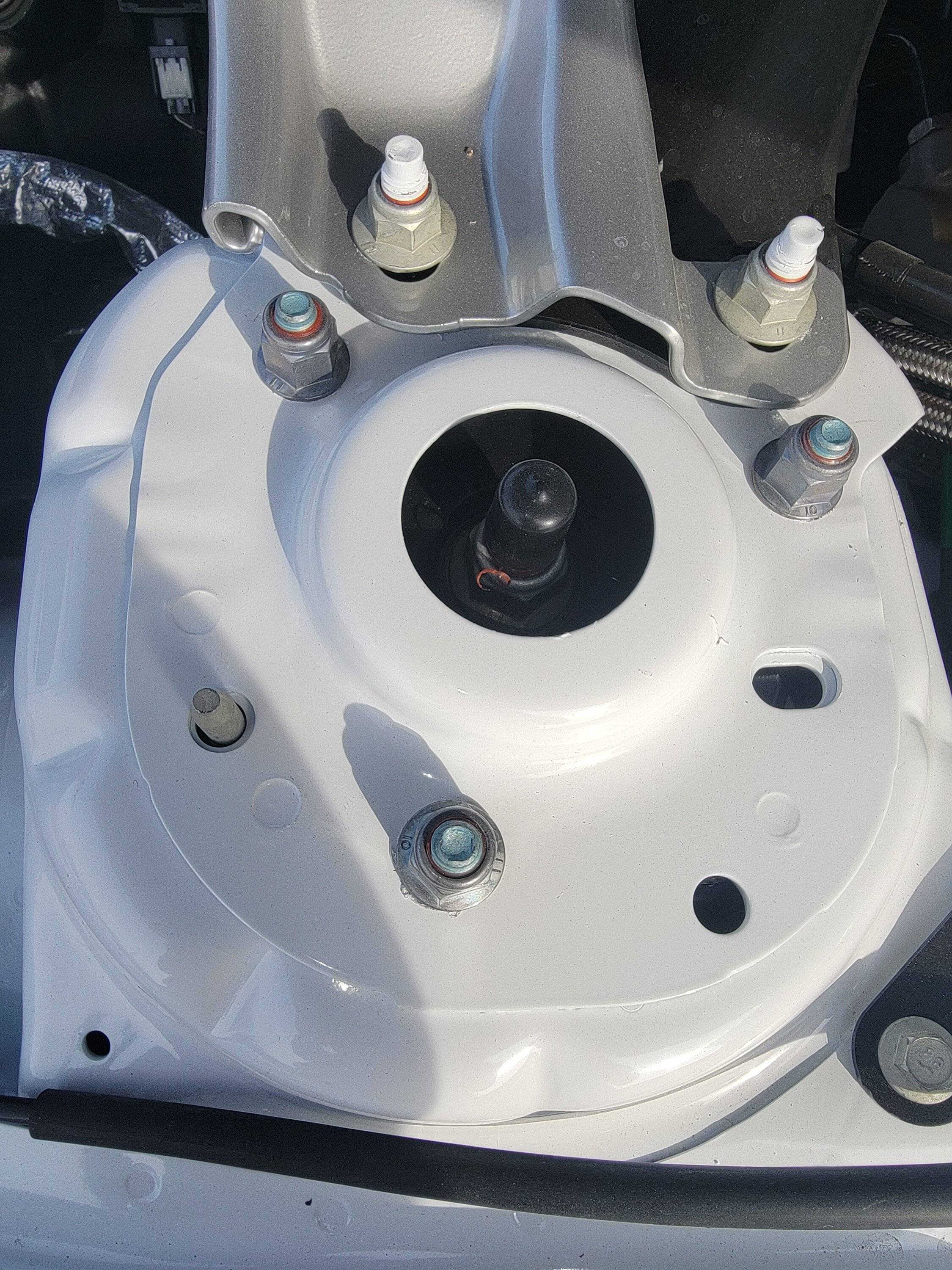

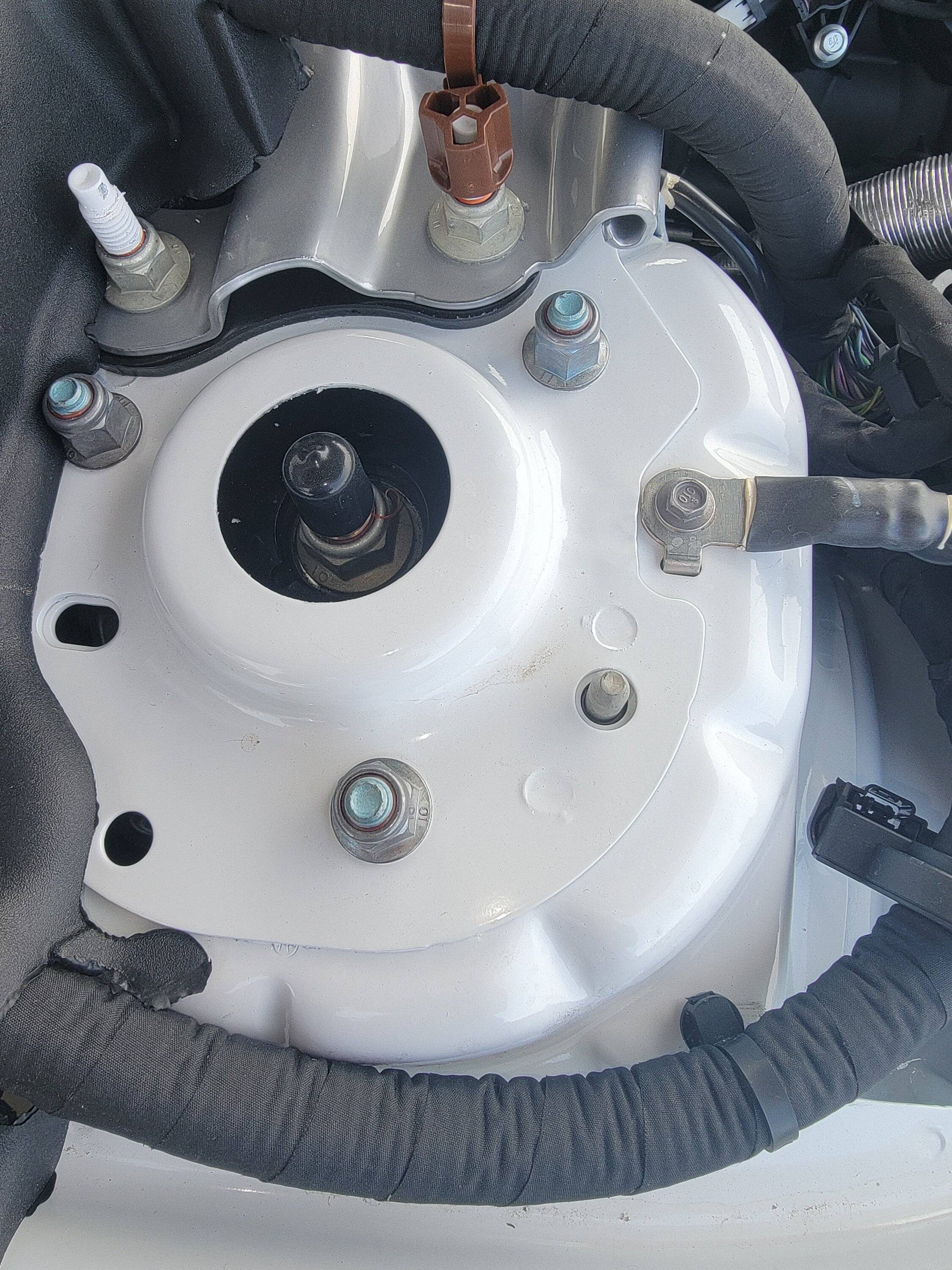

I just picked up my M1 HP yesterday. My build was wrong in that I didn't order a premium but they put in leather Recaro's instead of the cloth ones. A friend that was with me has a GT350 and his adjustable strut mounts were sent separately from the car. I told him that was changed for the Mach 1's and GT500's. The problem is, neither of us knew what to look for to make sure they are actually on the car. Since they put the wrong seats in we were wondering if they built the rest of the car right :). Can you tell from these pics if the adjustable mounts are there?
need to look for the part number sticker slightly under the strut top hole.
Those are the adjustable camber plates that come on the HP.
Leather Recaros are commonly put into 600A cloth Recaro seat Mach 1’s due to parts availability. It wasn’t a mistake but rather a purposeful substitution by Ford.

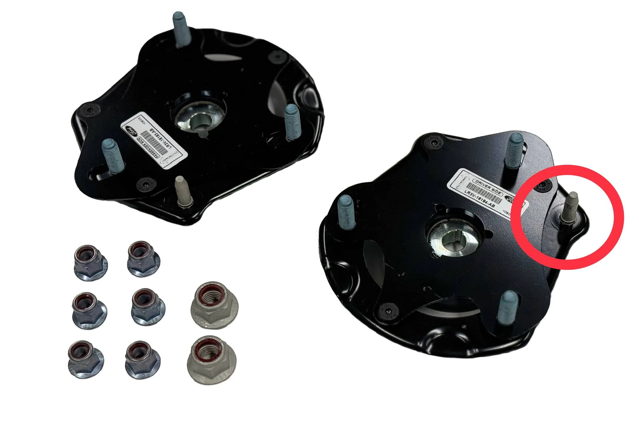

I know you have already had the confirmation you were looking for, but for future reference, or for others reading this :
The easiest way to identify the factory Ford camber plates, is by the pin that protrudes through the strut tower hole (that hole is normally vacant) :
WD :like:
Epiphany
Oct 11, 2015
78
7,988
13,647
Global
I like to disassemble things.
I was going to say the same thing about the pin. Well put WD.
