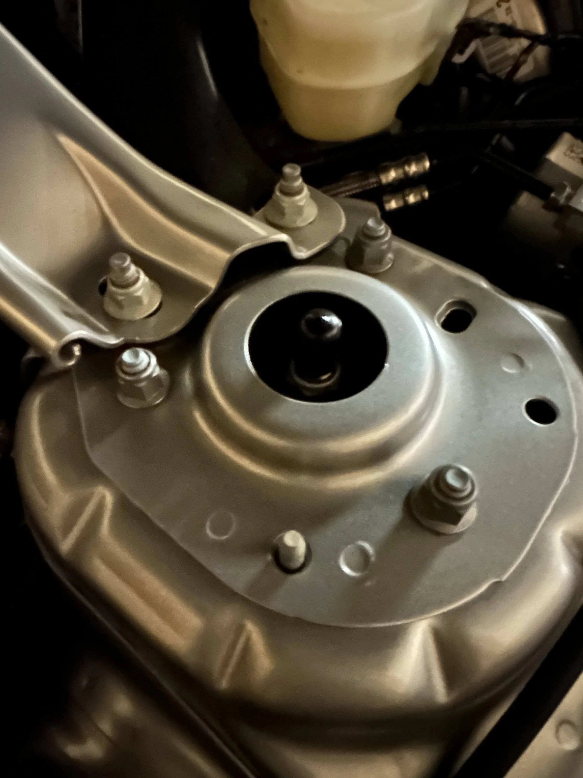

Come to find out, these are not installed on the car from the factory. Did anyone who has the HP, get the camber plates when you purchased the car?

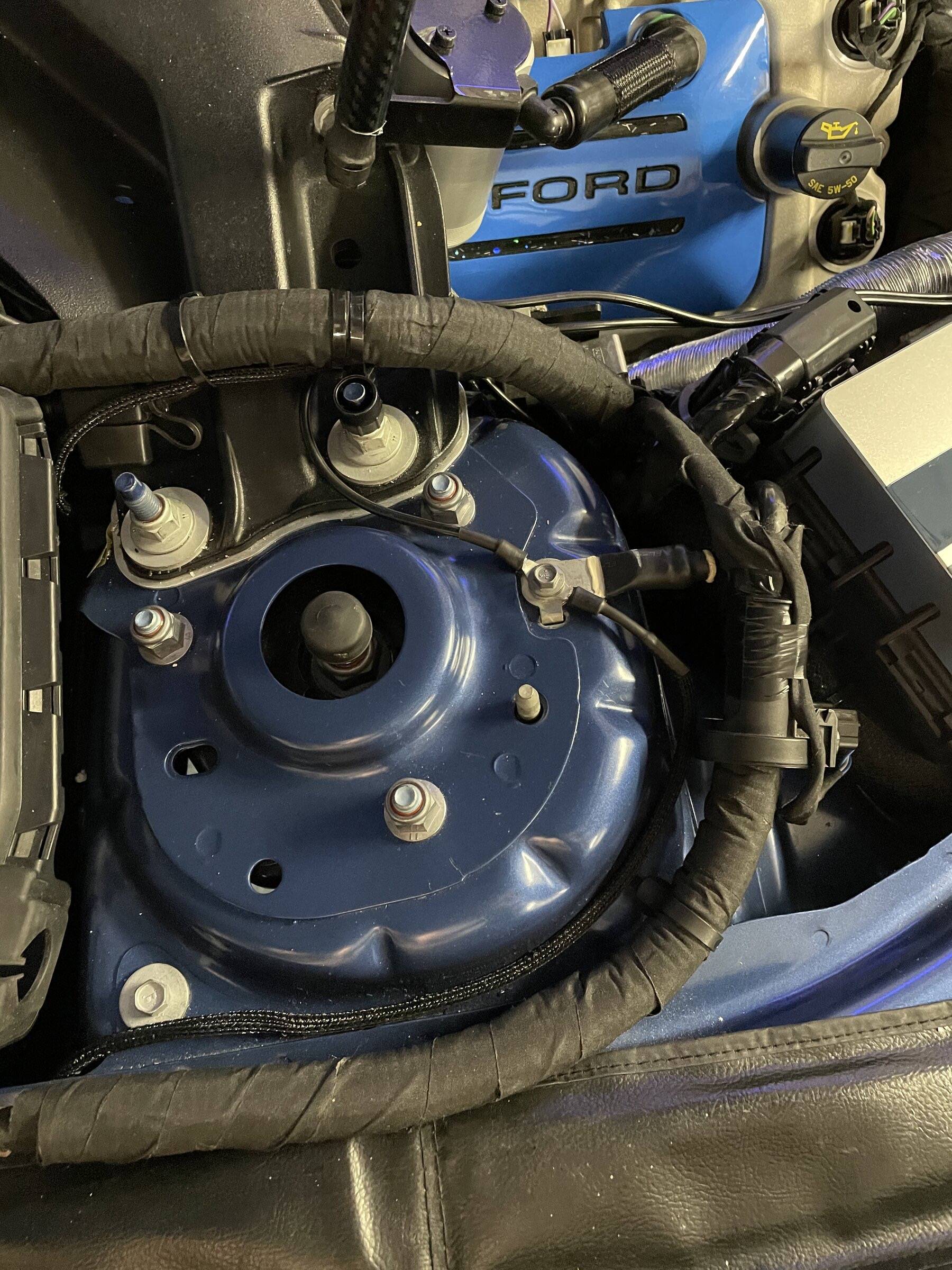

If you have a pin protruding through the strut mount amongst the 3 studs in the engine bay, you have the camber plates. Ford installs set screws to lock them in. To remove the set screws, there is a procedure for that. First verify the pin. If so, follow these threads borrowed for the GT500 sub forum. The pic is NOT of a mach1 but is similar in nature.

RobZ71LM7
Oct 14, 2021
794
1,296
Louisville, KY
Rob
2021 Mach 1, 2019 F-150

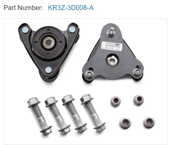

They are factory installed on Mach 1 HP’s. It’s likely you have the set screws in place which may have confused someone trying to do an alignment. As mentioned above you should see a pin. From the factory that plates have that pin. If you order them later (like in your pic) from a dealer they do not have a pin. I’ve got a set of HP plates sitting on the shelf in case my Steeda plates get noisy.

Thank you all. Sure enough, the pin is there
