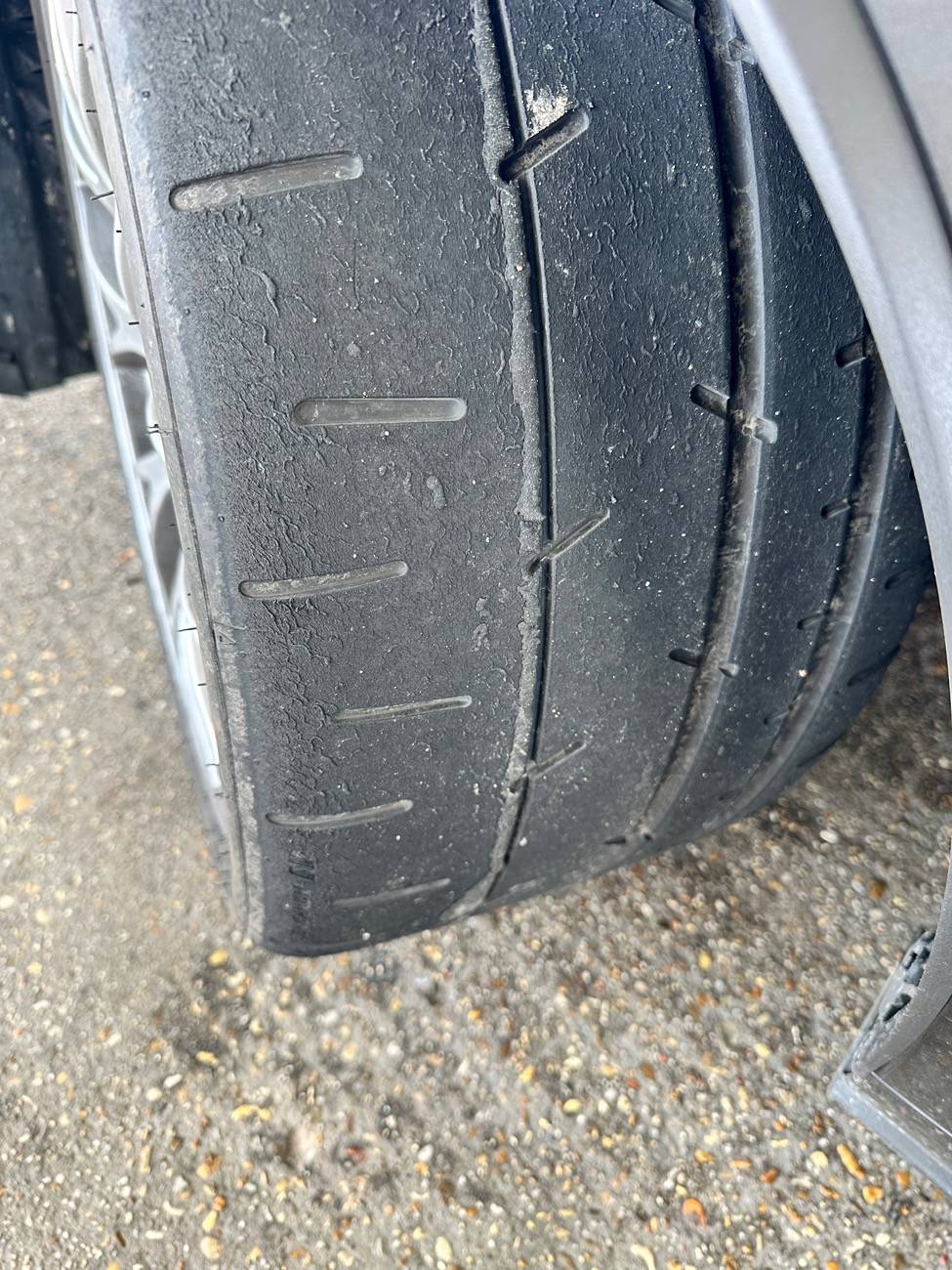

Outside wear on those tires look like your car can take a more aggressive alignment up front.

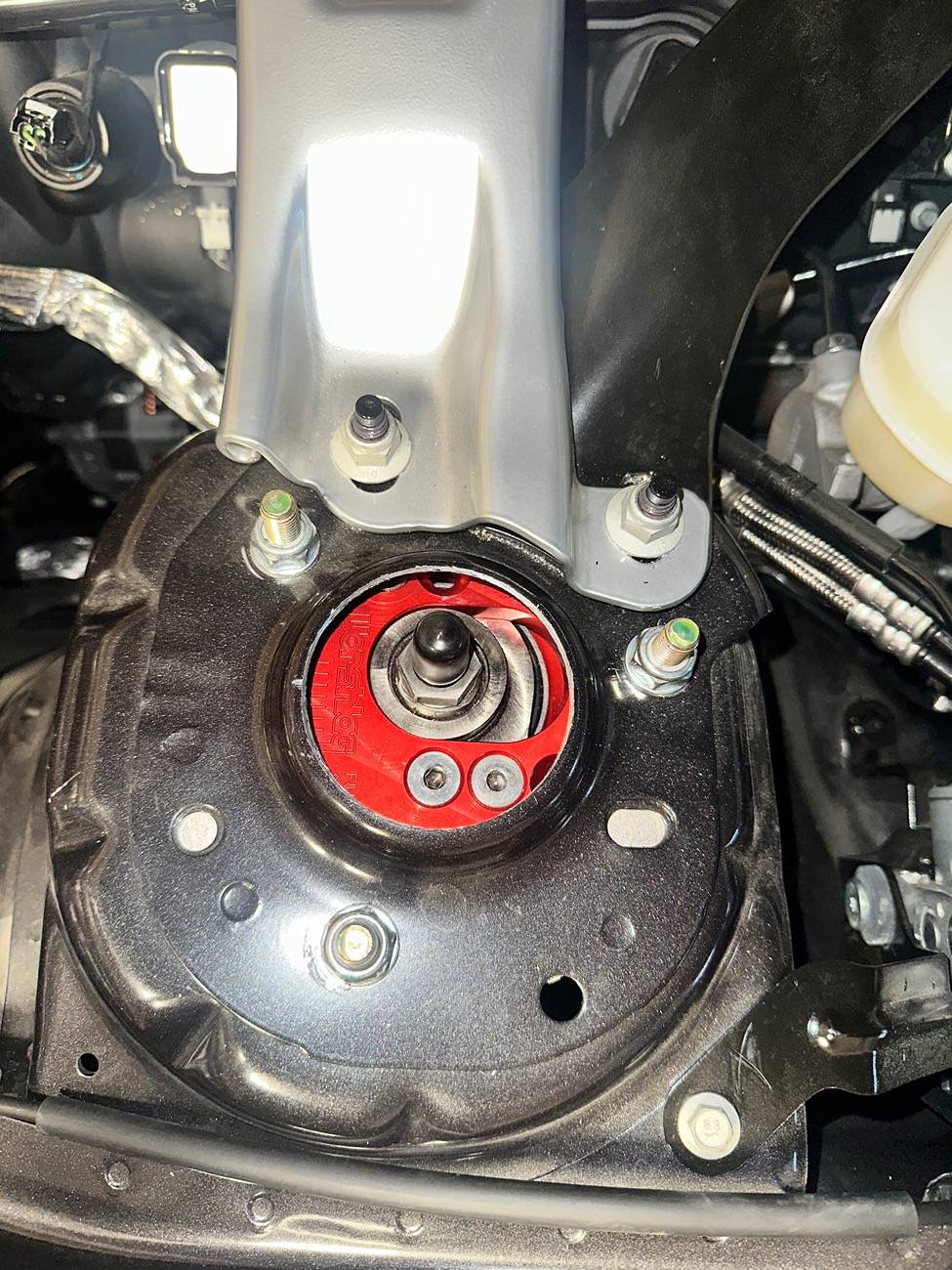

yes! Absolutely. We didn’t get a chance to do an initial alignment before weekend. So I just winged it. I did not go to the most extreme setting.
we will dial it in better,
weather was cooler on Sunday and I lowered air pressure a little and it seemed to help.
any other tips or advice! I’m all about learning it right the first time.

What tire pressure are you running hot?

I ended up at 32-33 hot. When I was above that, they got a little greasy.
