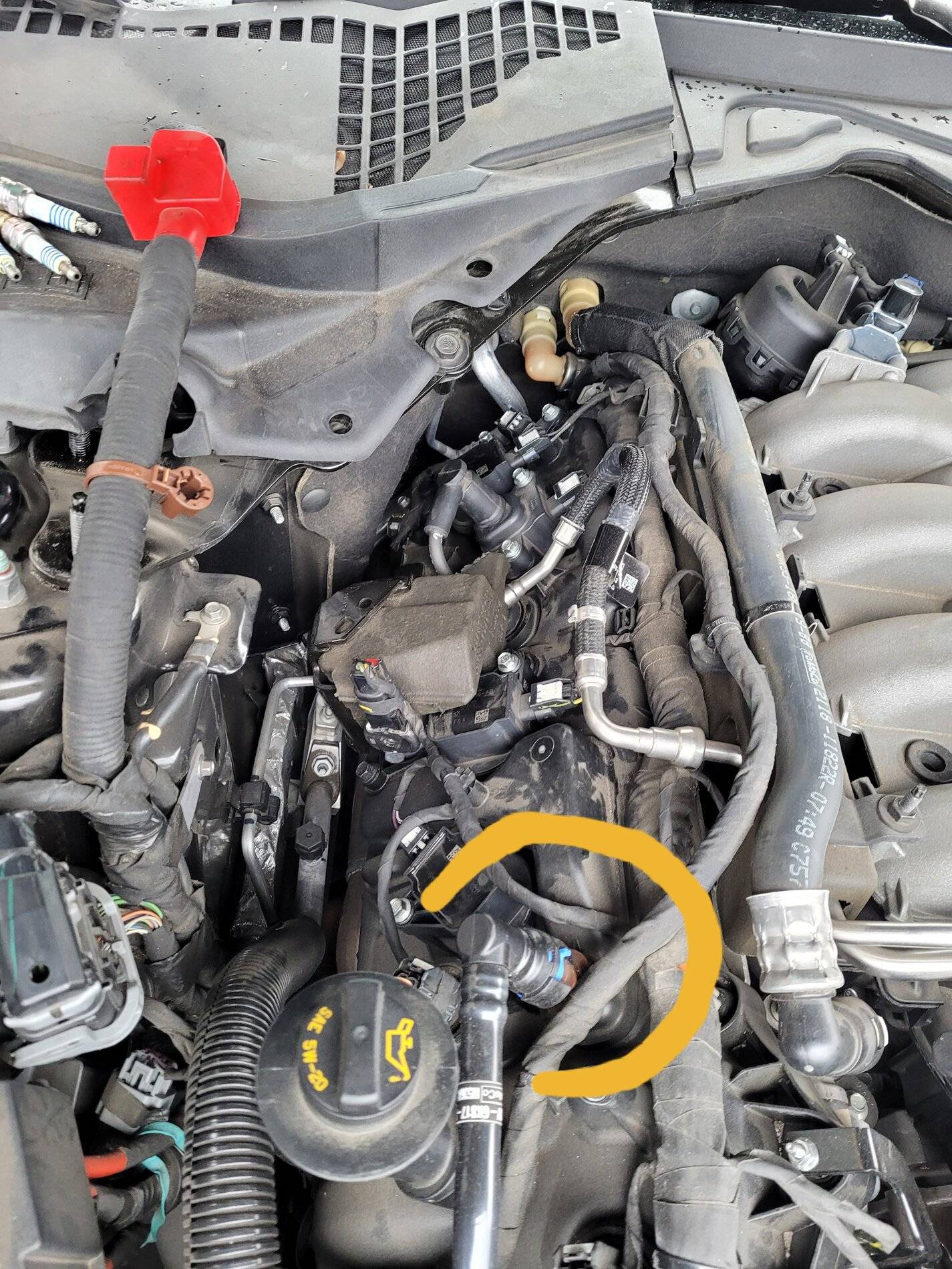

Anyone have a picture of the PCV located on the 18+ GT’s or where to locate it? Thanks
Right under that hose. Two things, 1. Don't be alarmed if the valve feels somewhat loose upon touch it should be. 2. If you pull it out, you will have to replace it with new one, the grommet is compromised upon removal.

Ok thanks for the picture. I’m assuming there’s only 1?
