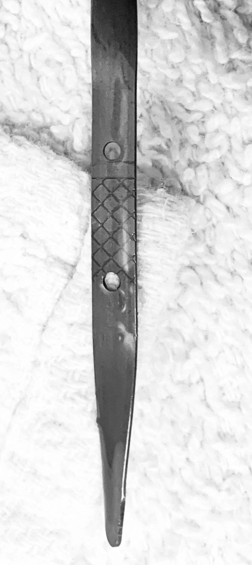

Ok, please pardon me for being an idiot.... I just have never done this stuff before. I went onto Youtube and located the area where I thought the dip stick was at, with this yellow tab and I pulled it out. Cleaned up the dip stick and put it back in to get an accurate read on how much oil there was. When I pulled it out, there was hardly any light brown substance on it. These pictures are terrible so they won't help much, but it basically stops just past that whole on our left. What do you guys think?

The manual says to check the oil 15 minutes after the car has been shut off once it has reached temp.
So when you get home from a trip wait 15 minutes and go check it. If it is below that lower hole add oil to get it over that hole. Keep a check on things and monitor how much you add in between oil changes. It's a high revving V8. It isn't unusual for some oil consumption between changes especially if you are going to do 5k intervals. A quart around 3k wouldn't be insane.
I've had mine a bit over a year and I do oil changes every 6 months regardless of miles (always well below 5k). It's a relatively cheap thing to do and I can't imagine it hurting things. If you are going out to 5k check oil often.

IDK to me it looks like your oil level is in between the 2 holes, where it should be. The oil is clean. It was definitely changed recently. As far as the oil monitor, the percentage goes down regardless of usage. It might go down more if you rack up miles but either way, it will turn on within a year after being reset. I put 3000 miles on my GT last year and it came on a year after I reset it at an oil change.

Looks like there is an oil on it and it's fresh therefore kinda hard to figure out the level - it will only show accurately on one side of the dipstick, there will be a line that you should be able to spot. Other side will have oil spread all over it.

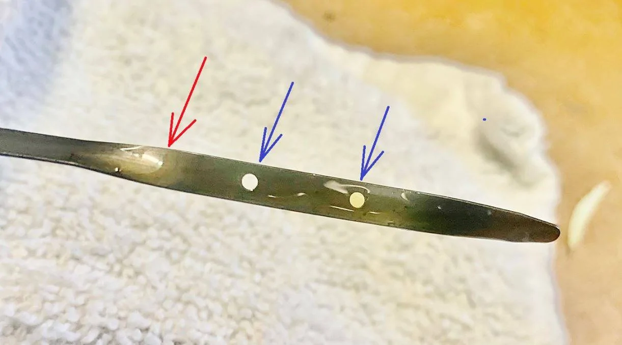

I took your dipstick photo and changed the properties to try and get a better look at it. You might try to verify if the oil level is at where I've drawn the red arrow. If so, it's too full. The level should ideally be at the top hole, and never go below the bottom hole (blue arrows).

First off thank you everyone for the replies. I’ve already learned a lot about a system I really didn’t know much about!
I can tell you the oil did not go past that second whole on the left side. What you’re seeing there is just a shiny reflection off some light. I can promise you it’s not over filled.
So best case would be the oil being at the top of that hole? I’ll have to try again after driving the car next time for a more accurate reading on it!

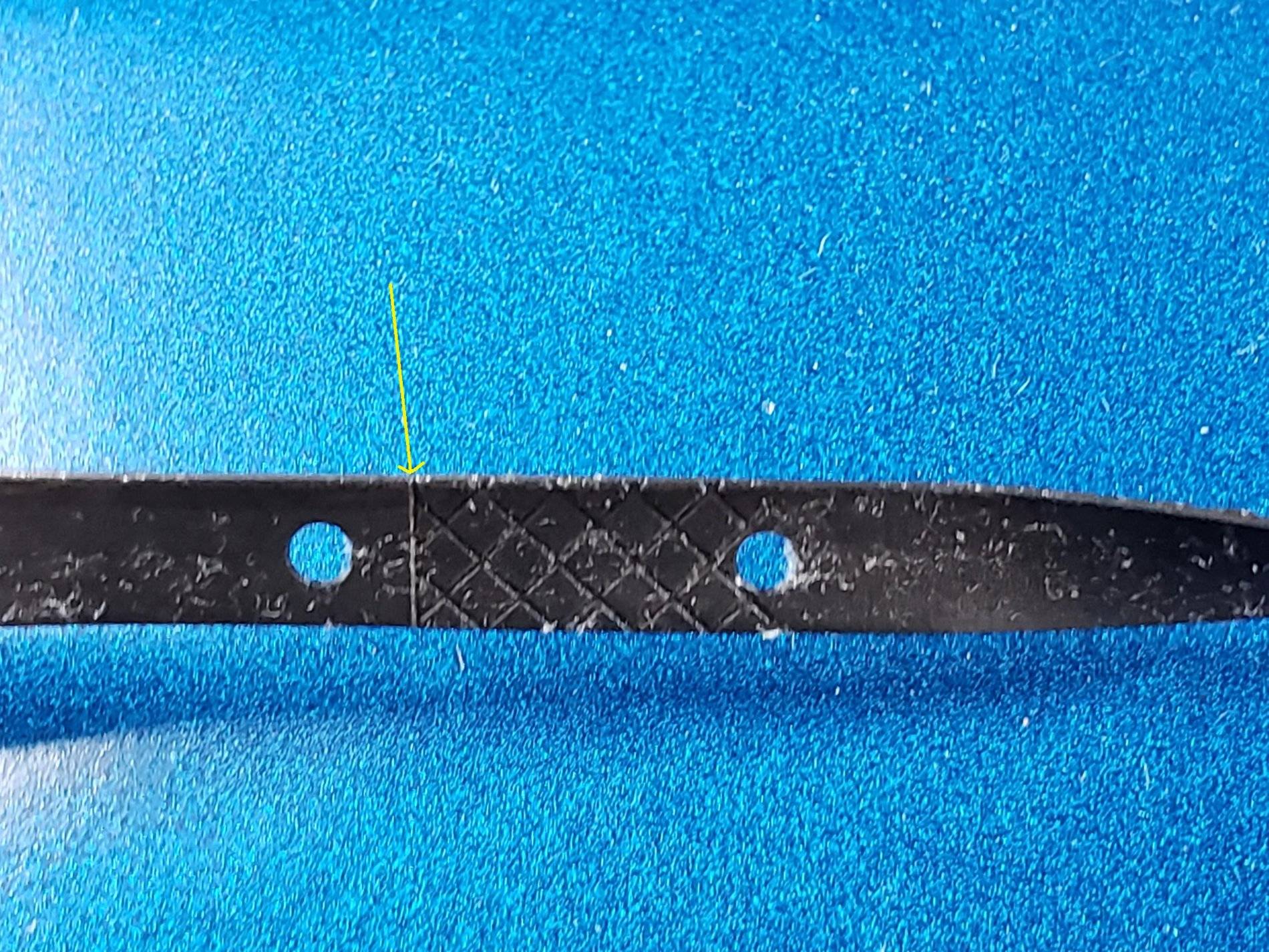

I prefer to check mine with the engine cold despite what the manual says as I have a hard time seeing it sometimes when its hot. OP make sure you take the reading on the side of the dipstick with hash marks on it to get an accurate reading. Also if you are going to check it cold like I do then the top of the hash marks is full in the cold condition whereas the top hole (left in the pic) is for when the oil is hot due to some expansion. Full cold should be where the yellow arrow is pointing in my attached pic. At the very least it may give you a better idea where you really are right now. it seems like you may be fine already.
I just checked mine cold and it is dead on where the arrow is my pic. Sorry for the crappy pic no my dipstick doesn't look like its all beat up in that pic LOL

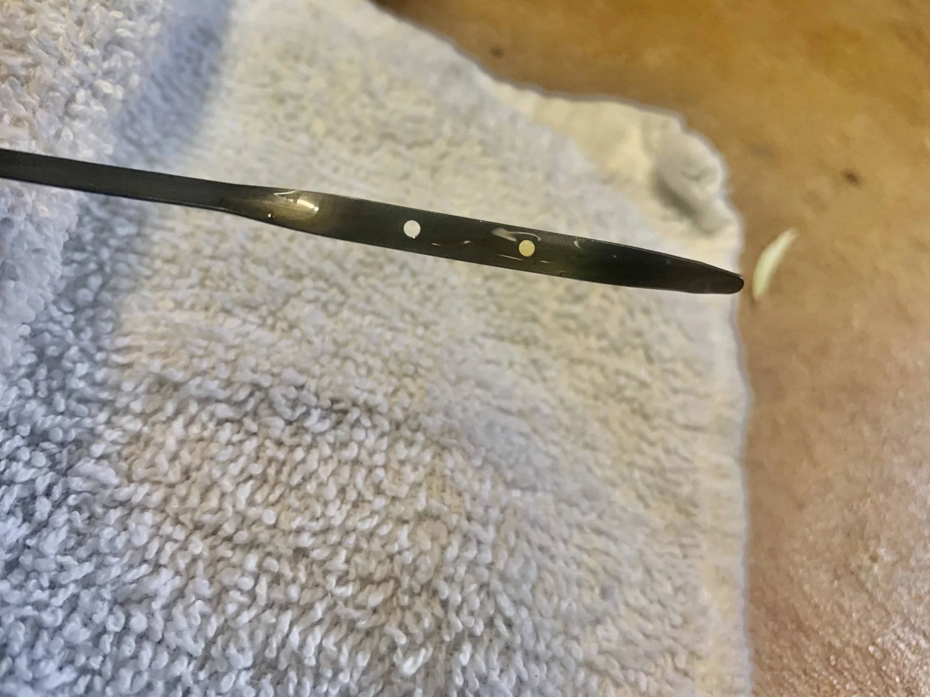

I took your advice and went for it. I can’t take a good picture to save my life but it’s well past the first hole and seeping towards to the top hole so I think it’s pretty decent!

Usually you can twist the stick while looking at it under a light and see exactly where your oil level is since you will get oil on the stick as you pull it in and out. Hence why its hard for us to tell exactly where it is with a picture
