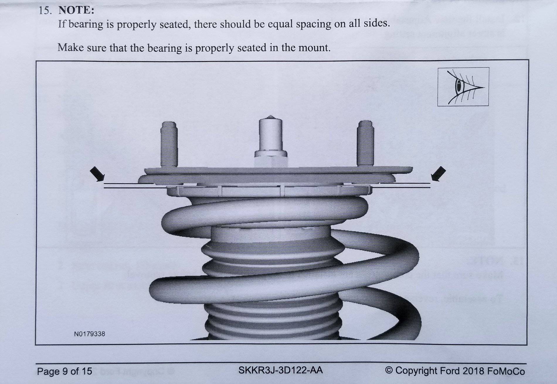

There are a couple of things to be wary of during the install. When the upper bearing is transferred to the adjustable plates (from the factory plates) you have to pay close attention to how the plates seat when placing them atop the spring and when you begin to tighten the strut nut. It is very easy to cock the assembly if you don't have the springs positioned/compressed properly. This will cause the assembly to bind and needs to be corrected immediately. This is pointed out in the instructions.

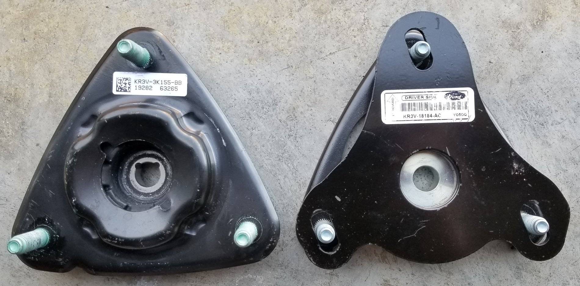

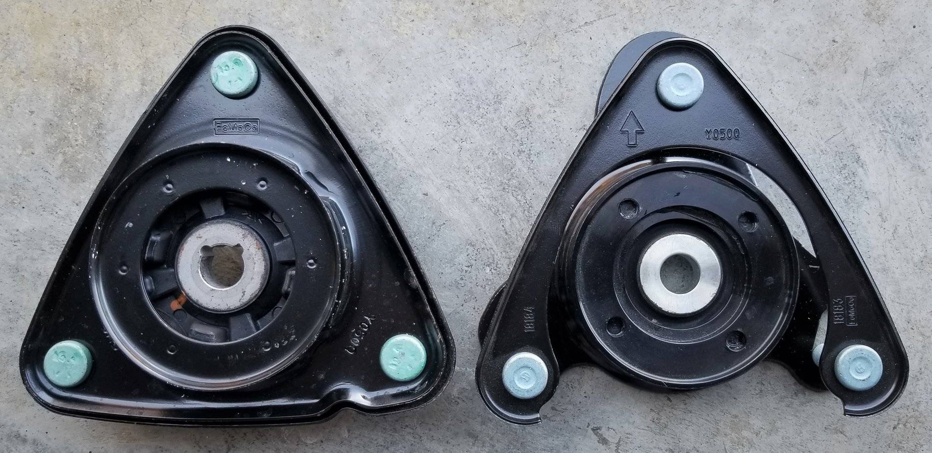

Factory original left, adjustable on right.
Before being installed or having the plates drawn together when torqued...
And while you can't really see it below, these plates are drawn together and tight as the nuts above are in place and torqued.
Could the knurls slightly hold up movement of the plates when the suspension is unloaded and the nuts are loosened? Yeah, to a minor degree. A whack, a thud, a gentle pry, and you are on your way. These aren't CNC machined 6061-T6 pieces with tightly controlled tolerances but they work just fine.
Was the Tech wrong to dress (I assume he used a file) the plates for additional clearance? Assuming the amount of material he removed was minor I don't see an issue as much as he really didn't need to do that. His logic is along the right track though.

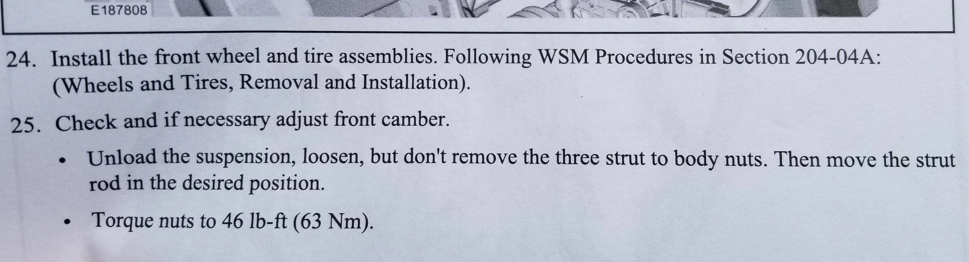

Step 25 from the installation instructions is about as clear as it gets. No, the system doesn't glide like its on silky smooth bearings when making camber adjustments. The strut plates can "stick" and seem like they don't want to move but they will.

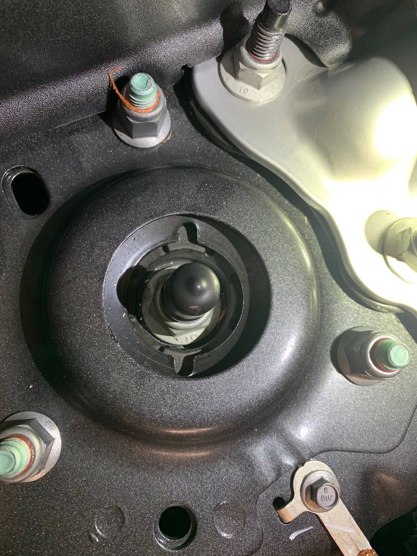

Quick question. Are there any visual cues that would confirm if my OEM camber plates were installed at my dealer?
svassh
svassh
Aug 14, 2019
40
438
406
Highland Village, TX
Scott
2014 Shelby GT500 Black with Red Stripes
Look down into the top of the strut from the engine bay. If you see the 2 slots on either side of the strut top nut as show here, they are NOT adjustable. To be clear they are standard on the GT350R. On GT350 you would need to have the handling package on your cars options.

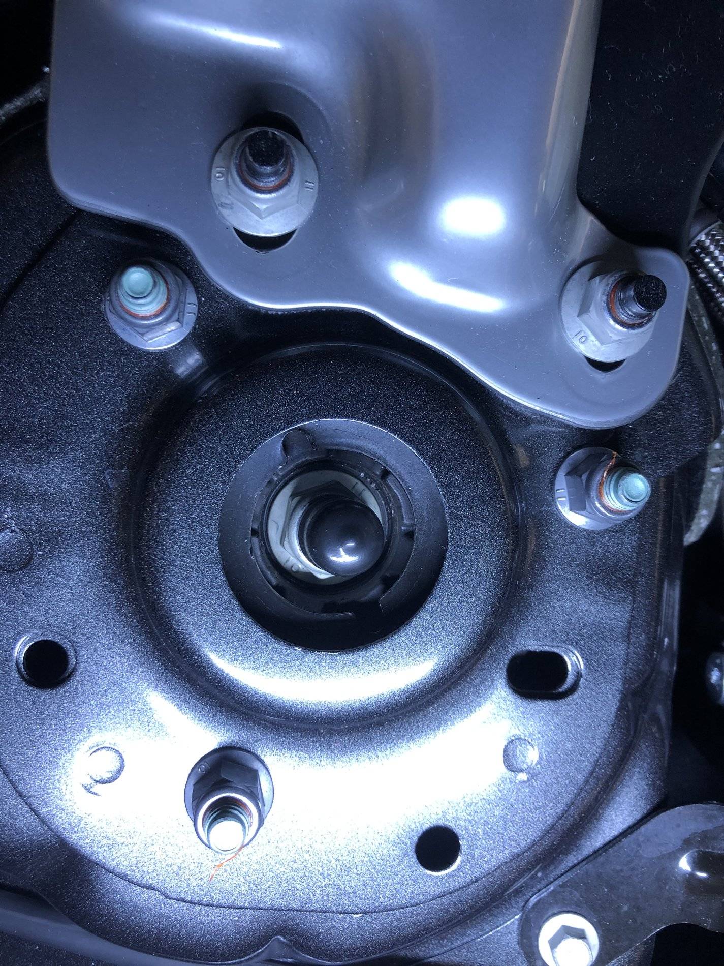

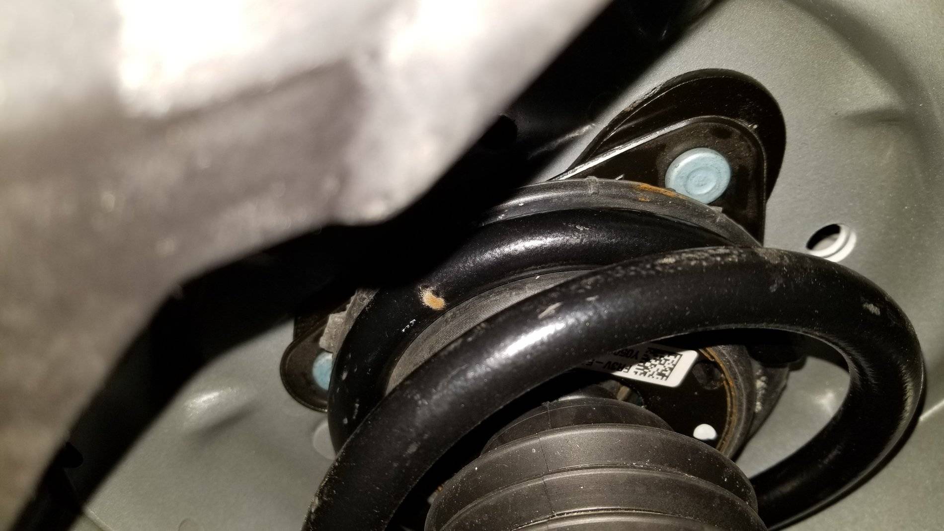

Here's a picture of mine. So no adjustable plates installed then? I do have the handling pack and my dealer said they were installed...

dealer is lying or more likely simply clueless. def not the adjustable strut tops. they prob don't even know what adjustable camber plates are and think that putting on the gurney flap was the extent of the install.
Nope. Those are the stock plates. Probably sitting in the Parts Department with your VIN on the package. That's where most of them are found.
