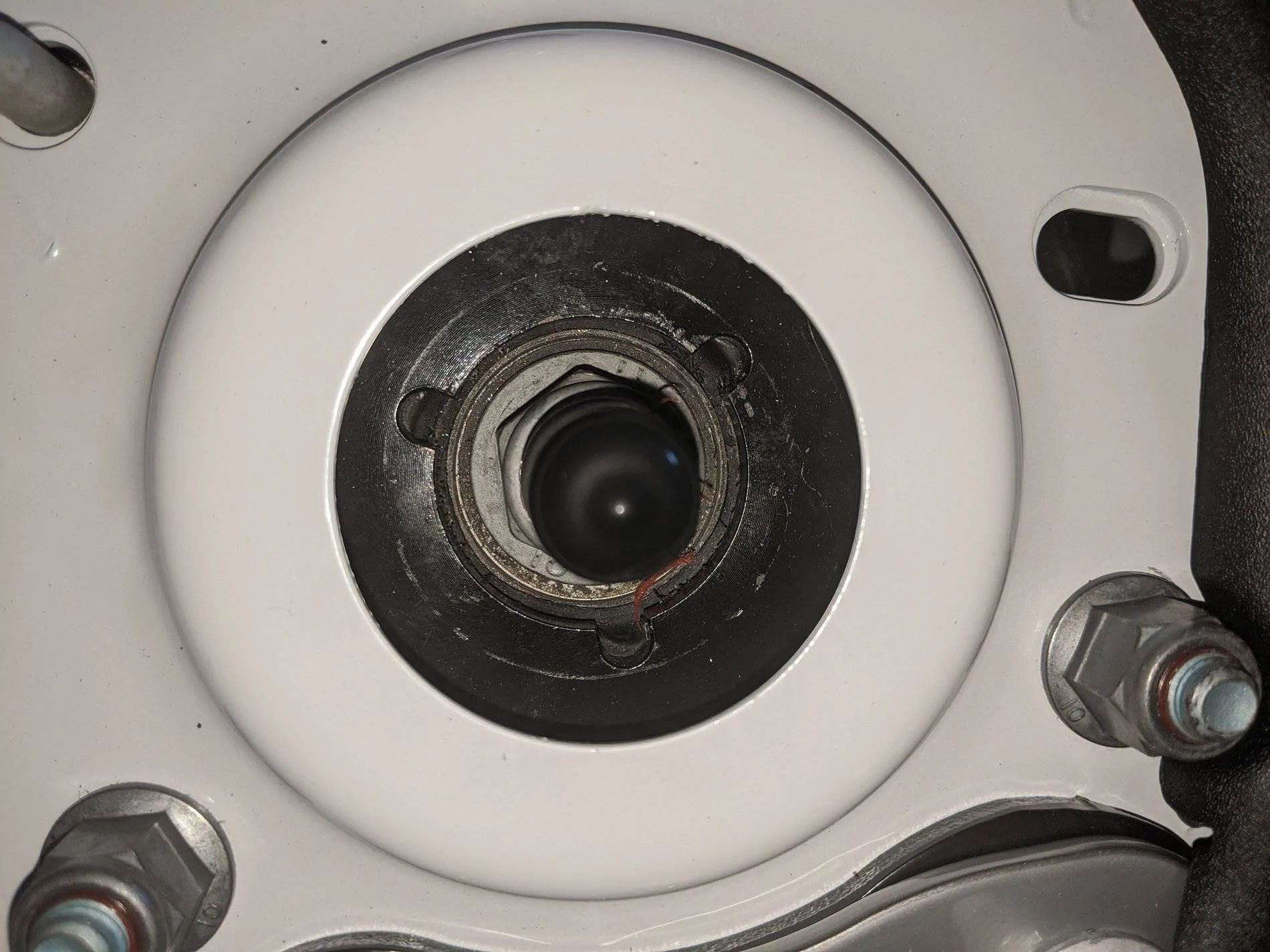

Just took delivery of a '20 GT350R from out of state. This plate has three slots. Is this adjustable or non-adjustable? What do the adjustable plates look like?

This is what it looks like.

Watch the above video, its really helpful.
Thanks. The video made it clear to me.
