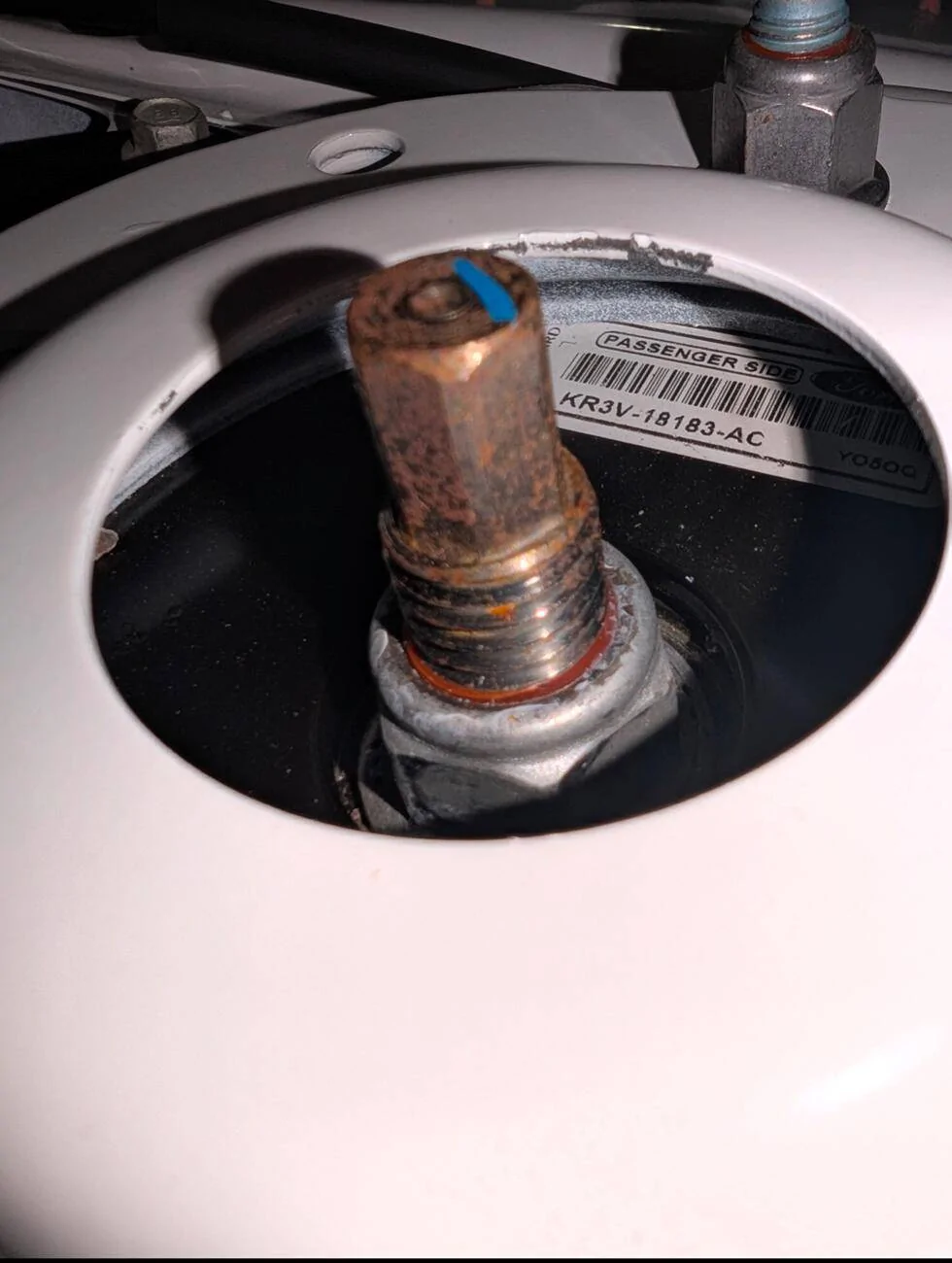

Great news everyone I have the ultimate solution....I went and double checked if in fact the original selling dealer put camber plates on the car...they did!!! I checked the driver side and this is what I found....no...no it can't be...@-#($)#
  • Angry
Reactions: GTP
DonPatr0L
DonPatr0L
May 16, 2023
48
39
Washington
2016 Ford Mustang GT PP1. 2019 GT350R
I found something on the track mustang group that actually says this is ok. The only change that happens is that it increases positive caster, which is a positive. So I guess I'll send it :)

I found something on the track mustang group that actually says this is ok. The only change that happens is that it increases positive camber, which is a positive. So I guess I'll send it :)
???? Since when positive camber is good??? Especially for handling
