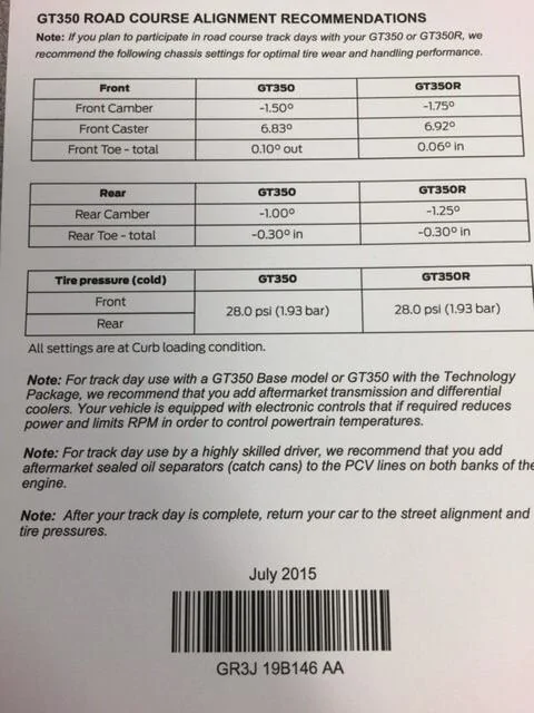

Anyone order Camber plates?
What type did you go with?
I have the R and need to get a set, looking for
opinion of best type for this car.
