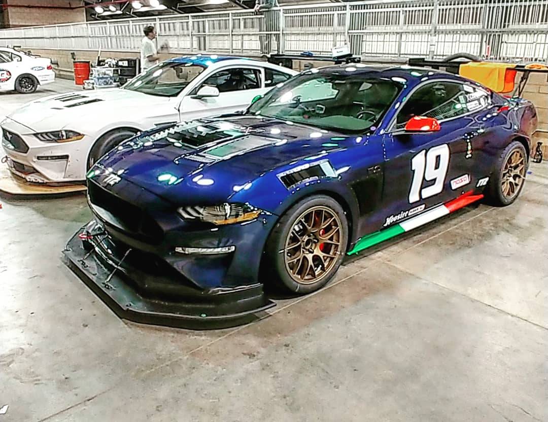

Alessandro
Mustang GT 18 10speed auto PP1 , GT500 '21
My kishi oil coller lower grille
My trans cooler for 10speed up (setrab 934)
If you position the oil cooler flat be sure you have an exit umder in the splitter panel.
