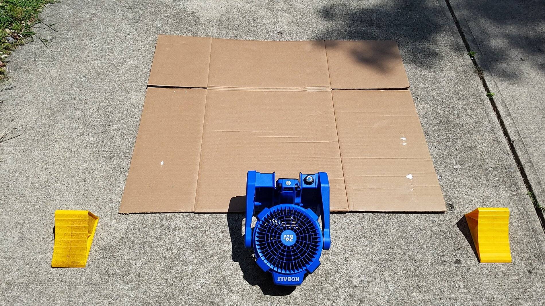

Today I made a cardboard template to help position my fan to the wheel chocks. There is a 3" deep notch in the edge to locate the fan. I want the chocks and fan on the ground for max clearance and so that they don't shift when backing up.
The diffuser just clears the fan when backing up.
The cardboard folds up and goes in the trunk for track day.
Nice idea but that does not look like the misting fan. My fan is made to sit on top of a bucket of water to provide the mist. It can also be hooked to a hose but those aren't always available at the track. My fan appears to have a larger base. I've been trying to think of ways to provide a water source without having it sitting on top of a bucket when I can't access a hose. I'm thinking about about backing up on my trailer ramps stopping just so the diff is in the open air between the ramps and using wheel chocks on the front tires to hold me there. Will require some help from someone else. The addition of water to the air flow is supposed to cool better. So I'm still working that out. Using my sprayer with just water and a source of air might work out better and could possibly be done with the car on the ground.

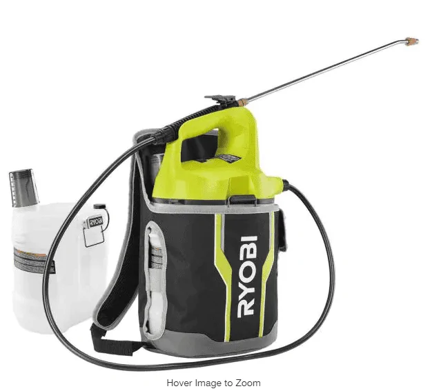

That's what I have. @Flyhalf This is battery powered as well so it could run on it's own spraying water. With the hose taped to a wheel chock or something to aim it at the diff. Then use another wheel chock to aim blower at the diff. Could let this run together for 5 mins, 10 mins... however long the tank of water or batteries last. That's a limiter here if you need to bring a bunch of batteries. Luckily at one track I visit regularly I have access to charge batteries.

Tie the nozzle of the sprayer on the leaf blower, then tie a ziptie on the trigger. That way the stream of water gets sprayed directly into the path of the forced air and you don't have to lay on the ground trying to pour water under your car. Just sit back and relax.
Based on my experience from using the Ryobi unit to spray weeds, a normal sized battery can do about 20 gallons of liquid which is an hour or two of operation. I go thru a gallon in about 8-10 minutes of constant spraying. You can also get a non name-brand extended battery for cheap and it can last more than twice that. Should be enough to last you a whole day on one battery.
Good ideas. That was my goal was figuring out how to do it without a lot of extra effort on my part.
