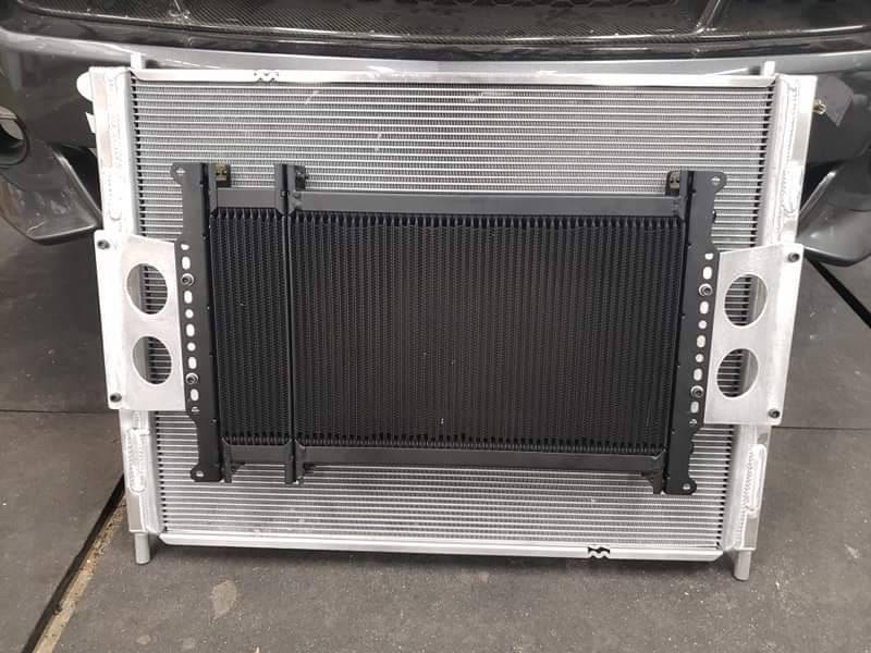

i plumbed in a setrab 610 unit (along with a 650 for oil cooling) in front of a 3" radiator (and behind a 3" heat exchanger) w/ the same tilton pump:
wasn't sure it would get sufficient airflow, but made sure to fence/duct everything in, and still haven't seen temps above 200 (and IAT/CHTs are great too). others have done a diff-like solution (fan/cooler under the passenger side), or place the radiator where the fog light is - but i didn't like the low pressure air flow there (and the lack of protection from a debris/wall hit).
side note for the tilton pump: the one in the FTBR kit is for intermittent use (1-2 hours, w/ 15 min cool down). be sure you set the thermostat high enough to not activate on the street, otherwise you'll burn the pump out fast. there is a continuous use version for up to 1000 hours (40-527), but doesn't have viton seals.
