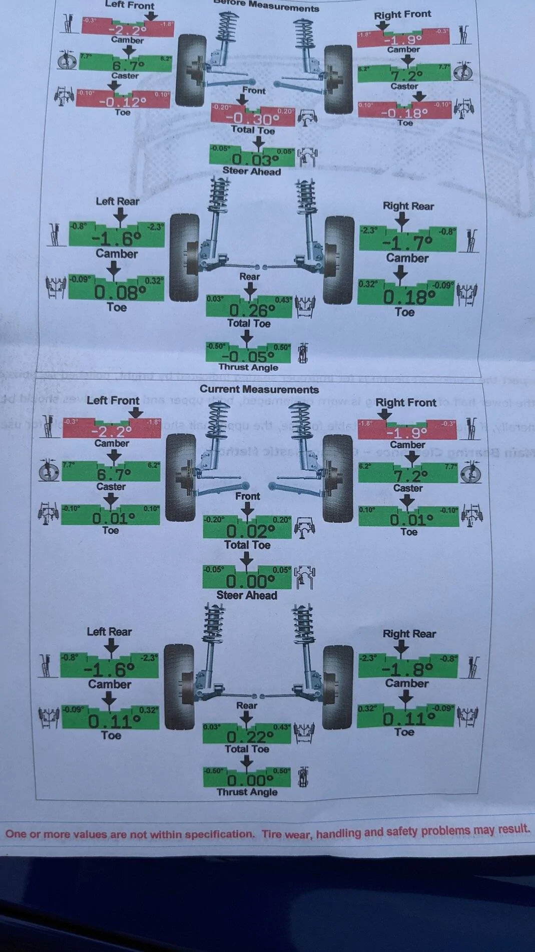

But now something else has come up, I got a set of Steeda camber bolts installed so I can adjust around -2.5 degrees of camber in the front. However, the shop I brought it to said they could only get to -2.2 degrees of camber on the left front and -1.9 on the right front, with the caster dipping heavily when they tried to get any more camber.
The mechanic mentioned that the cam was too small to really get more camber out of them, I think he was referring to the cam lobe. He also mentioned that the brembo brakes got in the way of the nut, making adjusting hard. Anyone else have that issue? My current set up is;

Those camber bolts are not great compared to camber plates. You’ll get what you can get.
Normally I’ll remove the brakes and rotors (just two bolts) when dealing with those strut bolts because ya the calipers get in the way, but it sounds like he got what he could get from them.

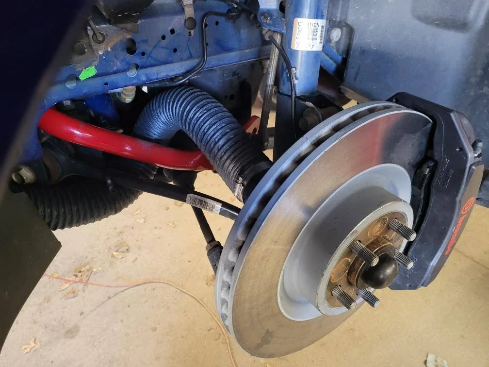

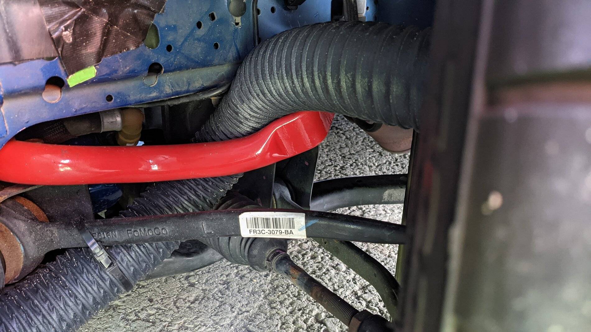

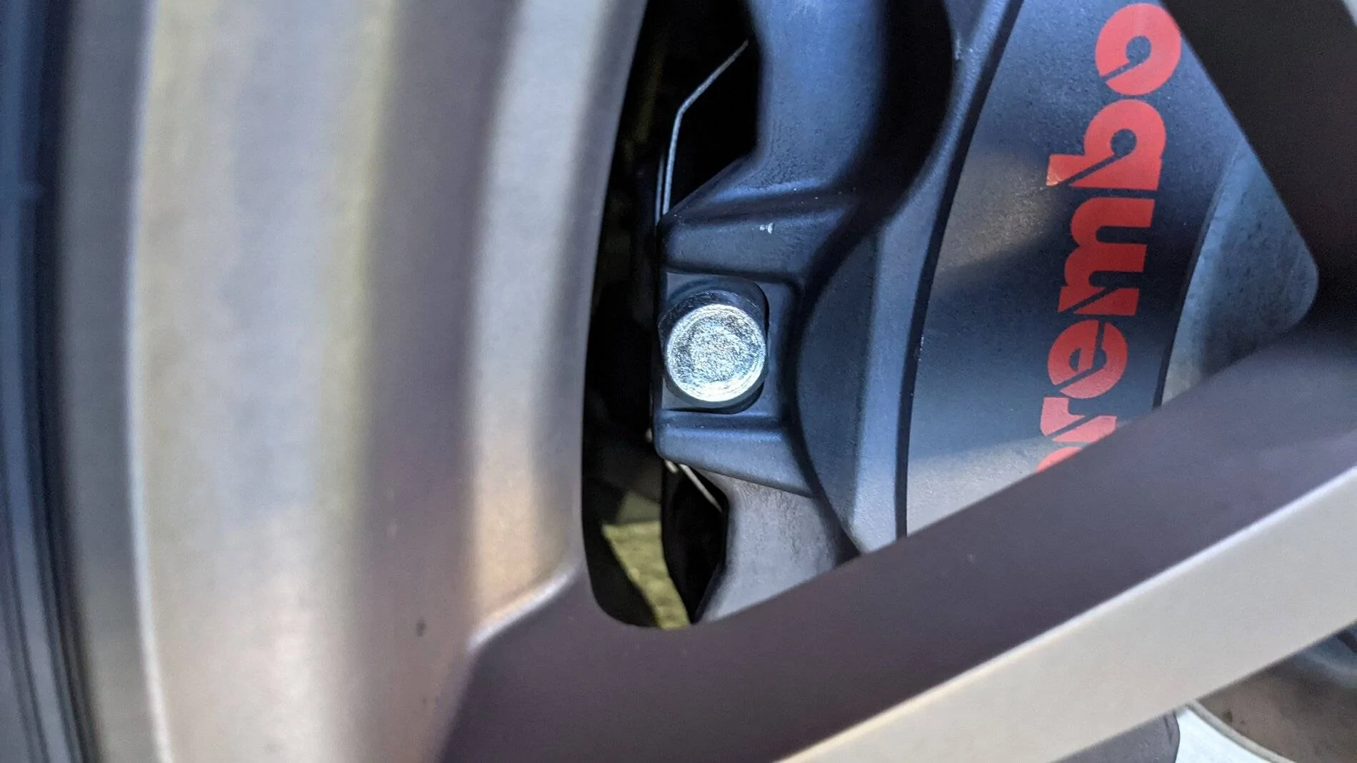

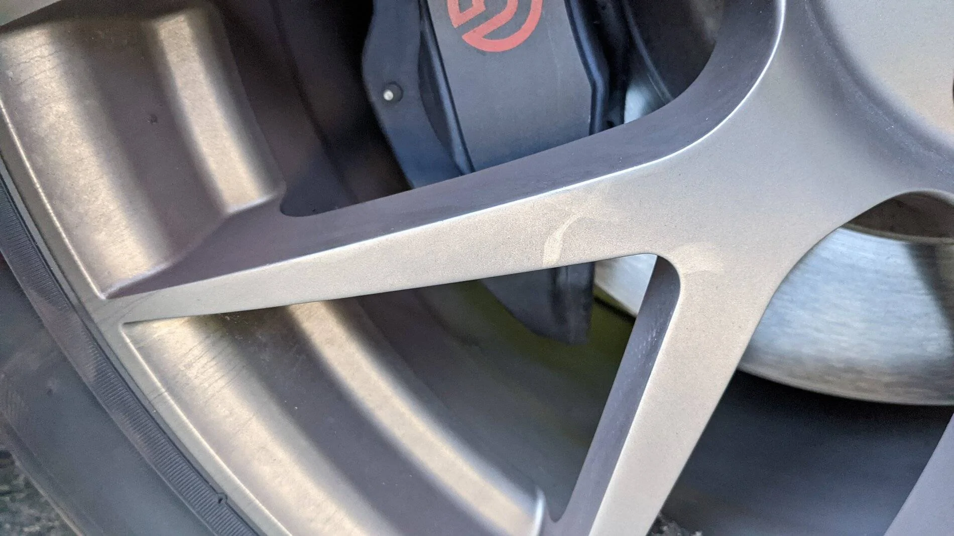

On full lock, I'm hearing a distinct "clunk" from the front. Not sure what it could be, possibly the new brakes are hitting something?
shogun32
Feb 8, 2019
92
16,223
14,019
Northern VA
check your wheel barrel. But no, it's probably the spring 'setting' itself when being twisted instead of properly rotating.
You may need to put the bar link on the inside of the bar OR move the link to the front side of the strut. It may be hitting the strut body.
