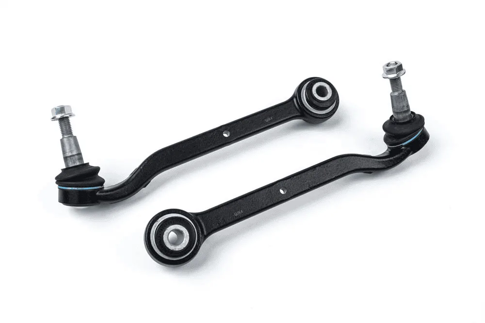

Since you live in a place that sees winter conditions, doesn't surprise me. My Steeda bumpsteer kit is rusted to hell. I am replacing it with J&M this week when I do coilovers.
This the J&M kit? It does look nice, if it turns out both sides of the Steeda kit are toast then I'll also do the upgrade, but if it is just the one side that's worn out, I'll just get a replacement from Steeda for $60 and hopefully it lasts another 3 years.
The spherical bearing you can buy for the front control arms: Steeda, J&M, Cortex, etc. - those are for the tension links. The roll center correction arms that Steeda sells are the lateral links. Yes, for me, the bearings in the tension links are worth it to me for the direct steering response they give. And there is no more lag or dead zone in the steering. There is a little NVH with these bearings but worth it for me personally. Your opinion may vary.

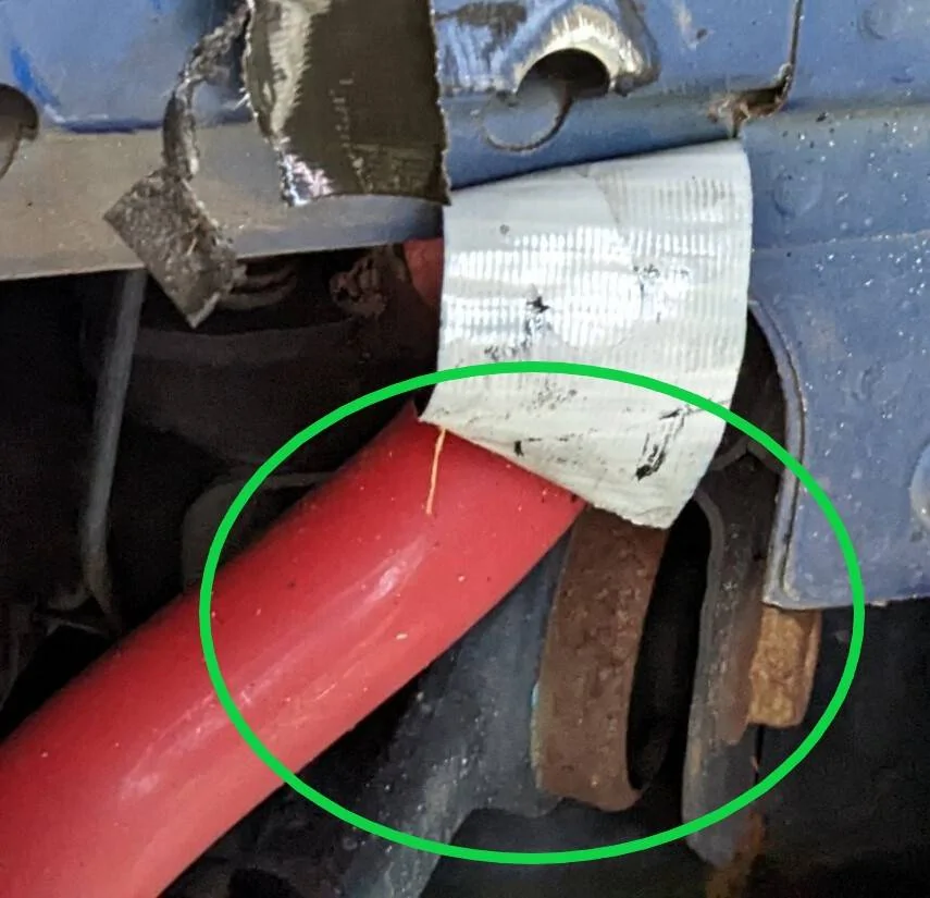

But looking at this old pic, I think that's the tension link bushing with all that rust, which I haven't replaced, and in that case, it'll have been on the car for 61k miles/~8 years.
That would probably be far more reasonable for it to be failing, and in that case is there any substantial difference in quality between Cortex/Steeda/J&M? Or is the quality typically the same.

Actually building off of this, the tension links I have are stock GT ones, without the brake deflector, would any of the aftermarket bushings/bearings fit? I've heard that PP LCAs have a different bushing, but unsure if the diameter is different or if it's just the material. Would it be better to just buy a set of PP tension link control arms with bearings fitted?
The arms should be the same. The base GT ones just don't have the brake air deflectors. The bearings simply get pressed in. I like these personally.
https://hotpart.com/product/2015-20...r-front-control-arm-spherical-caster-bushing/
The Cortex and Steeda ones should also fit.

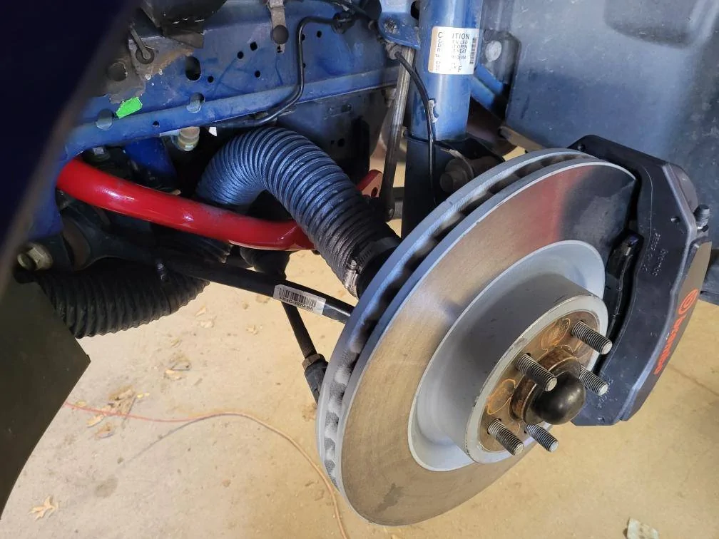

Was able to get under the car, and yeah it wasn't fantastic. Lots of rust on the outer tie rod and a bit of movement in the bushings on both sides. They suggested just replacing the outer tie rods on both sides, since while it didn't have the movement it still looked pretty rusted.
So now I'm just left at the crossroads of polyurethane versus spherical. Honestly, given this car sees far far far far far far faaaaaaaaaaaaaaaar more street miles than track ones, and winters and New England potholes, I'm actually leaning more towards the poly bushings, since people talk about the bearings as wearing down a lot and being tended towards 'racecar' only.
