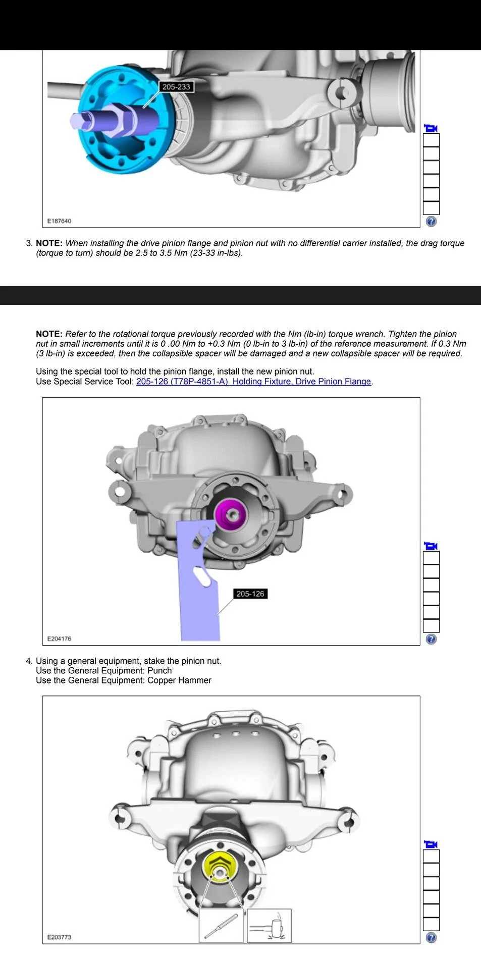

I have no idea if they did the job properly or not. I was just putting out the correct procedure.
Sometimes crap happens.
True, I'm jut worried since this is my daily, and on top of this if the mistake is on their end, I don't want to be the one literally paying for it to be fixed, y'know?
If it didn't whine before the pinion swap, it's on them.
