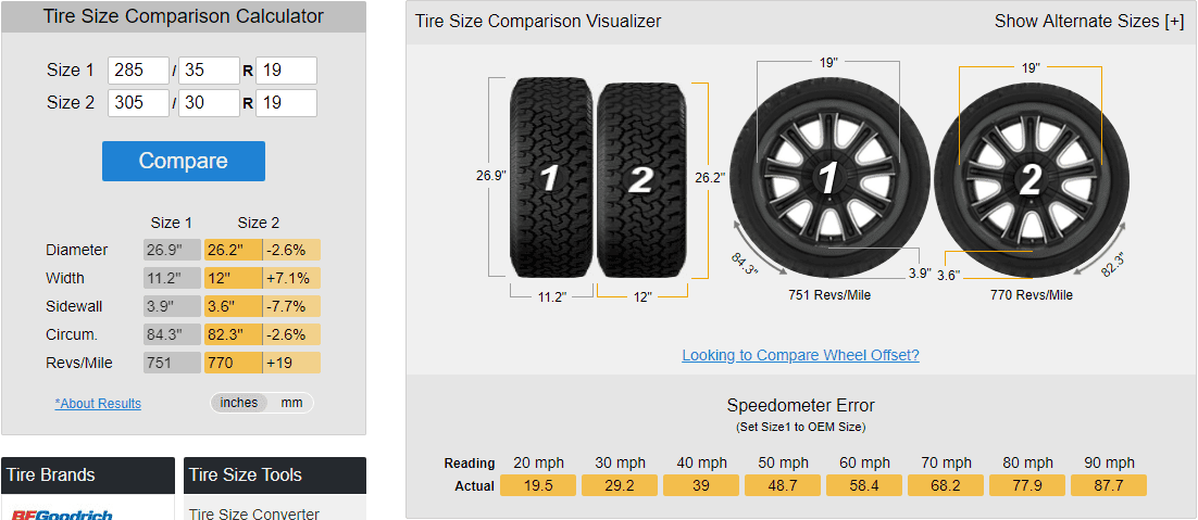

Also, this might be just me not understanding how cars are designed, but most tire set ups I've seen tend to have a larger overall front than the rear, sometimes by over half a inch. Is this normal? I know the lowering springs will effect the front more than the rear, but still this seems not intuitive to me.

Sorry, here's a visual. Tire 1 has the set up you suggested, 285/35R19 compared to Tire 2 305/30R19, would this not be accurate to how the actual setup would look?

If you can get a 305/35R19 that'd be even better. Not many in that size though. Michelin has the PSS which is amazing. I agree you'd normally want equal diameter front and rear or rear slightly larger.
I'm used to talking track tires and 305/30r19 is a very typical size :).

Yeah, the Pilot Super Sport seems a bit on the extreme side haha. Also, doesn't look like it's available in 285/35R19. So the Goldilocks predicament continues.
I've been able to find more tires that are 285/30R19 & 305/30R19 than 285/35R19 & 305/35R19. Would there be issues running a 285/30R19 on the front? Only issue I can see is it might be less comfortable.
