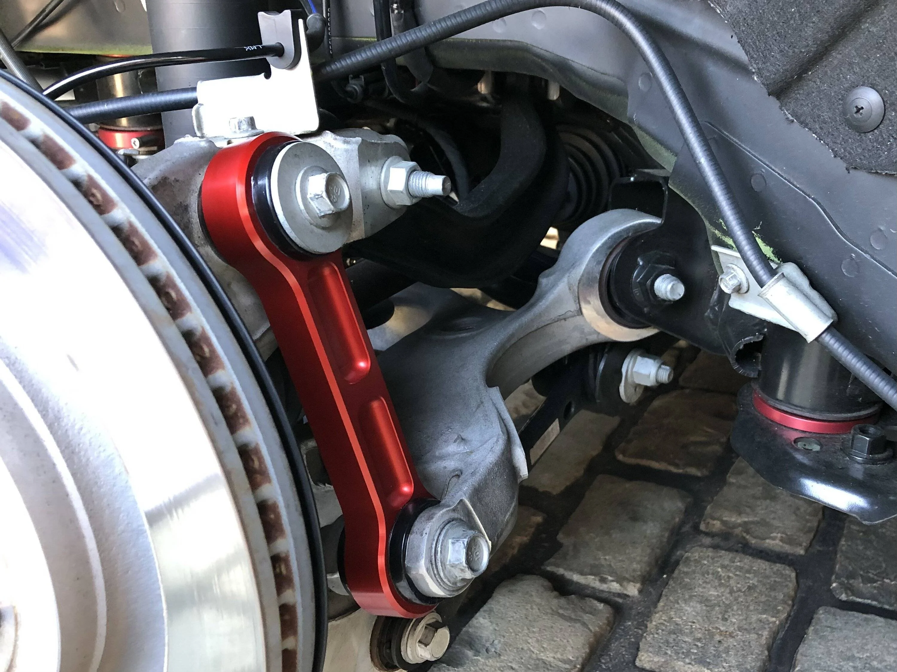

The PP cars come standard with a spherical on the lateral link. Maybe they wouldn't live as long on the tension link, but I'd guess you could get 15 or 20k out of them at bare minimum.
Huh, didn't know that. I thought it was just a standard rubber bushing across all the lateral links.
Note that although its a spherical, it's a rubber booted spherical :
i.e. it's not 100% comparable to a typical aftermarket 'open' spherical if environmental factors are a consideration :like:
WD :like:
WD :like:
I've wanted to mention that - same thing in the rear - Ford spherical bearing have rubber protection unlike anything aftermarket which is just exposed bearing.

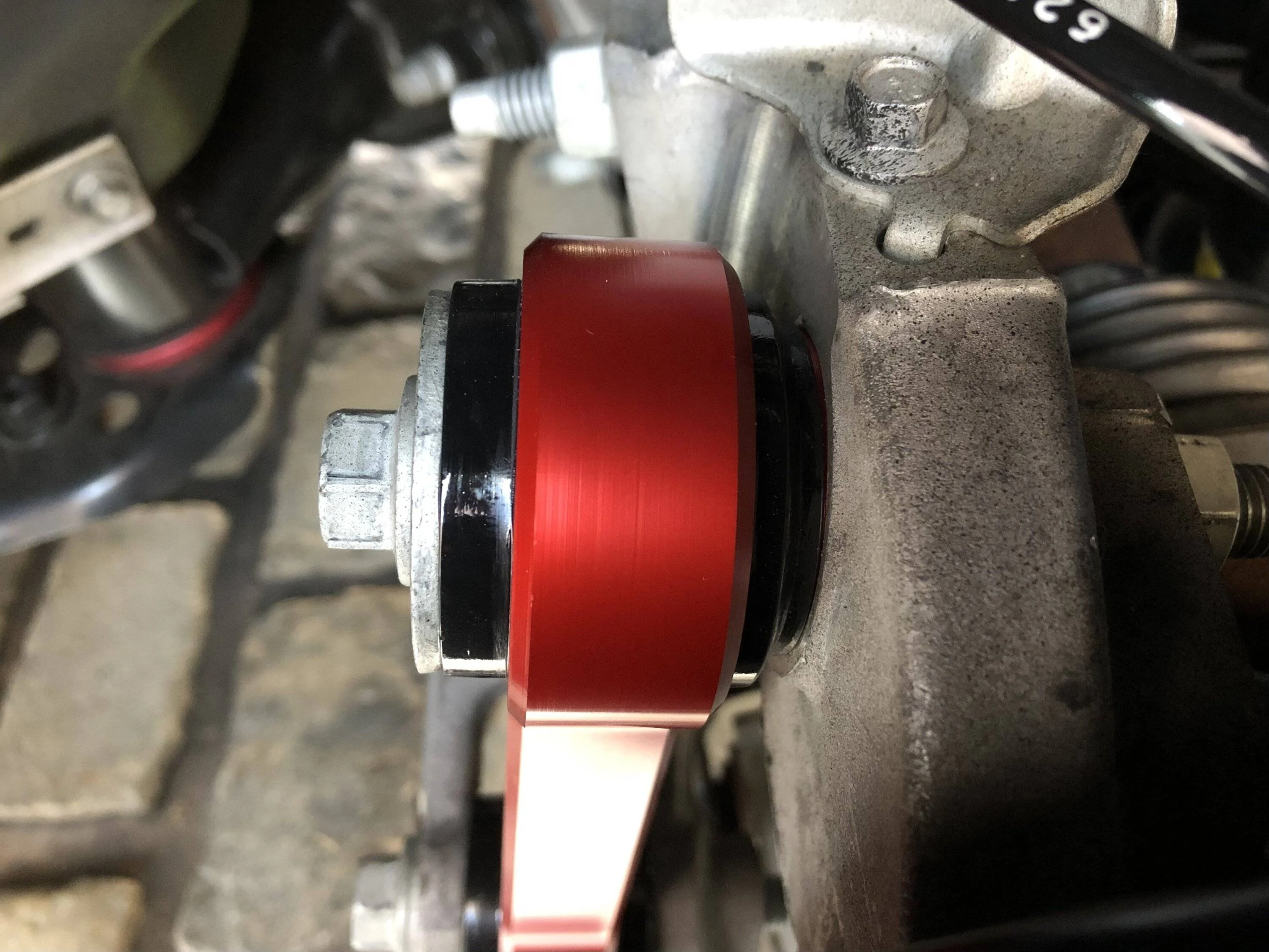

Not quite, look what J&M did after a little nudge :
WD :like:
Edit for spelling ...

Ohhhhh! Interesting, that could explain why mine are worn out; toughened up suspension means they got hammered out of shape.
WD :like:
Wow, those are pretty! And that's a good feature, maybe they can develop something similar for their caster bearing as well. (not sure when my vertical links are getting upgraded, but it's definitely on the list)
