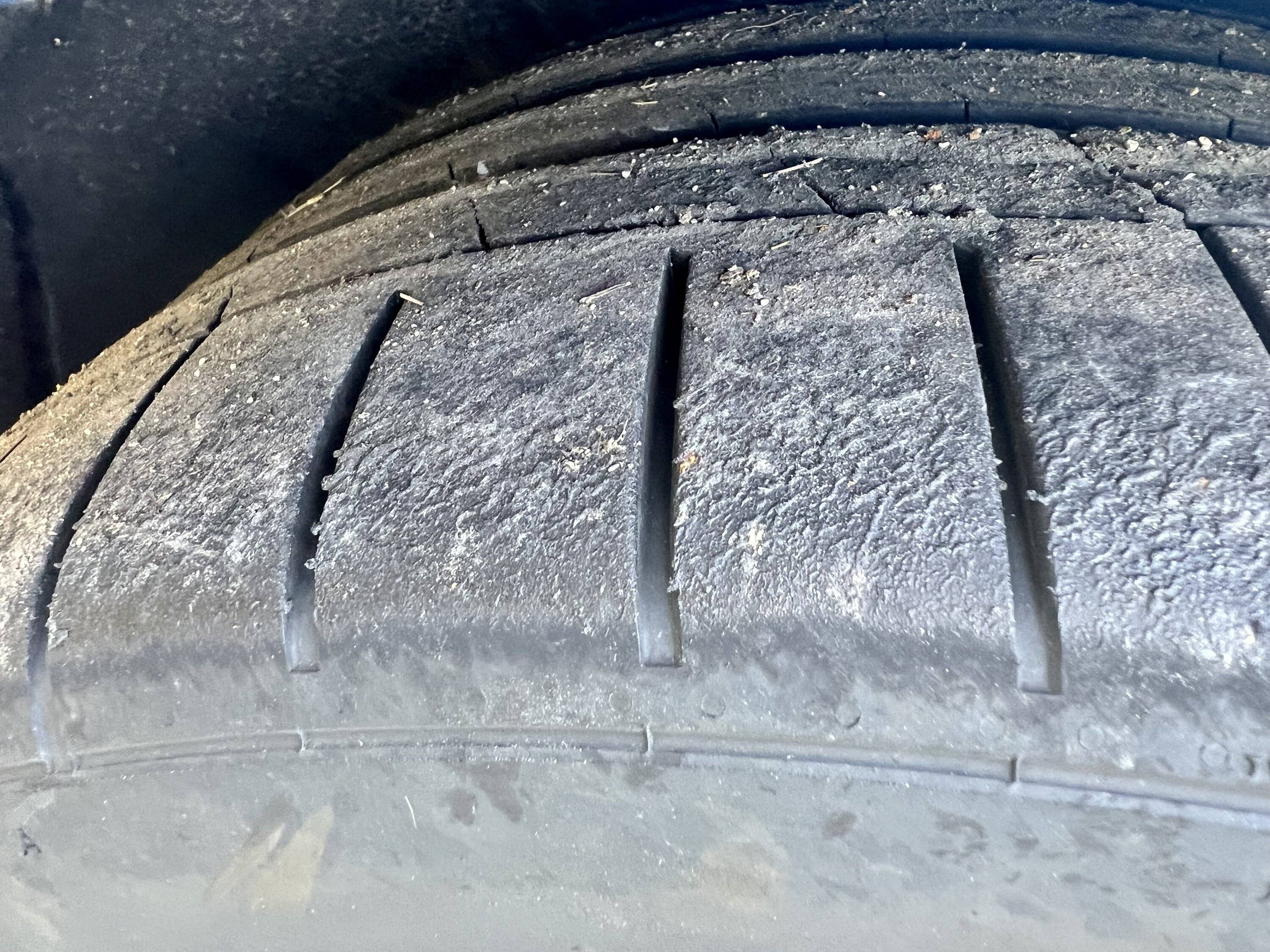

And nice! I wonder how my SC3s held up, it's hard to tell exactly what's from my tire and what is from the track

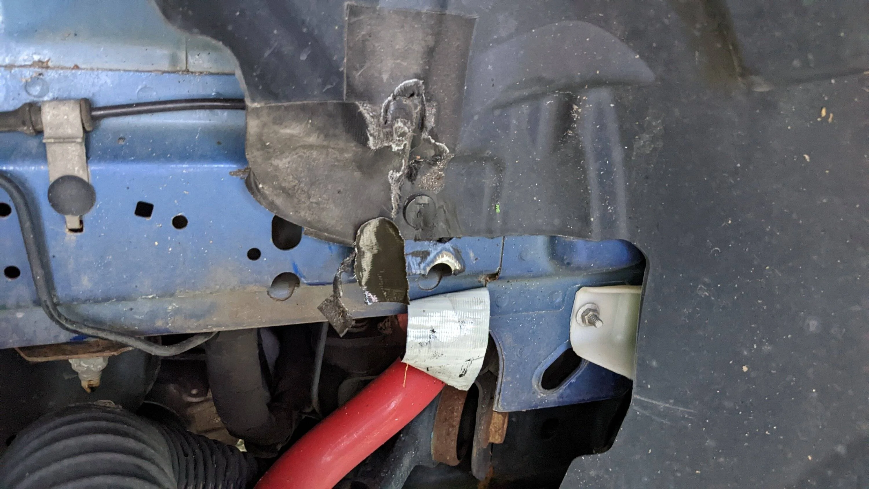

The rubbing I spotted when I first put on my SVE wheels has burnished the paint off the chassis on the front passenger side wheel well. Similar issue on the driver side, but nowhere near as bad.
Wondering if anyone else has had this happen and if the solution is a 5mm spacer + extended wheel studs. I already have the spacer from when this happened last time with the splash guard. I doubt metal on rubber contact can simply be ignored.
