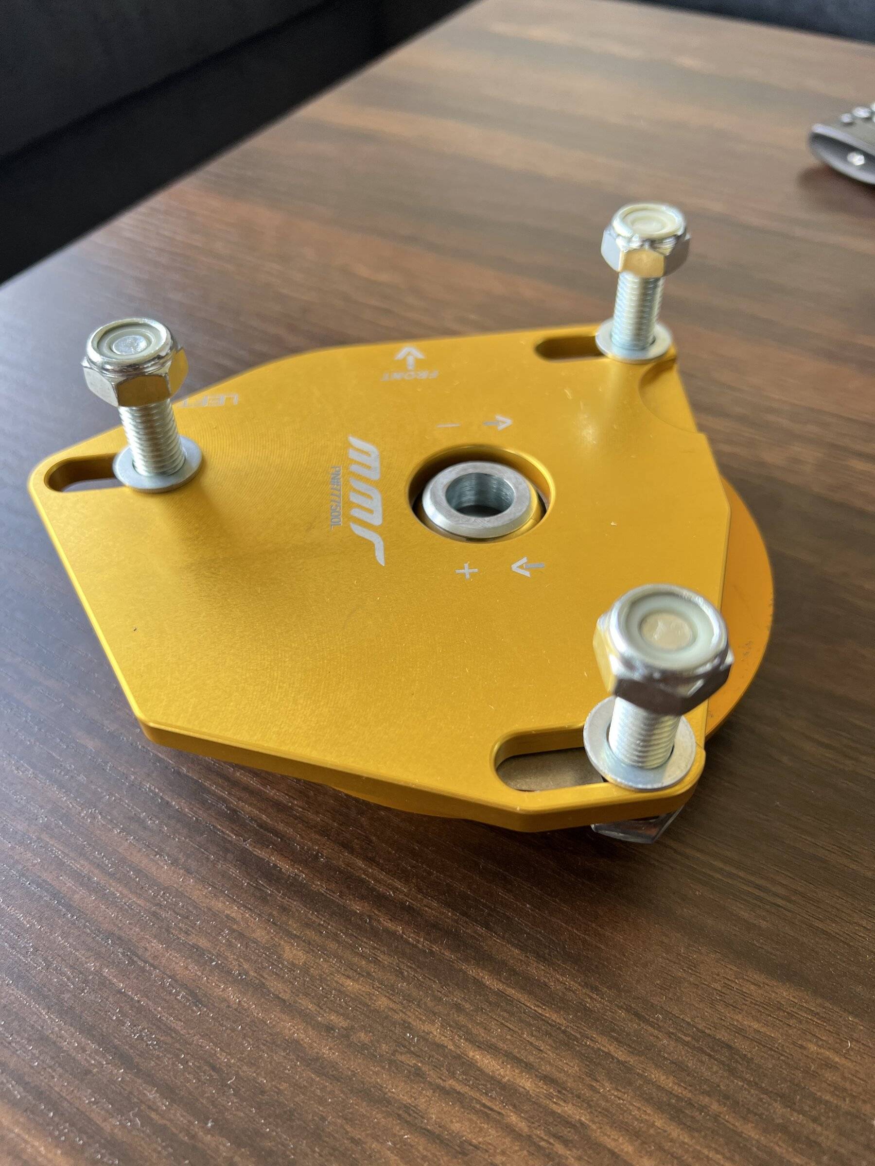

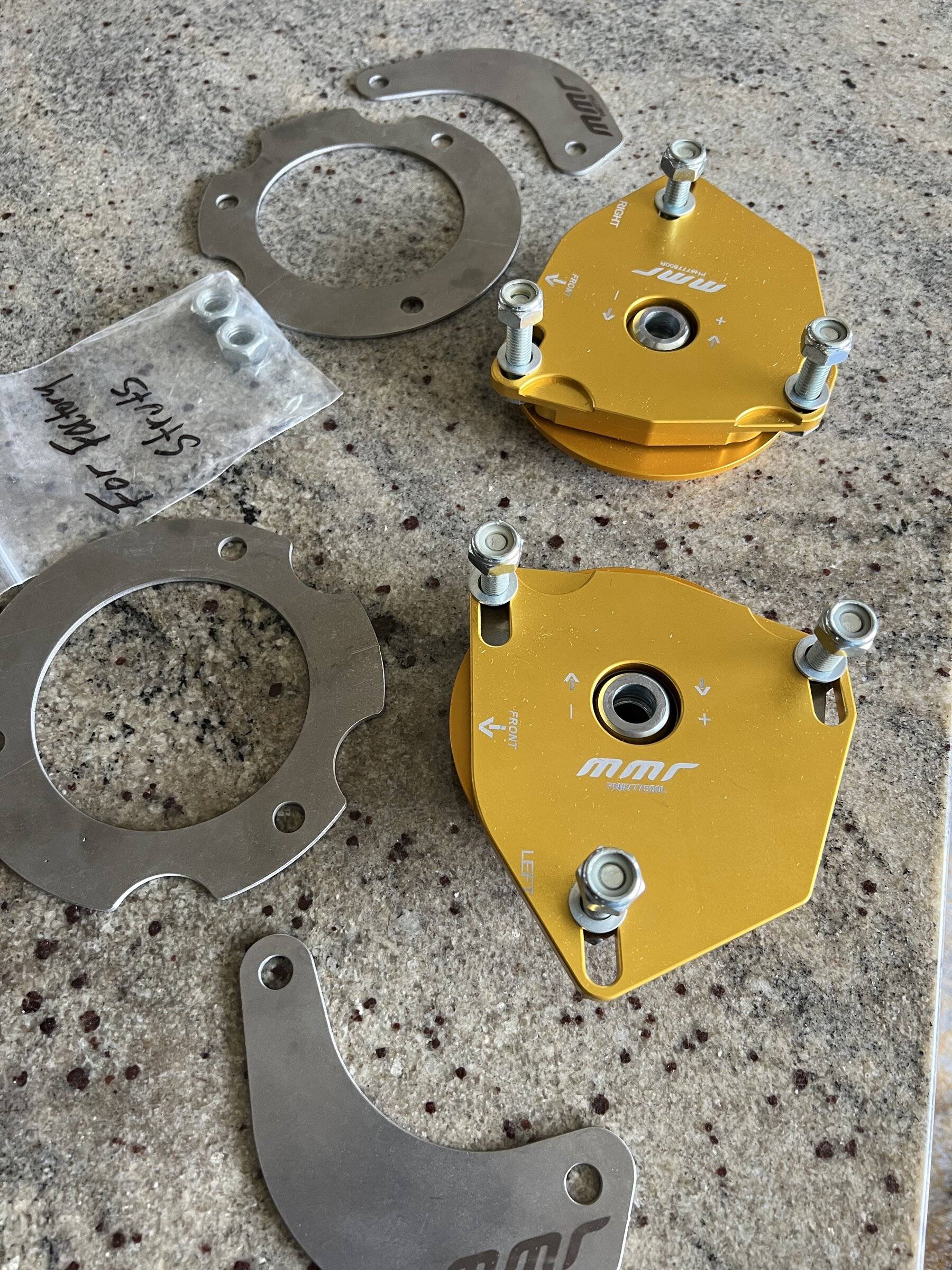

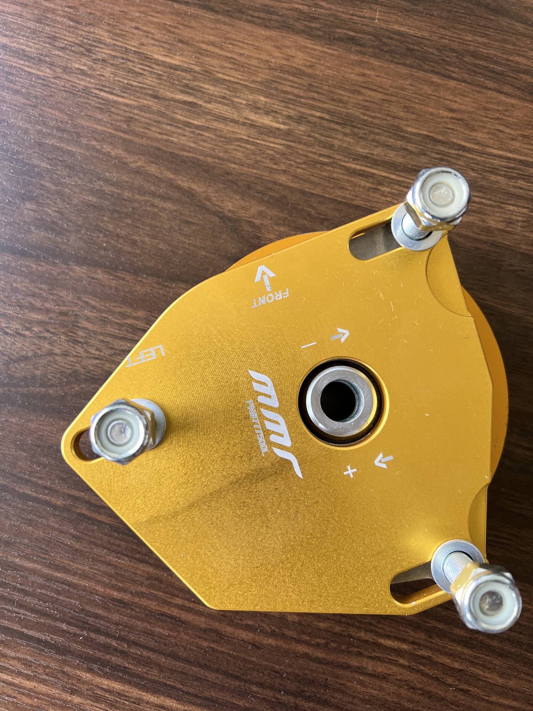

I just ordered a set of MMRs which came in last week. Looks to be quality and more camber than MM plates. Well priced too
Those do look super nice, any idea of any issues with installing with the Track Shock & Strut Kit? (Ford # M-18000-F)

shouldn’t be any issues being that they are OEM style dampers but it’ll be some time before I know because I just had to drop the car off at the dealership for work
