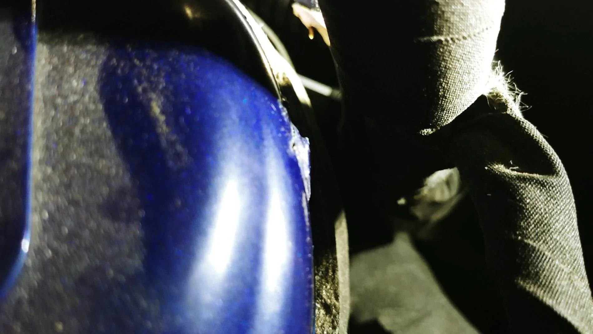

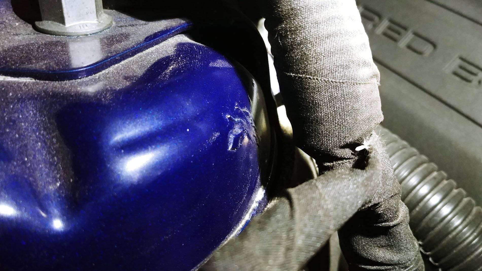

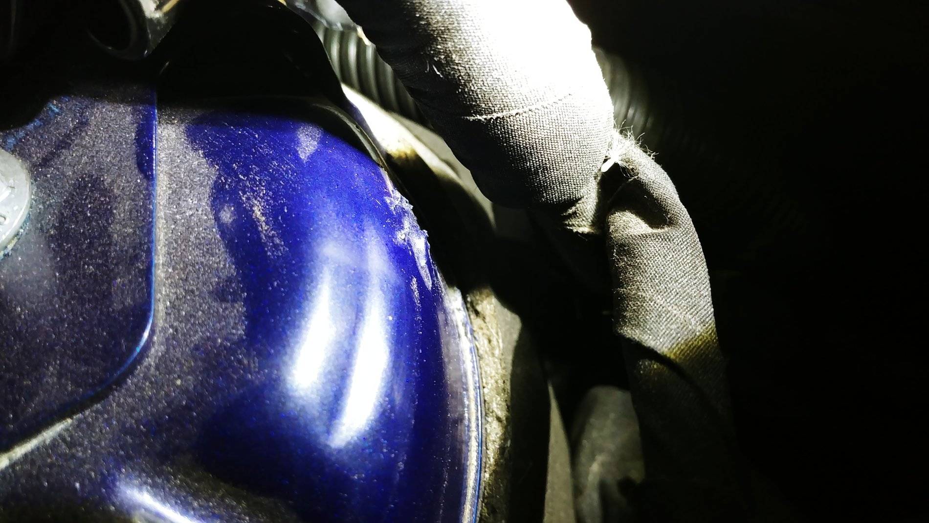

I did have a extremely loud scraping noise happen when I was pulling out of my driveway to get groceries. But as soon as I stopped the car, the noise stopped and didn't come back when I set off again. No obvious fluid leaks, either before or after, nor did the mustang do anything strange. My guess is that a pebble got caught between a brake rotor and a shield.
I did notice this large scratch on the passenger side shock tower. Not present on the driver side. Doesn't seem to have pierced through, but is this a issue that I should be concerned about?
