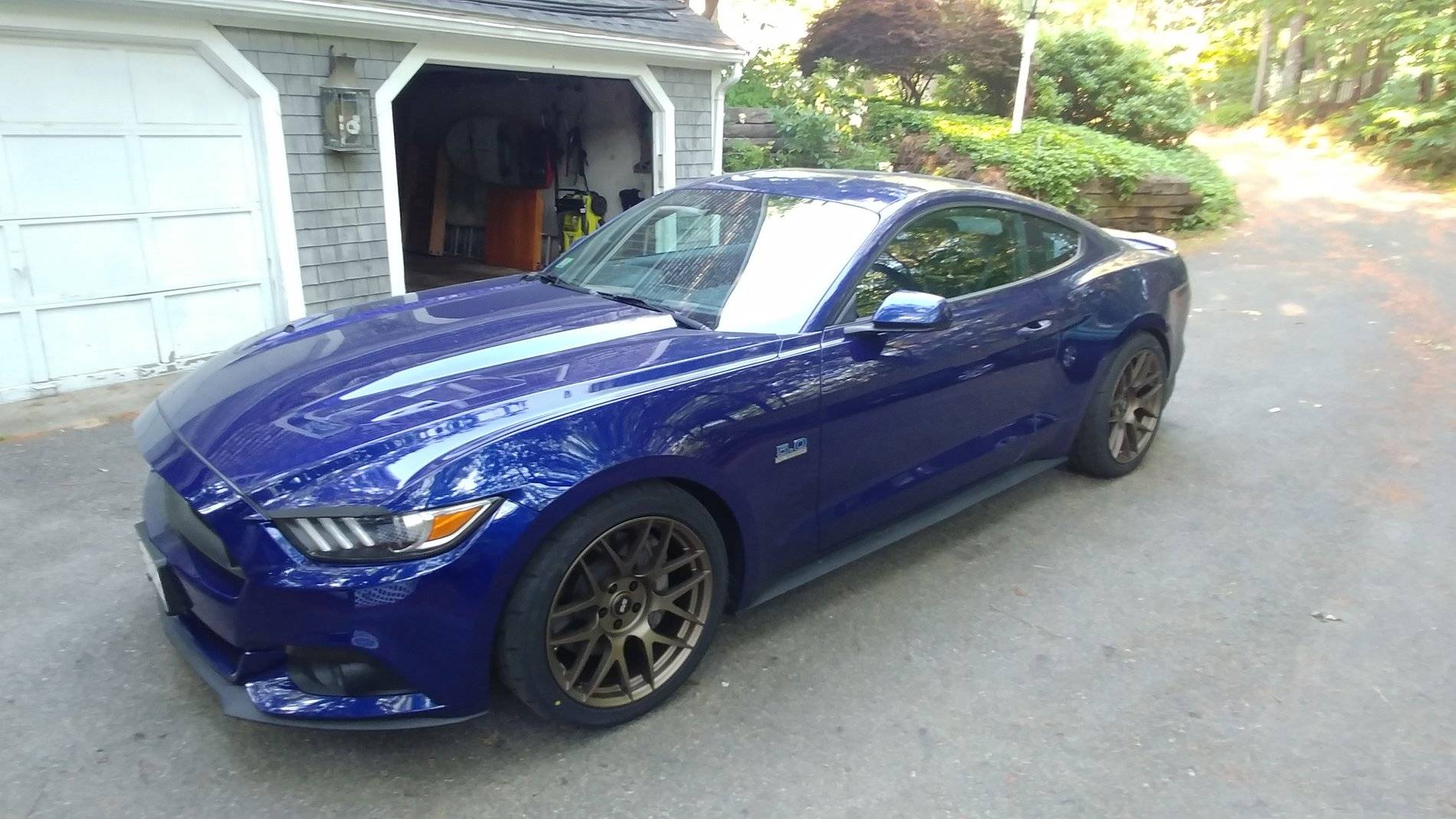

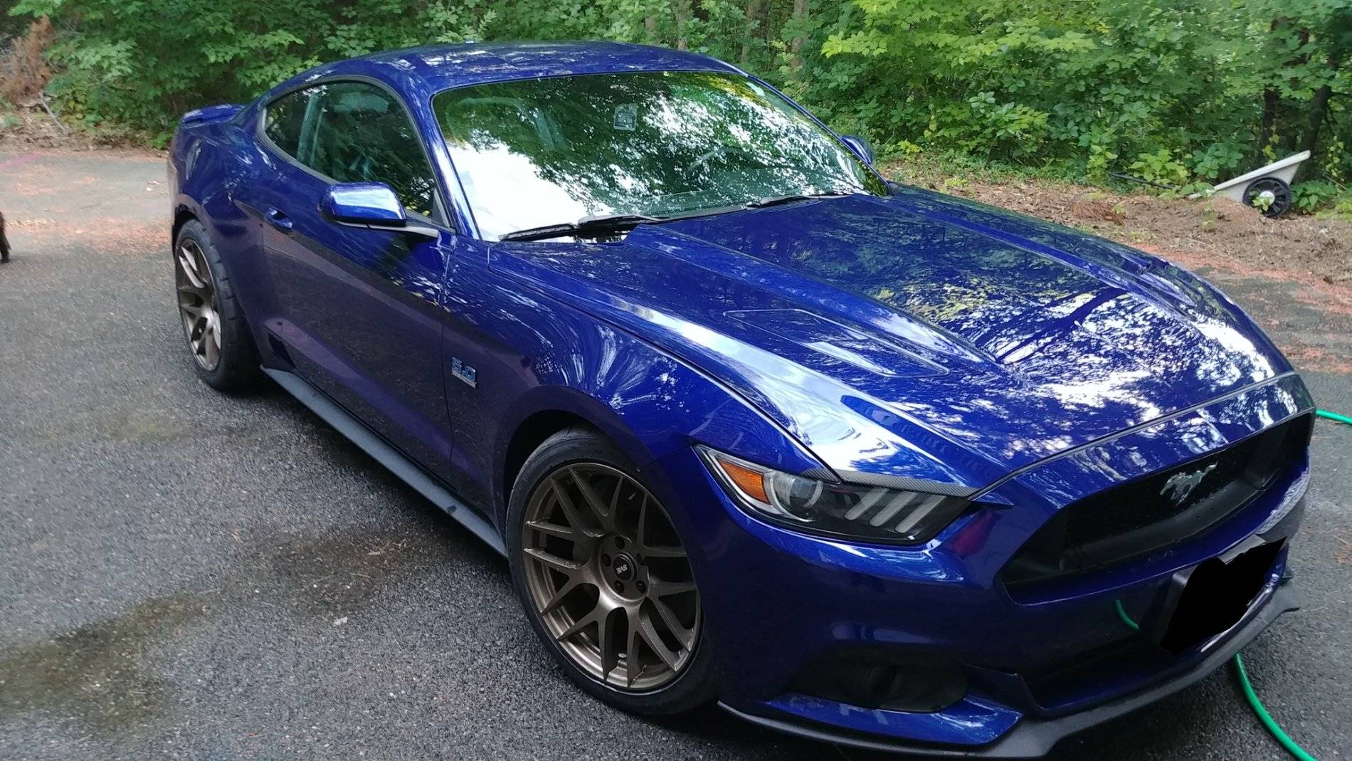

That looks awesome! Did you end up using spacers in front? What was the final total for everything, if you don't mind me asking?
HourlyB
HourlyB
Sep 9, 2019
230
58
Plymouth, Massachusetts
2016 Mustang GT premium
Nope, just using the BMR springs, haven't had any issues with speed bumps or anything else so far.
Parts Breakdown;
  • Ford Performance Track Struct & Shock kit (M-18000-F)
  • Strut Tower Brace
  • Ford TPMS
  • Steeda Front Roll Center & Bumpsteer Correction kit
  • Steeda Rear Lower Control Arm Spherical Bearings
  • BMR Cradle Bushing Lockout kit, level 2
  • BMR Rear Shock Mount
  • BMR Lowering springs (Handling version)
  • SVE R357 wheels (19x10 square set up)
  • Firestone Firehawk Indy 500 (285/35R19)
Total for parts - $3860 (Incl tax, but I used coupons and some items were on sale)
Total for work - $1200, done in 6 days by a local shop (unsure how bad I got fleeced there)
Total overall - $5060
To quote the best phrase in the world;
"Better than I feared, worse than I hoped"

$1,200 is not bad for all that work. In lieu of doing it yourself I'd say you did alright man. Tell us - how does it feel? Also, don't forget a really good alignment plays a large role. Congrats on the new setup.
HourlyB
HourlyB
Sep 9, 2019
230
58
The car feels much tighter and more composed, overall. Wheel hop has pretty much been eliminated and grip is vastly improved. The car feels like it's on rails. But more importantly, it feels much more communicative on top of being more composed, like I can feel exactly what's going on between the car and the road.
Ride quality is still pretty good, though it's definitely a bit harsher, but this only really becomes a problem when going down really neglected roads.
It also just feels better to have some handling to back up the noisy exhaust the last owner put on.
Also, it just looks so much better.
It looks like it started going to the gym lol.
