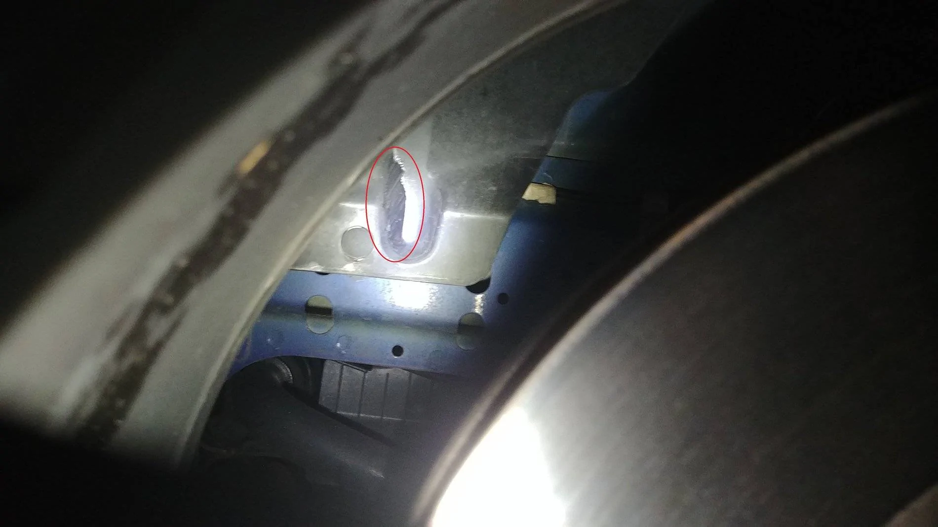

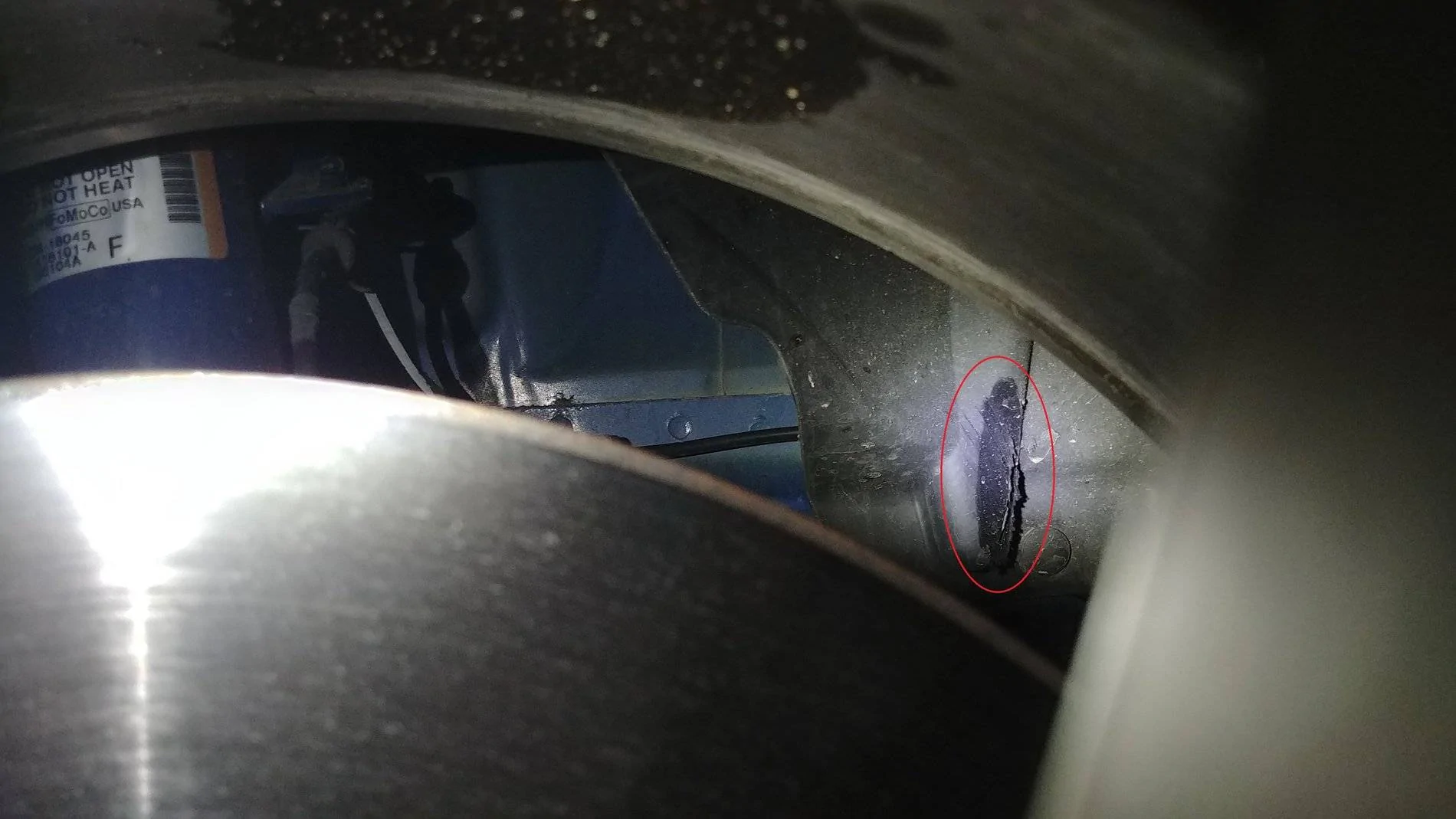

So, bought a set of Eibach 5mm spacers (https://www.cjponyparts.com/eibach-...lac_guid=c8548edf-3ec8-ea11-8348-0050568938fc) and put them on my car yesterday, and there is a problem. I also finally saw where they were rubbing.
(Passenger side)
(Driver side)
I torqued the wheels down yesterday, and after about 50 miles of driving, about 40 of which were on the highway, I checked the lug nuts again, and they were loose. Not crazy loose or anything, and there wasn't any wobble or vibrations while driving, but I still had to torque the nuts about a 1/4 of a turn to spec (150 lbs).
So, the options;
  1. Take the spacers off and just cut the part of plastic liner that is rubbing off, cover the hole with like 5 layers of duct tape and try to return the spacers to CJ
  2. Buy some Locktite and put it on.
To be honest, I prefer the first option to trusting a chemical compound to hold the wheel. What is exactly behind the pseudo-cone? And is there a guide to removing and reinstalling the liner?

So, the spacers did not solve the rubbing issue, but only on the passenger side. Driver side was fine.
It was only on full lock and still slight, but definitely there. I took video, but oops, "file size too large"

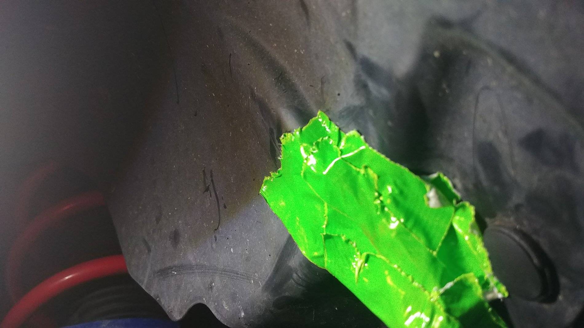

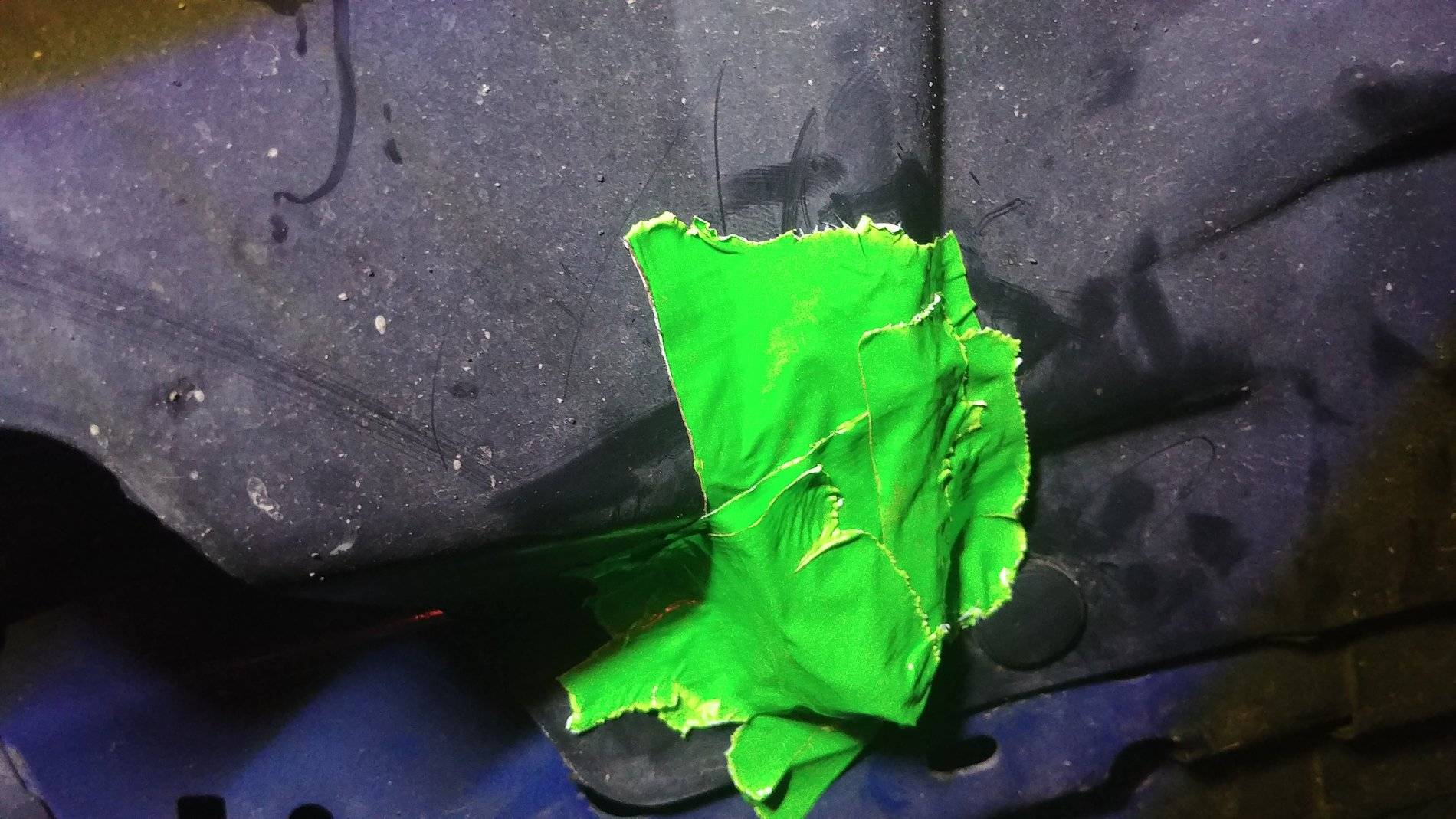

So, I "hot rod-ed" aka "did a shitty bodge job but i mean i guess it works for the time and it's better than doing nothing and at least nothing important got damaged".
I cut the area that was scraping with some shears and then used a file to make the edges softer and less jagged, then I put some neon green duct tape on so that I can more easily check for marks if the rubbing remains a issue.
Took it for a couple loops in the cul-de-sac. Not sure if it's rubbing or not, but duct tape will offer more cushion than basically self sharpening plastic. When I get my brakes job done, I ask if they can provide a more permanent solution.
Oh, also the lug nuts stay torqued now.
