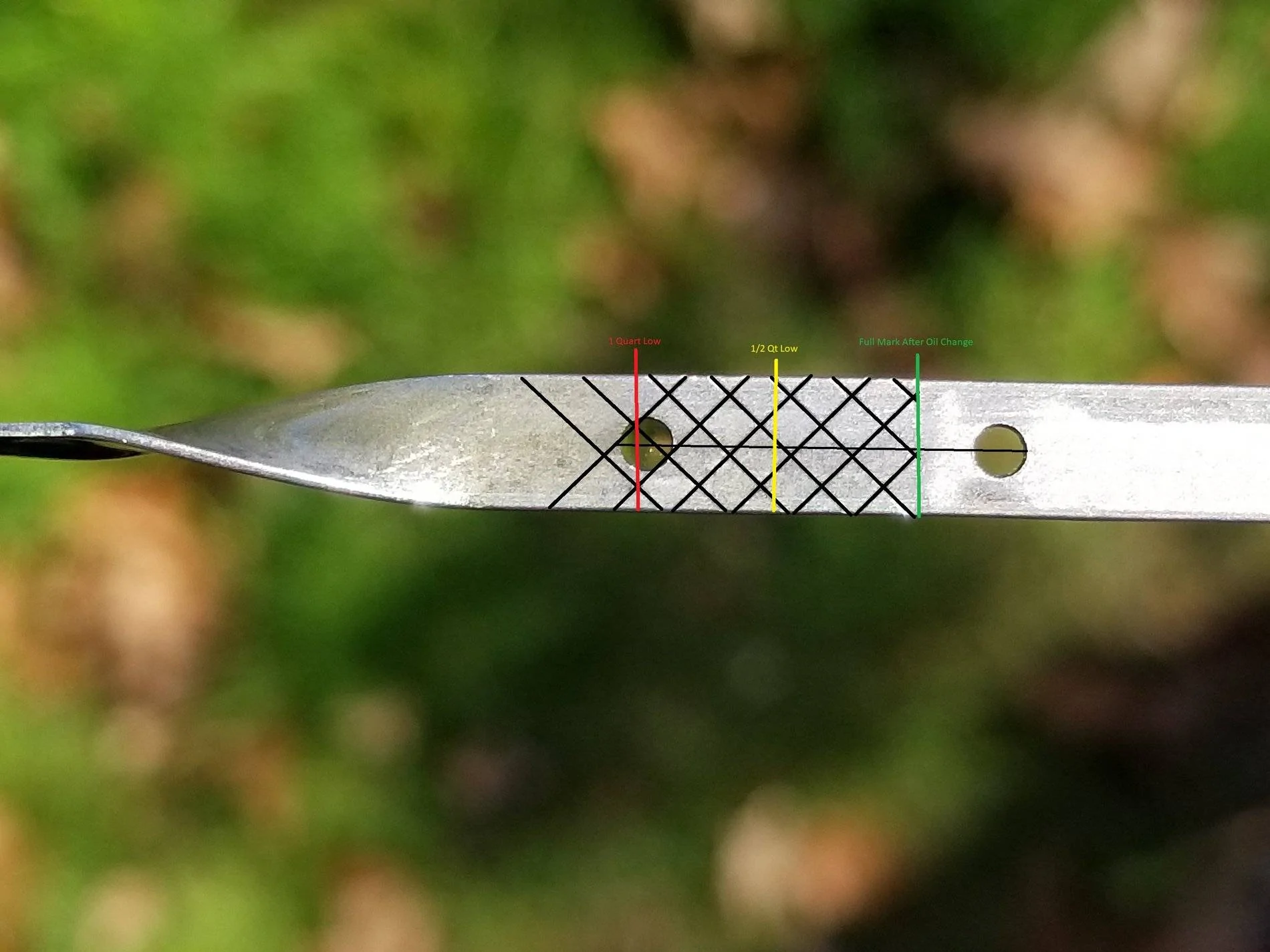

@lenFeb ...The very first question to be answered is -- where is the full line on YOUR car? When you change the oil and check it, where does the level come to? Does it stop at the top of the hole or the top of the hashmarks? Or slightly below the hash marks? You would not want to fill to the top of the top hole if that's not YOUR full line. Make sense?
Follow. The. Owners. Manual.
Will it hurt anything to add to the top hole (or wherever YOUR full mark is)? No. Is it worth it? No.
And no, there is not enough oil in your one oil separator (the left one is not accumulating anything) to account for the oil loss.
To put it into perspective, you are wanting to add ounces...mere ounces...probably single digit ounces...to a 2 1/2 GALLON system. Let that sink in.

lenFeb
lenFeb
Dec 31, 2019
30
956
847
USofA
Len
2019 Shelby GT350 #K0110
This is what one quart low looks like.
After my oil change with 10qt the oil mark was at exact upper hole. Not at upper hash mark like in your picture.
