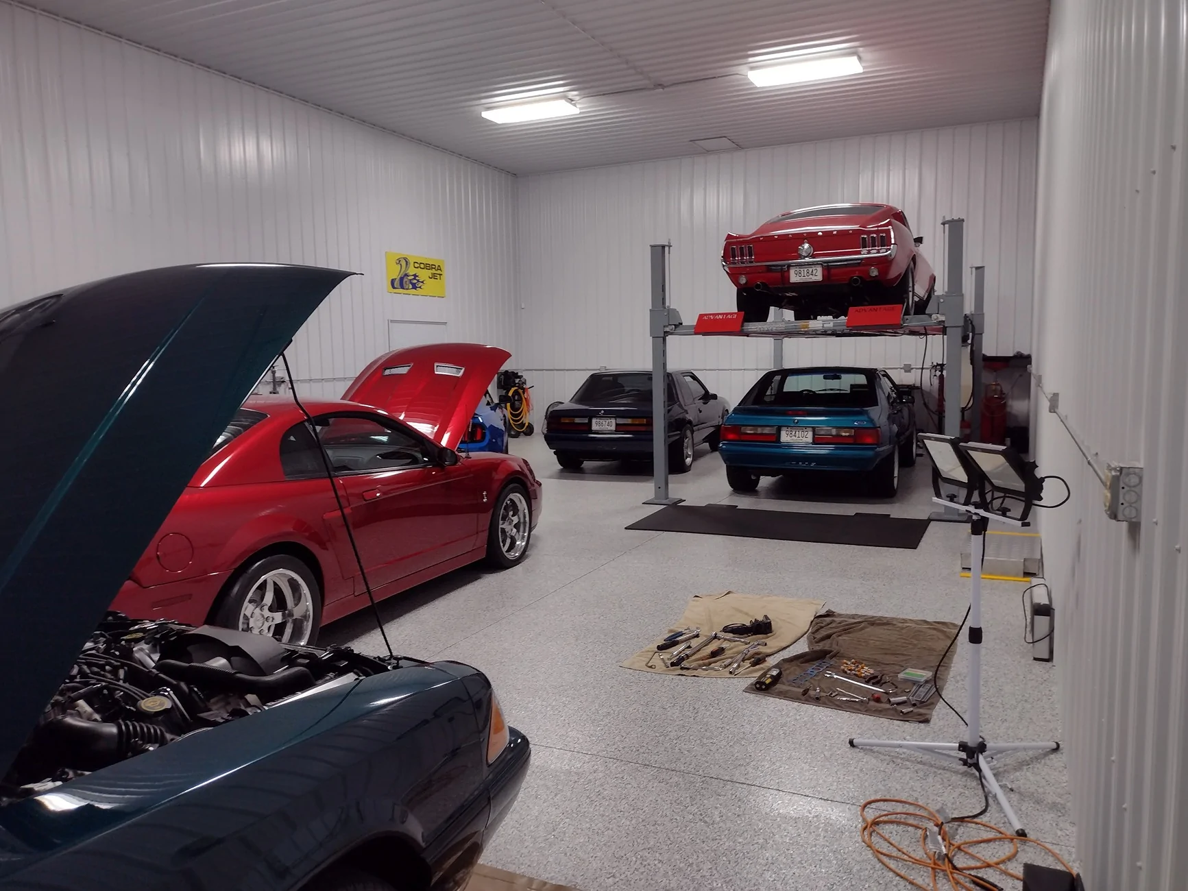

I dont think the ESP requires Ford Motorcraft oil. Just keep oil changes documented and keep receipts. Nice collection of Stangs! I see a fox notch! I have an 03 Saleen supercharged. With an 18 GT350 and a 17 GT350R!
Thank you kindly, nice collection as well! I do have a thing for foxbody mustangs. I recently replaced the intake gaskets on the 90 convertible that's kinda in the picture.
