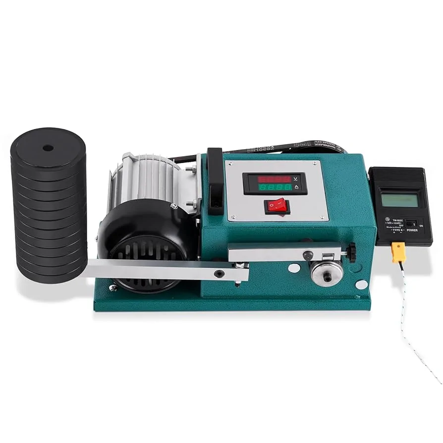

Okay it's proprietary so he can't tell you, but the part about "friction test under load, which generates a wear scar" indicates he's using something akin to a one-armed bandit:
While these devices are indeed designed for a purpose, that purpose is not testing motor oil.
There is no component of a modern engine that should see metal-on-metal sliding parts in the way that tester works. That is not how they are designed to work. This tester would be useful for testing something like gear oil meant for a differential with hypoid gears. Those differentials will call for somethin like a GL-5 oil which has additives specifically designed for high pressure, and they will perform well on this type of testing device. Motor oil is not designed to perform well on the test this device performs, and ranking motor oil based on results from this testing device is an absolutely idiotic thing to do.
Lake Speed Jr. explains it a lot better than I do:
In short, this "540 Rat" guy is a kook and you shouldn't make decisions about motor oil based on anything he says.

Lake is a well-regarded Tribologist (a lubrication engineer) and owns a company that does oil analysis using atomic emission spectroscopy.
Your guy "Rat 540" is.... not. He's some guy on the internet that bought a $300 abrasion tester and doesn't even use his real name.

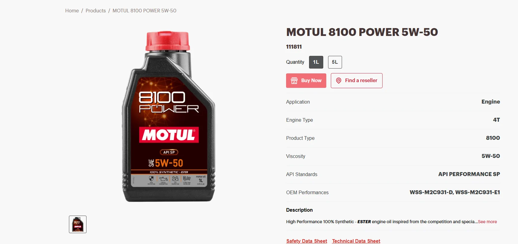

Motul 5W-50 also meets the Ford spec for the GT350
If I didn't already use Amsoil in everything, Motul across the board would be my go-to.
