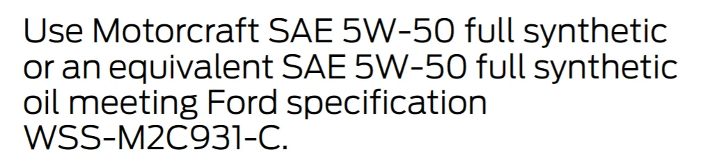

Before getting too hung up on the Ford spec, this language is lifted from the 2015-2016 GT350 Owners Supplement:
"Your engine has been designed to use engine oil that meets Ford specification or an equivalent engine oil of the recommended viscosity grade that displays the API Certification Mark for gasoline engines."
The Owner's Supplements up to 2020 have the same language or something similar.
As for how many oils have both API and Ford spec compliance, there are actually two. One is the Castrol Supercar oil and the other is Motorcraft 5w-50. Presumably, it's made under contract to Ford by one of the companies on the API website list.

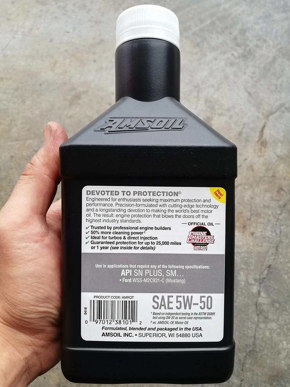

Nope, they don't say they meet it. You're quoting the same thing I'm quoting. They never claim to meet the spec. They say "Use AMSOIL Signature Series Synthetic Motor Oil in applications that require" followed by a whole laundry list of specs and approvals which they do not have (including Dexos, which helpfully lists the oils that have approval and Amsoil is notably absent.)
It's weasel wording and Amsoil is infamous for this. If they claimed that they met the specification, Ford would likely take legal action against them. So would API, GM, and others.
They use the exact same wording on the back of the bottle:

Again, I'm not saying that Amsoil is bad. It just isn't. But when it comes specifically to the question of whether their oil is 100% not going to void your warranty - I wouldn't bet a $25k engine replacement on it. You are putting yourself at the mercy of your dealership and Ford.
