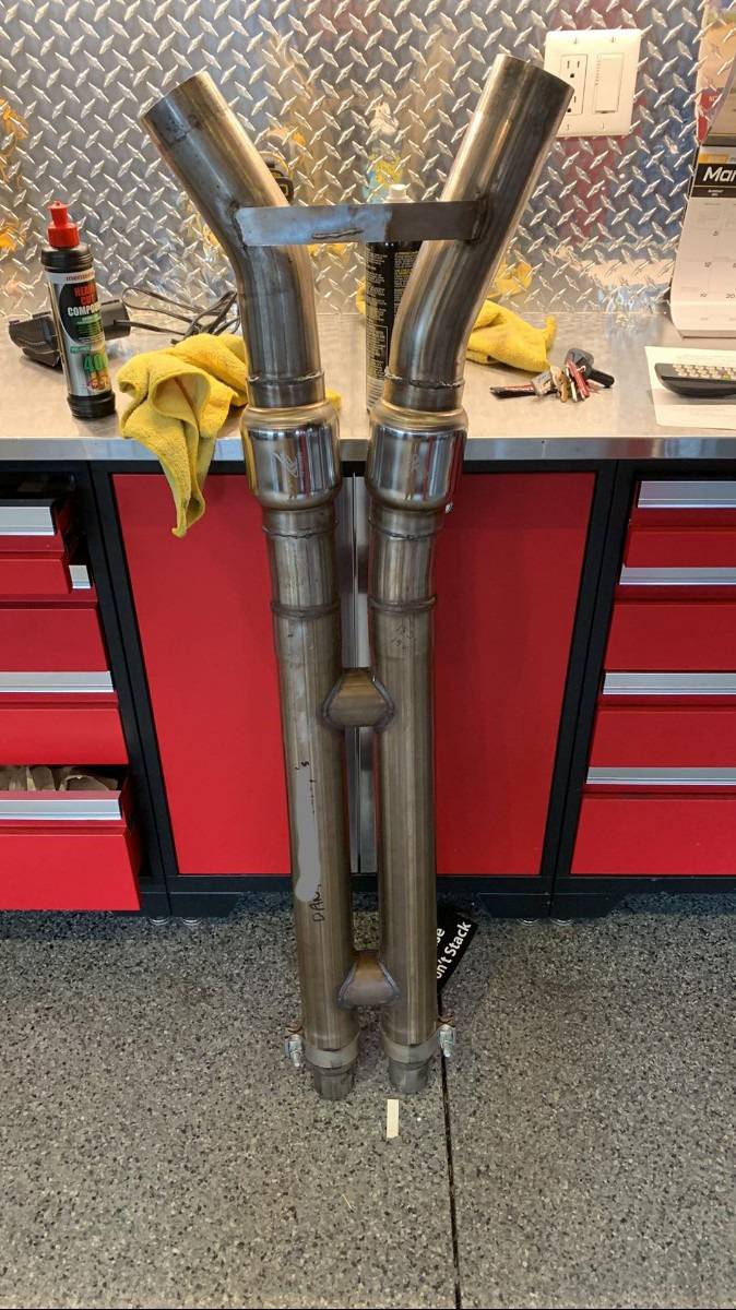

I went Corsa double H with 2 Total Flow 6645B mini race mufflers welded in. Running Corsa Sport Cat-back.
NO more rasp at all, 25% louder than stock below 4K, above 4K and WOT sounds like a pissed-off super-muscle car. I'm also Roush Supercharged P2.
H or Double H is lower tone, the race mufflers eliminate all rasp.
Now that right there is how to keep sound low and CFM high. Now all you need to is to eliminate the connection bottlenecks.
