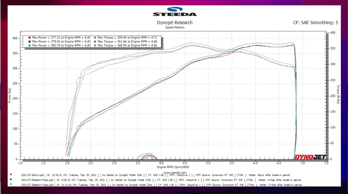

Recently switched from Pypes h-pipe to Steeda x-pipe. I liked the H-Pipe, but the x-pipe just sounds much meaner to me.
IMHO: Compared to H-Pipe... the X-Pipe performance was more noticeable (Flows much better up-top) & the sound is much more aggressive.
Dyno: H-Pipe vs X-Pipe

10 dyno runs in a row you'll likely see no difference on avg as the delta could be so low either way. Do it based on the sound you like better.
