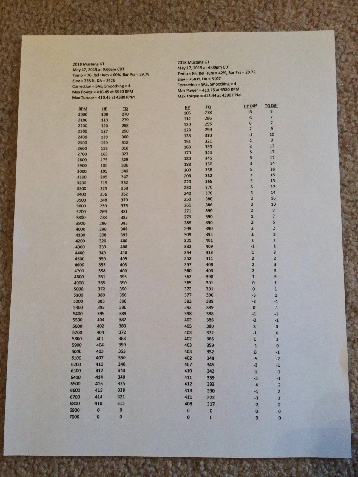

I just recently tested this for the Steeda H-pipe. This is a stock 2018 GT M6 with active exhaust (set on track for all pulls). I saw some decent torque gains up to about 3800 rpm. Now just need for someone to do the same for an X-pipe.

Btw, the res delete H-pipe really wakes up the active exhaust. Very happy with this mod.
Wow - what great timing! I just ordered the Steeda H that was on sale, and will be installing soon. This is great info - thanks!

Thanks Silver Bullitt, this is exactly what I was looking for. I had read that the H pipe did better for low end TQ but wanted some proof. The article I read stated that the H pipe gained low end TQ but lost high end HP, makes since, And visa versa for the X pipe, so it would be interesting to see what you did for a X pipe too. I would prefer a little more on the low end to help livin the fun factor of the car for daily driving. I will be coming from a SC C7 vette when my build is finished so low end is what I would like to increase mostly.

I don't see how an H pipe could lose high rpm power versus the stock resonator. I can easily see why the X pipe might be a little better than the H at high rpm but it doesn't make sense to me that the stock resonator flows better or has better scavenging than an H pipe.

I would agree that peak numbers are within the margin of error, but I would disagree that you won't necessarily see any benefits under the curve. I recently dynoed an H-pipe on an otherwise stock GT and saw gains up to 18 lb-ft under the curve (marginal if any peak differences). This was a same day same dyno test, and if anything, the post H-pipe pulls were at a higher DA and the car was probably a little more heat soaked. However, my main goal was a little more volume to the exhaust note and I prefer a deeper tone, both of which the H-pipe delivered on. The additional torque in the low to mid range was just an added benefit. It would be interesting to see the same test with an X-pipe just to compare.
