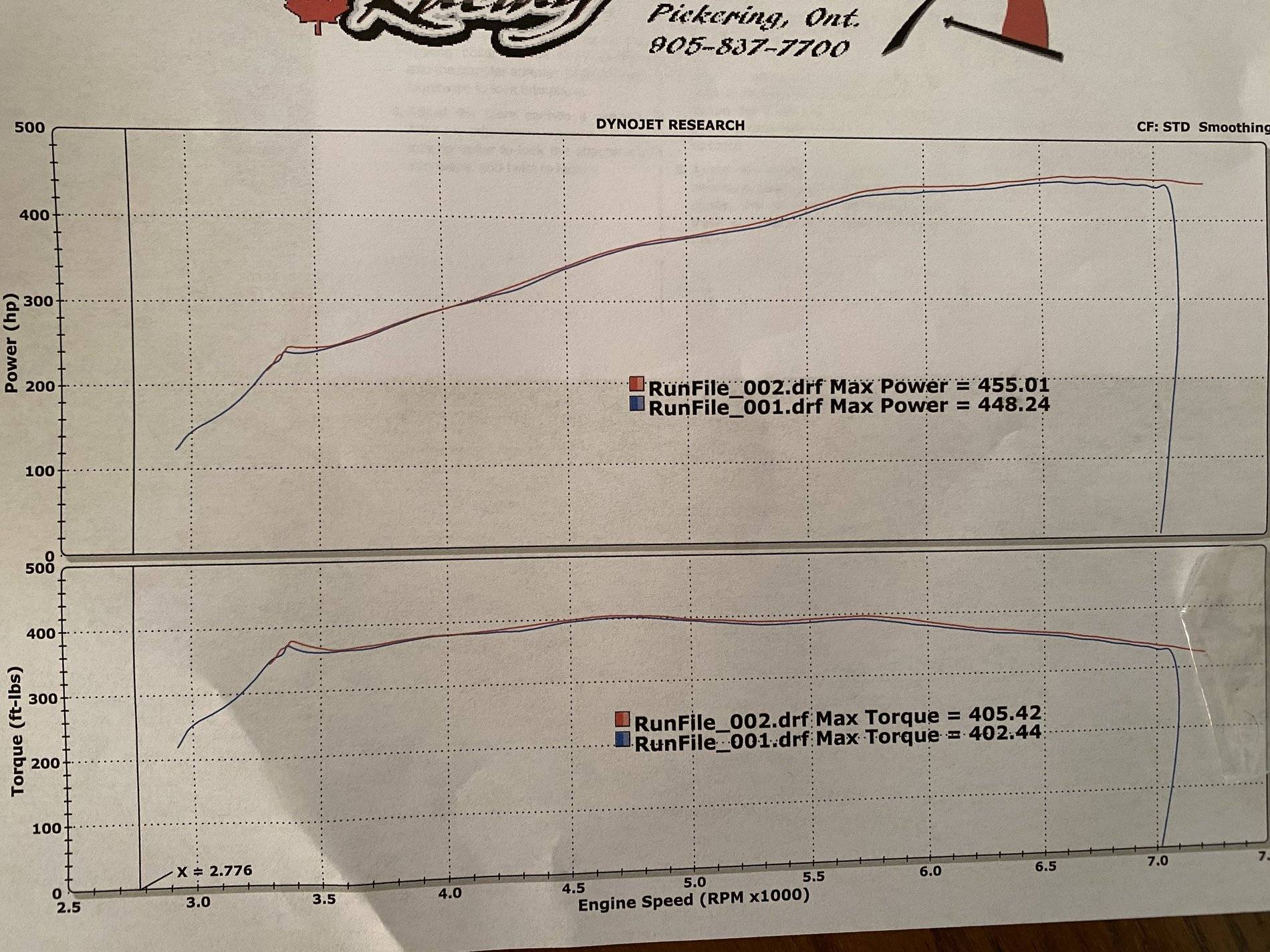

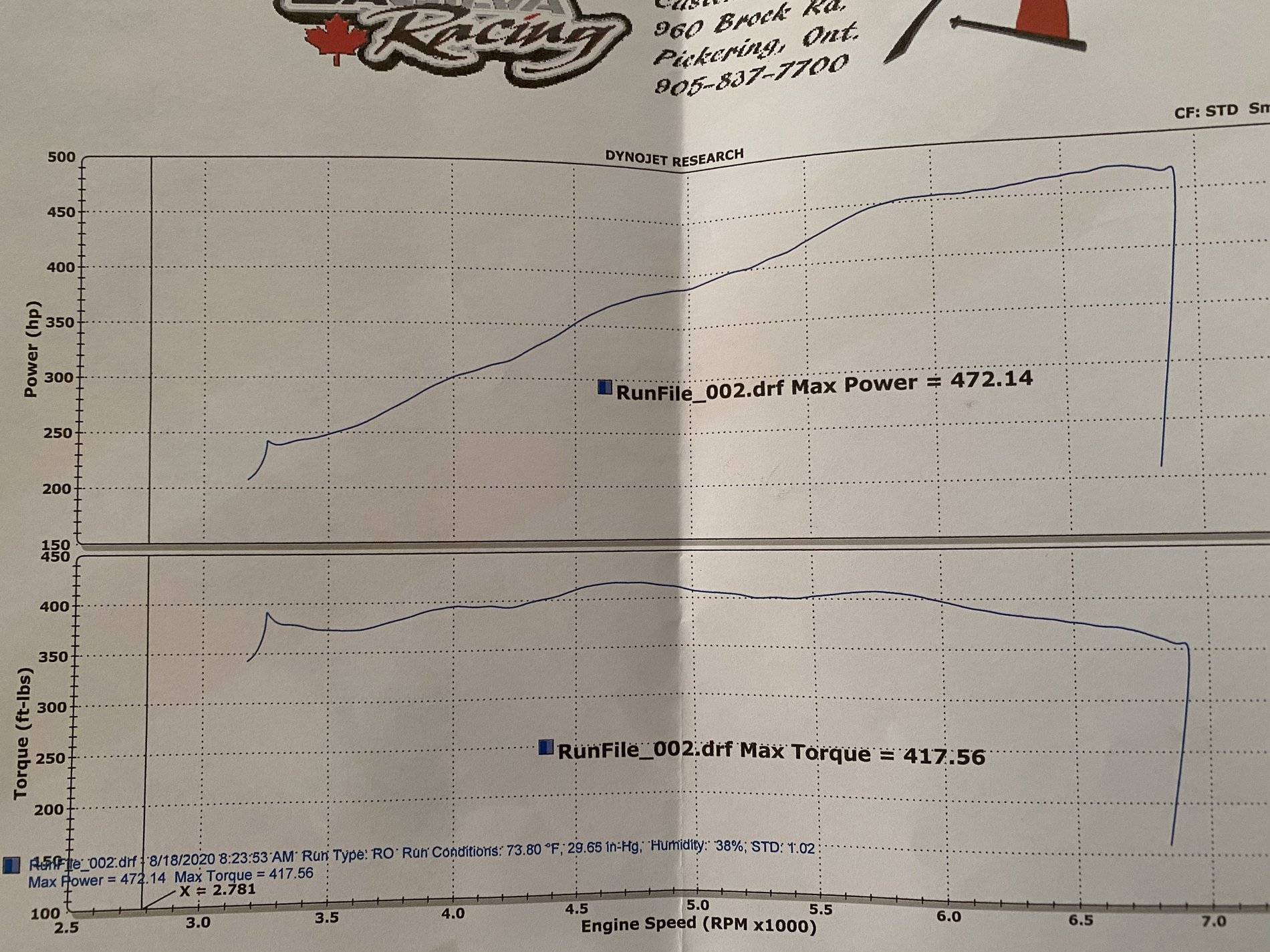

Can you post your two dyno graphs? I've seen many times where a peak value is quoted, but only to be found to be some arbitrary spike at the end of the rpm range.
Also, fuel and different ambient conditions could affect it as well. Another thing to watch out for is some shops will quote PS, which is higher than hp. 1 PS = ~.987 hp. If your first run was in PS and your 2nd in hp, that would close the gap. I realize it's the same shop, but if they were trying to "sell" you on the mods, then I can see them doing that. Most people wouldn't know the difference. Another is one could be SAE corrected while the other not corrected. Then if there's a spike as I mentioned, the difference may be just semantics.

Looks good to me. I wouldn't worry about it.

A little research shows Canada switches to winter blend fuel on September 15th. If your last dyno was prior to that you were on summer blend fuel. That alone could account for your 20hp.

That’s all I needed to hear. Yeah the FBO was before September, it was in August actually now that I recall....
Makes sense.
