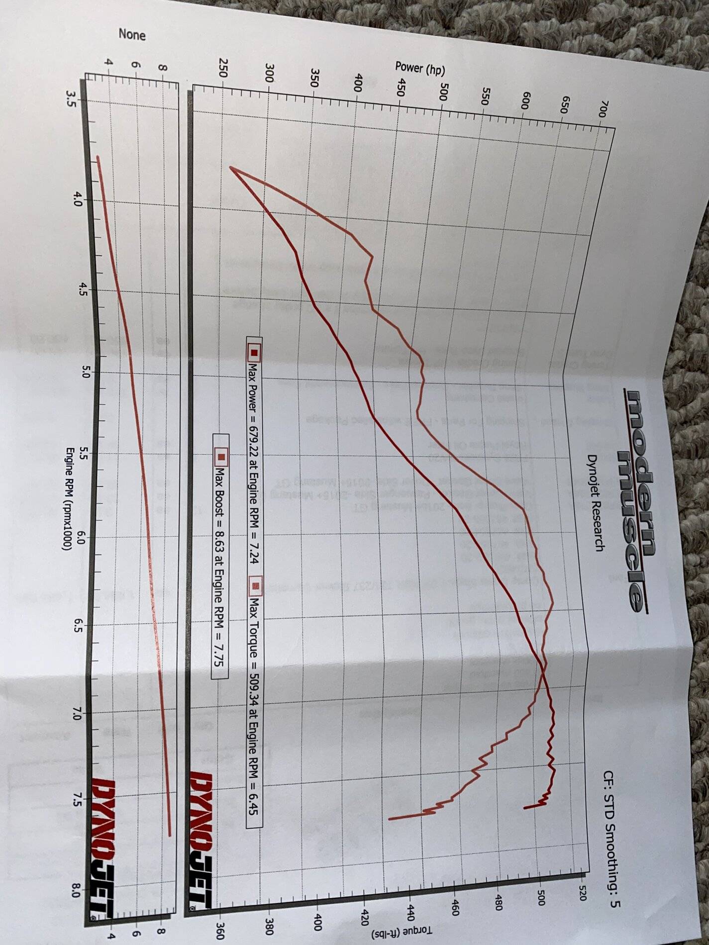

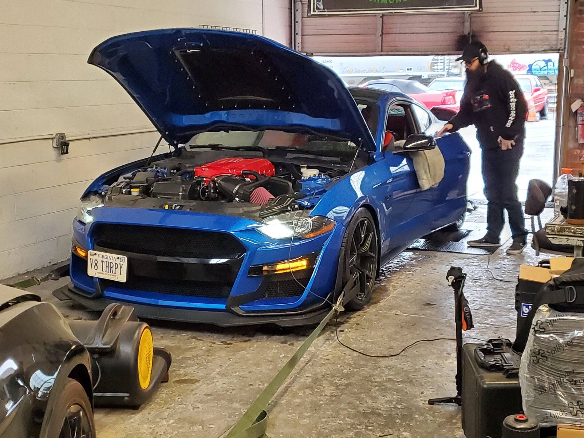

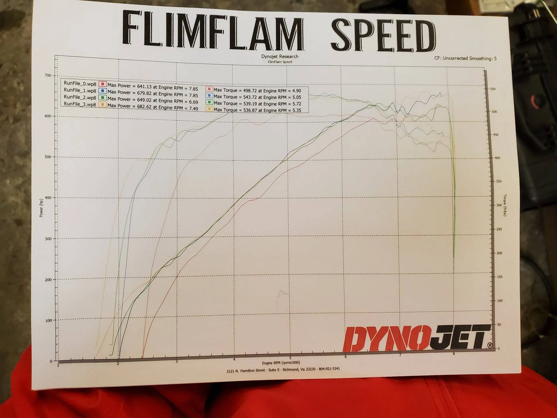

So got her on the dyno today. Not exactly what i hoped for, but solid numbers. Lund reviewed the datalogs and determined fuel was limiting things uptop as car had to pull timing. It was ran in 6th gear. Stage 2, 3.875 pulley, id1050x injectors and a BAP.

What kind of power is typical of cars with similar setups as yours? I was just curious as to how you had fueling issues with bigger injectors and a BAP? What fuel were you running?
93 octane, per lund it just wasnt giving the car what it needed up high.

Gotcha. What voltage were you running on your BAP? Just asking because I am preparing to have Lund write a nitrous tune for me. I’ll be running on E85 and a BAP.
Not sure if i am honest

Reason I ask, im pushing 680rwhp on my '17GT powered by my vortech v3 si on 93 pump and 8.5lbs of boost. Looking to do internal work (pistons/rods) so I can up the boost and convert to e85.
Not a real apples to apples comparison given the higher gen 3 compression and different power adders. Depending on your power goals you need fuel system more than need forged internals

why do your graphs TQ and HP numbers not cross at 5250ish RPM?
