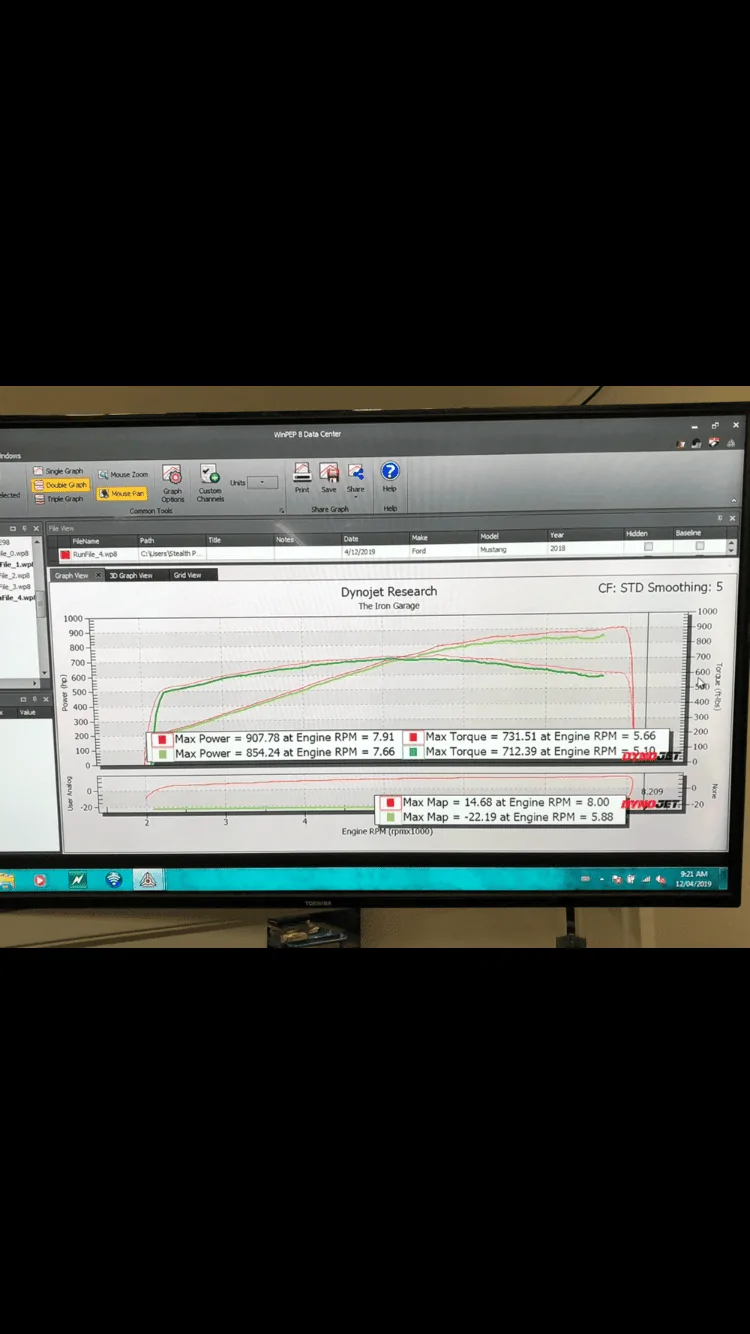

18 Whipple M6 dyno results
Kent Stacey
Dec 29, 2018
Fort McMurray Alberta Canada
Kent
2018 Mustang GT
NO TICK 2500 km / 1500 mile engine.
Whipple 3.0 / 150mm
Boundary OPG / CS
Fore system dual 450’s / ID 1050’s
10 RIB 20% OD / 4.00
Mantic Twin Disc / Flywheel
G force aluminum driveshaft
Catless 1 7/8’s ( open headers )
Brisk plugs
Driven 5w50
E85
14.68 psi @ 8000 rpm
Tuned by Lund Jr
Video of the pulls can be seen here along with some other videos of the install etc.
Platinum_5.0
Jan 8, 2018
425
197
Edmonton, Canada
Daniel
2021 10R Whipple
And power was still climbing even at 8000!:rockon:
