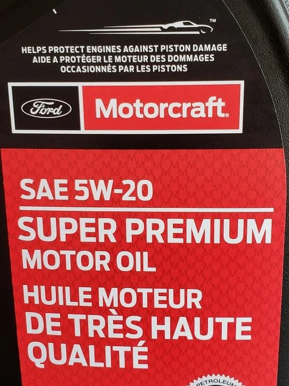

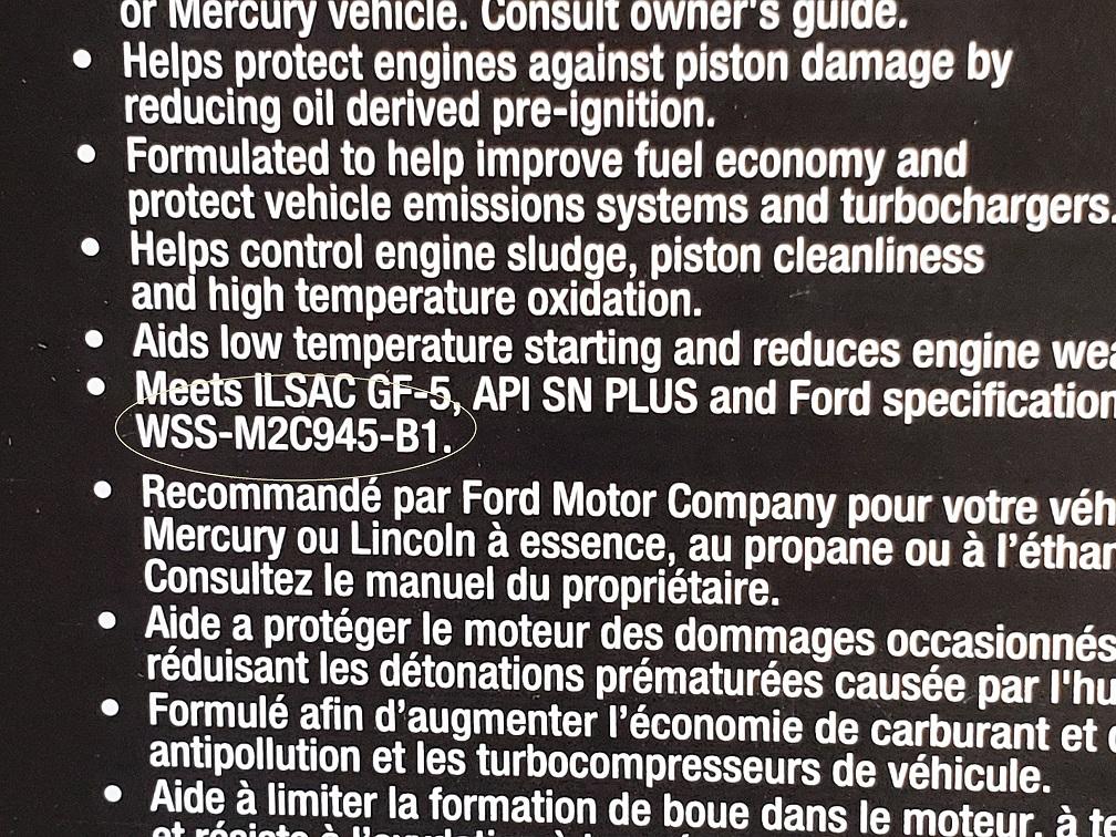

I'm just curious if anyone who changed their oil on the 19 was able to buy oil that actually met the specification in the manual. I had to go to a Ford dealer to buy a quart of their 5W20 to have in case I need to add some oil to my factory fill. Here in Canada no oil meets the new spec at least where it says that they do & that includes Mobil 1 etc.
Basically this new Ford oil spec is to combat LSPI (Low Speed Pre Ignition) which surprised me when I read up on it. I thought that was just an Ecoboost issue. All the oils say they meet Ford WSS-M2C945-A but not the one circled in the pic of the oil I bought. So I'm wondering if anyone who is changing their oil with anything other than Motorcraft is jeopardizing their warrranty? The stuff was cheap so it isn't fancy oil I'm sure either LOL.
It even notes it prevents piston damage which I 'm sure relates to the LSPI condition? Basically WSS-M2C945-B1 replaces the previous WSS-M2C945-A and evn the dealer said this is a new thing I think just starting this year.

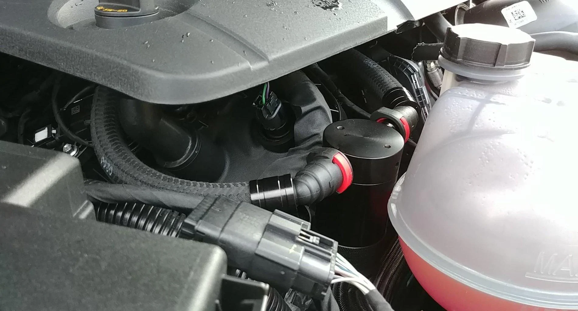

Around 5k on first oil change here, over 6k right now and watching oil life monitor (still over 40%). Probably will change around 7500 this time around. I get great fuel mileage in my car, I run Pennzoil 5w-20 Ultra Platinum and Mobil 1 M1-212A filter. I also run Mobil 93 octance or Shell V-power 93 in a pinch. Highly suggest adding the oil seperator on the passenger side if you haven't done so yet.
