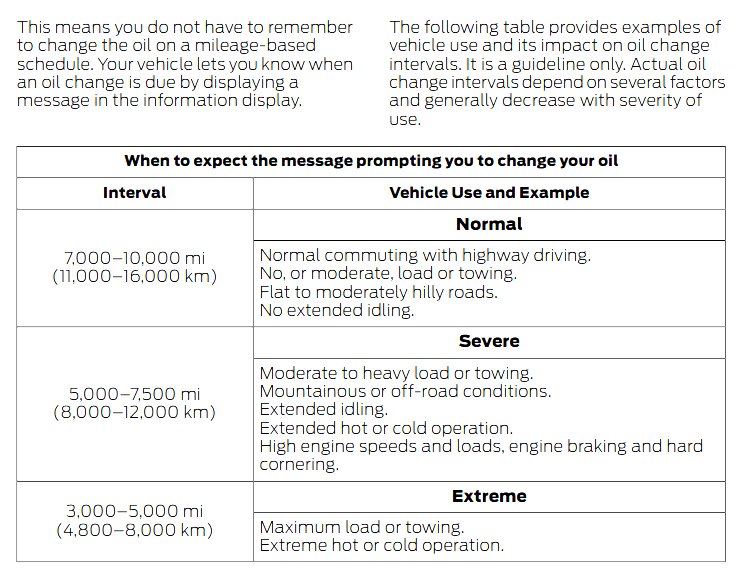

Did you read what is in the owner's manual?
pg 449 - 450 says:
Your vehicle is equipped with an intelligent oil-life monitor that determines oil life based on engine operating conditions.
• Under normal operating conditions, a message appears in the information display to indicate the regular oil change interval.
• Under severe operating conditions, the oil change interval may reduce, and the message interval may adjust.
High performance vehicles can be driven in such a way that may lead to higher oil consumption (this includes extended time at high engine speeds, high loads, engine braking, hard cornering maneuvers, and track use).
Under these conditions, oil consumption of approximately 1 quart per 500 miles (1 liter per 800 km) is possible. As a result, the engine oil level needs to be checked at every refueling and adjusted to maintain proper level to avoid engine damage.
Note: Oil level should not exceed the maximum mark on the indicator. See Engine Oil Check (page 263).
When the oil change message appears in the information display, it is time for an oil change. Make sure you perform the oil change within two weeks or 500 mi (800 km) of the message appearing. Make sure you reset the Intelligent Oil-Life Monitor after each oil change. See Oil Change Indicator Reset (page 264).
If your information display resets prematurely or becomes inoperative, you should perform the oil change interval at six months or 5,000 mi (8,000 km) from your last oil change. Never exceed one year or 10,000 mi (16,000 km) between oil change intervals
pg 452 starts with
NORMAL SCHEDULED MAINTENANCE Intelligent Oil-Life Monitor™ Your vehicle has an Intelligent Oil-Life Monitor that determines when you should change the engine oil based on how you use your vehicle. By using several important factors in its calculations, the monitor helps reduce the cost of owning your vehicle and reduces environmental waste at the same time.
got to pg 453 shows this:
If it is a V8, I do not know anyone who doesn't drive the car, shall I say, 'spirited' which , to me, pushes us to severe or extreme.
For me, I have a '19 GT PP2 which gets an oil change every 4 months like clockwork. Did I mention I only have 11,600 miles on it and yes it is my daily driver. I am fortunate to work 5 miles from home. YMMV but I would rather change too much and do all the other checks I do than push my luck.
For those who drive it in non winter months, I could see myself changing to start of the season and again at the end of the season just like I do with lawn gear and snowblowers.
