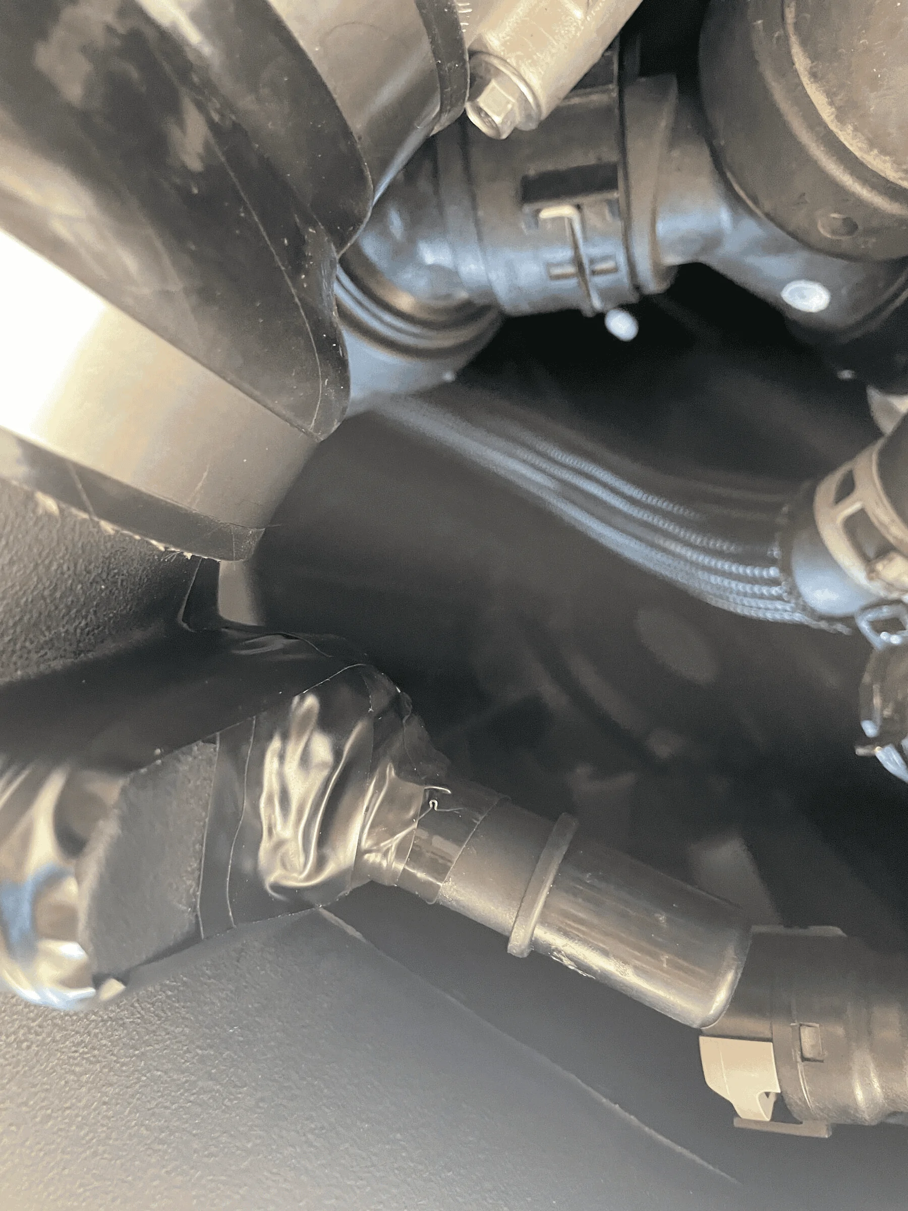

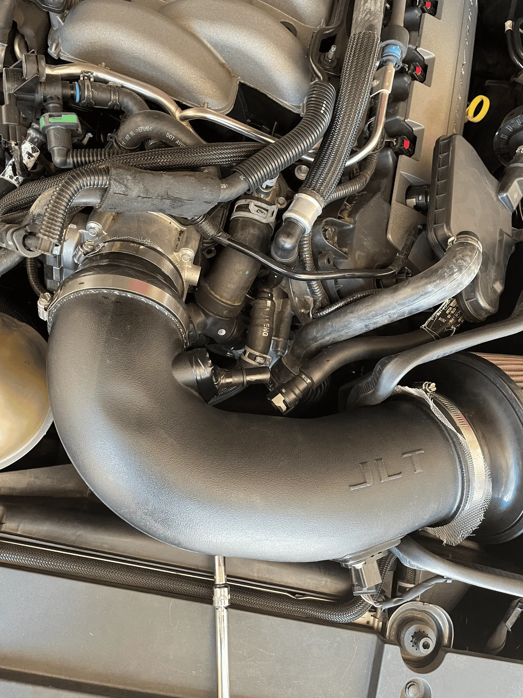

Sorry tristan but I can't sit and let some think a forum vendor screwed up when they didn't.
These pics were sent to me on May 8 2022 by @tdstuart second one was captioned leak fixed.

Don't be sorry. I don't have any beef with Wengerd, this isn't a thing I am doing to ruin his reputation just to ruin it. Post all the evidence you have. If Wengerd didn't do anything wrong and Lund is lying to me then I would rather know. I am just stating things as I know it.
Also just to re-iterate I did have shifting issues with the Wengerd tune that Lund did fix.
The pictures show my many attempts at making a band-aid fix for the JLT to make sure that the tiny leak I found wasn't messing with the trims. Never did it make a difference. These were all while being tuned my wengerd.
And yes as I've stated the JLT had a small leak which I played with. It only leaked when pushed very hard to the side. So I taped it up, used rtv sealant, and held it straight with my finger. Never did it change the fuel trims. My temporary fixes didn't last long and over time the JLT seal started ripping (wasn't torn when originally talking with Wenger). So I bought a new connector and changed the breather hose to just a plain hose so that it didn't put any pressure. Even after this permanent fix I don't think my trims got any better as shown in my old messages to Lund I sent you in DMs.

To properly fix that leak it needs to be plastic welded. I also have had sucess using JB weld and RTV.
It is not still taped is it?
If so it would explain your slower than expected 60 to 120 times.

Am I wrong in saying that you also have a Gen 3 intake manifold . Just curious by your cpv mounting .
Yep gen3. The reason it was having issues is because it’s a 2018+. My stock breather hose was pulling on it, and in my testing could make it leak. I tried different methods of sealing it, nothing changed the fuel trims. Then I just bought a new connector and just a basic hose I cut to length.
