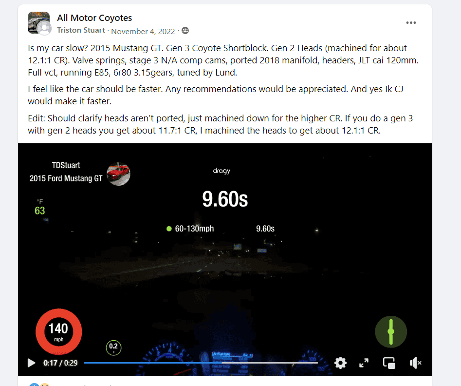

Thats correct we even added up to 30 percent above our maf data we have calibrated for the JLT and used hundreds of times. Still very lean. After that we will not keep adding as there is a underlying issue and that completely throws off the load.
He chose to keep trying to race it anyways even with this condition for some strange reason. We also have all the logs to back this up. Last i seen he was posting up disapointed in his 9 sec 60-130 on his new tuners tune.

It's not that I think you are incompetent or were purposely trying not to get my car running right. I am just stating what happened from a customer's perspective.
You said you couldn't do it, after my engine rebuild I decided to go with Lund. Lund initially struggled with the intake but got it working and told me that I didn't have a problem with the intake and it was fine.
You did warn me not to run the tune and I chose not to listen, I don't blame you for the engine blowing up either, that was my fault.
Edit (forgot to add more):
Also yes I am not happy with the 9 second 60-130. Even after more revisions and good air I could only get a best of 9.2 ish.
There could be several factors. My engine was low on compression and head studs worked themselves loose. Maybe the engine just wasn't producing the power it should because it was leaking in the heads. The car was burning tons of oil so either the heads or rings were leaking.
I am also full-weight with a stock converter and 3.15 gears. Definitely not the best combo for going fast N/A although I would have expected more like low 8s.
Edit 2:
You also couldn't fix the shifting problem, Lund did. I personally think it is a car-specific thing that happens rarely and Lund just has enough cars that they ran into the problem and found a fix. It also happened on their initial tunes but after explaining they were able to implement a fix. I tried to email you explaining that Lund fixed it so that you would know it was fixable incase your other customers ran into it.
