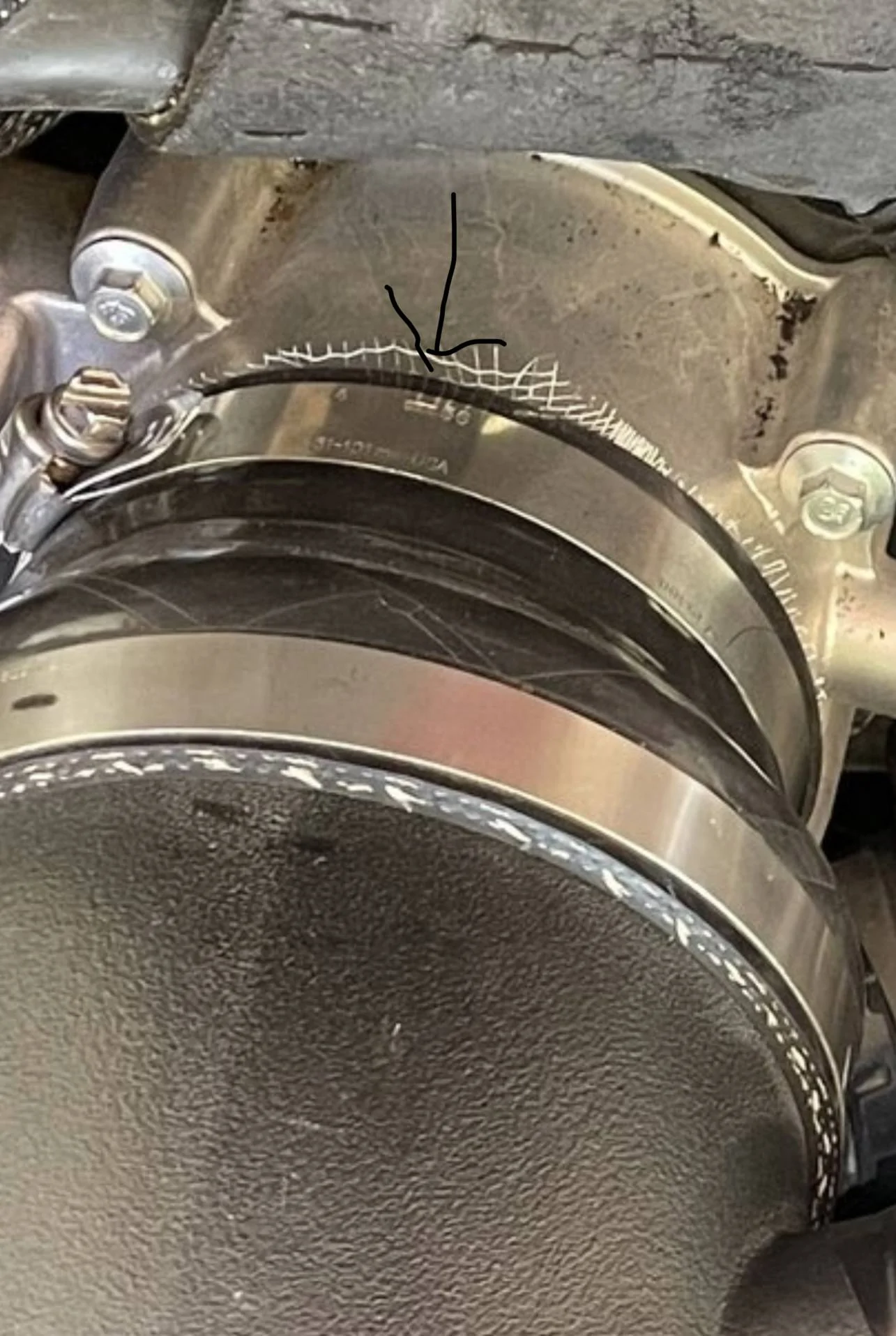

Woah wait a minute. I get putting a screen on the filter side to smooth out turbulent air before the maf, but why the hell did you put one on the throttle body side ALSO??? What the hell were you thinking??
I told you I did a lot of testing. Why are you so eager to give me shit? Do I need to send you my address so you can watch me install the intake?
I pulled my engine by myself in my garage in less than 2 days. You really think I can’t install an intake still :crackup:

No I very simply asked you why you felt the need to put a screen on the TB side of the intake past the MAF. Straight forward question because to me it makes ZERO sense. I’m not giving you shit.

The pictures show my many attempts at making a band-aid fix for the JLT to make sure that the tiny leak I found wasn't messing with the trims. Never did it make a difference. These were all while being tuned my wengerd.
And yes as I've stated the JLT had a small leak which I played with. It only leaked when pushed very hard to the side. So I taped it up, used rtv sealant, and held it straight with my finger. Never did it change the fuel trims. My temporary fixes didn't last long and over time the JLT seal started ripping (wasn't torn when originally talking with Wenger). So I bought a new connector and changed the breather hose to just a plain hose so that it didn't put any pressure. Even after this permanent fix I don't think my trims got any better as shown in my old messages to Lund I sent you in DMs.
(edited last paragraph)
You might want to specify they tuned a whole different setup then what is was dealing with. The same setup I had tuned was not tuned by another tuner. You had a whole new setup when it was retuned.
A JLT intake is one of the easiest things to tune out there. Nearly anyone can calibrate the maf but I can't be a remote mechanic. If you couldn't install or fix the intake (vac leak or whatever it was) a tune can not fix that.

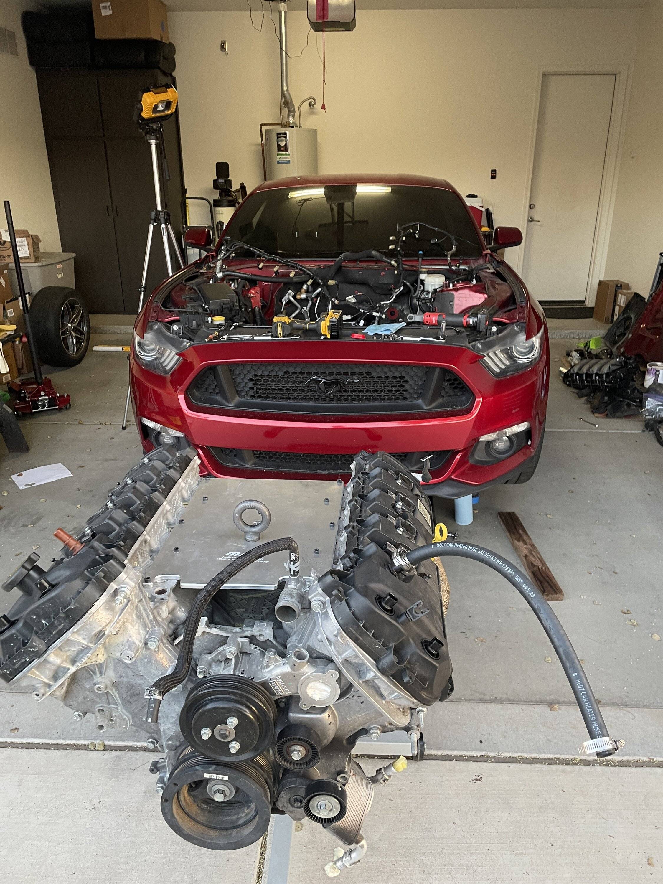

I had cams and a gen 3 shortblock with Lund.
But I highly doubt that was the issue as JLT had issues but stock air box didn’t.

Not trying to be a dick but you never answered my q about why you put a screen post maf on the TB? I can see doing it to smooth out pre-metered air, but all the way at the TB itself isnt going to do anything. Might even interfere with the TB blade. What was the rationale behind that?
The rational was nothing was working so I’ll just try it. I wasn’t holding out hope for it to work.

I’m not super happy with Lund either, but my engine clearly has something mechanically wrong this time which could be the reason why I felt like the car wasn’t making the expected power.
I don’t hate Wengerd. I am probably one of the only people who didn’t have a great experience with him. I am just pointing out my issues with my JLT tune and trans tuning. It could totally be that my JLT has some defect I can’t find that is causing bad maf readings or maybe my pressure test wasn’t enough pressure to see the leak.
