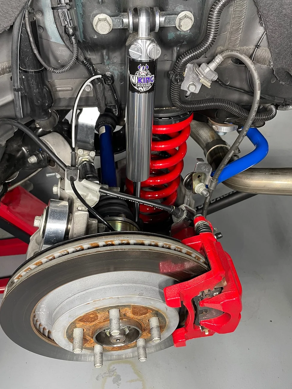

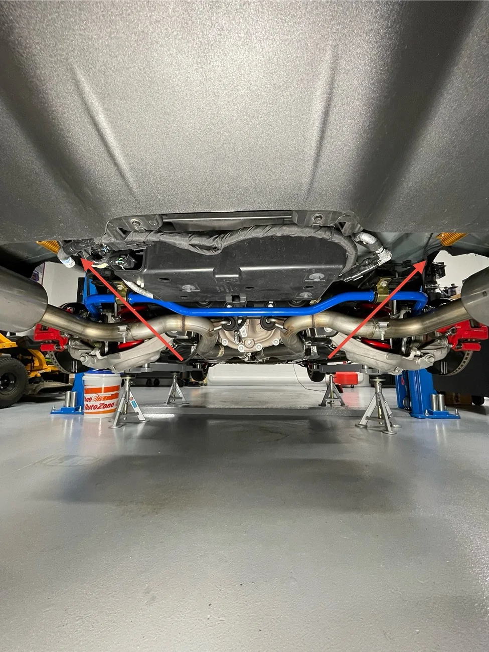

Have you considered switching rear shocks to double adjustables to tailor how the car handles for street vs strip? In addition, spring spacers can raise you back up. I have 1/4 spring spacers on my BMR Magneride drag springs which actually raise the car back up 1/2”. Apparently, when you run spring spacers, whatever the thickness is that you select, they will raise the car up by twice that amount.
If yours is a Magneride car, you’ll either need a set of Magneride delete se sorts or make your own. I chose to make my own, after trying the ones from Shock Delete Engineering worked intermittently.
I am trying to keep the car close to stock driving characteristics while making it faster than stock. I literally cruise this car and drive it out of town.
All Mach 1’s have the Magnaride shocks on them. I thought about pulling all of it out but decided to see how far I can get with the Magnaride in place.
As far as the spring spacers, I did use the 1/4 inch spacers with GT500 springs. It seems to do the trick so far. The car does not sag with the JL Audio 12 inch sub box and JL amp in the trunk.

I hear you. I only made sensor deletes for the rear on mine and they work perfectly. I have KellTrac Ultra Spec Inverted double adjustable shocks. Still on the factory front struts out front.
https://www.mustang6g.com/forums/threads/diy-magneride-delete-option.196442/

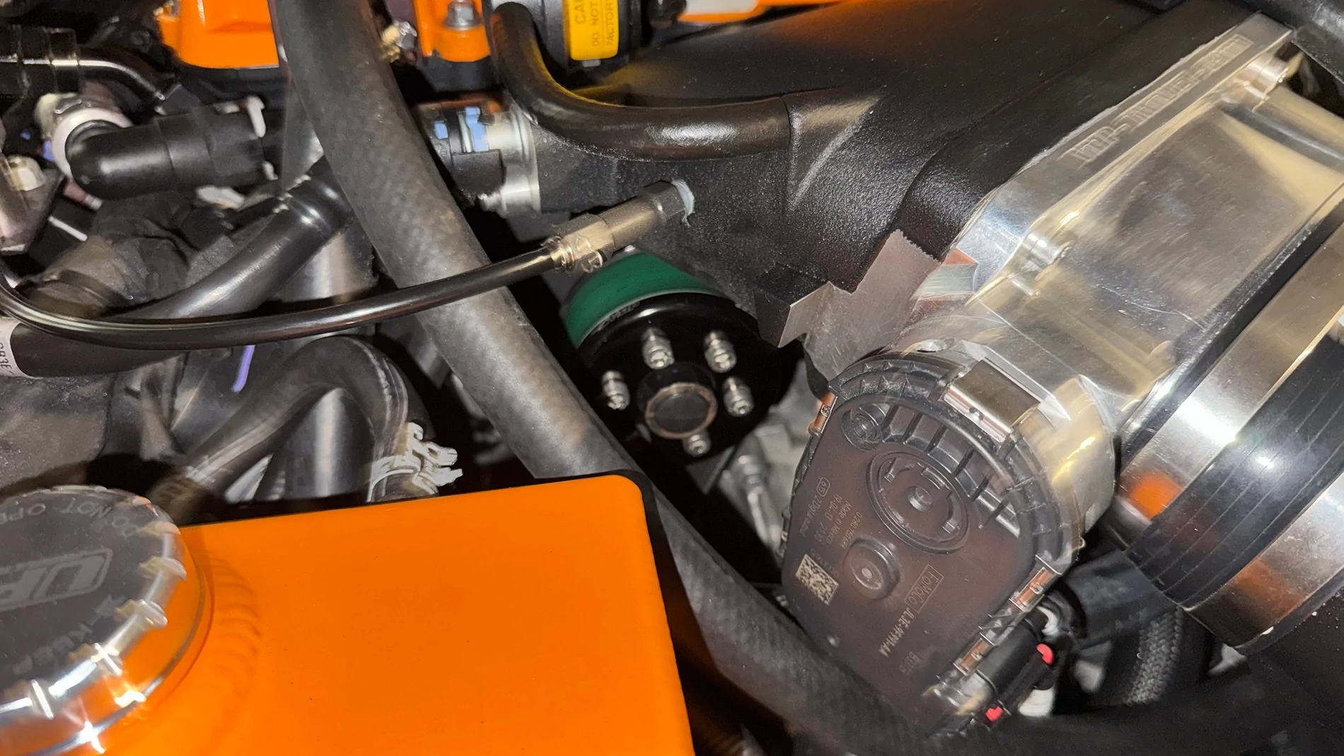

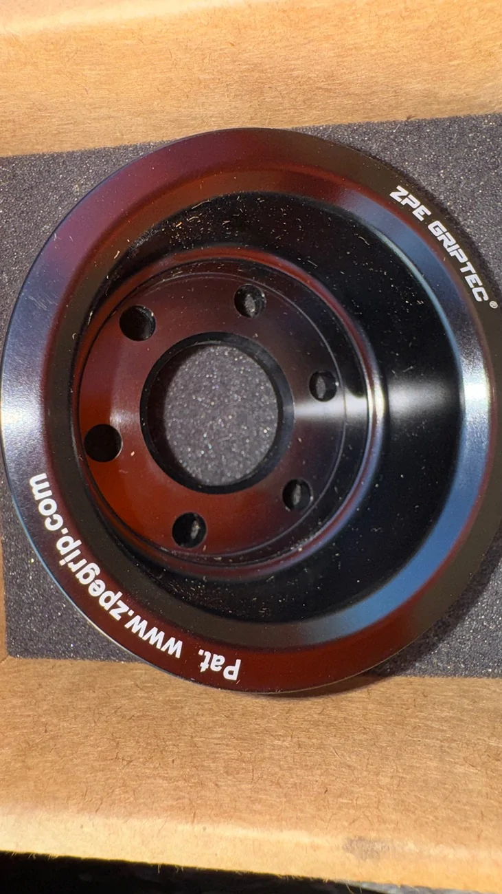

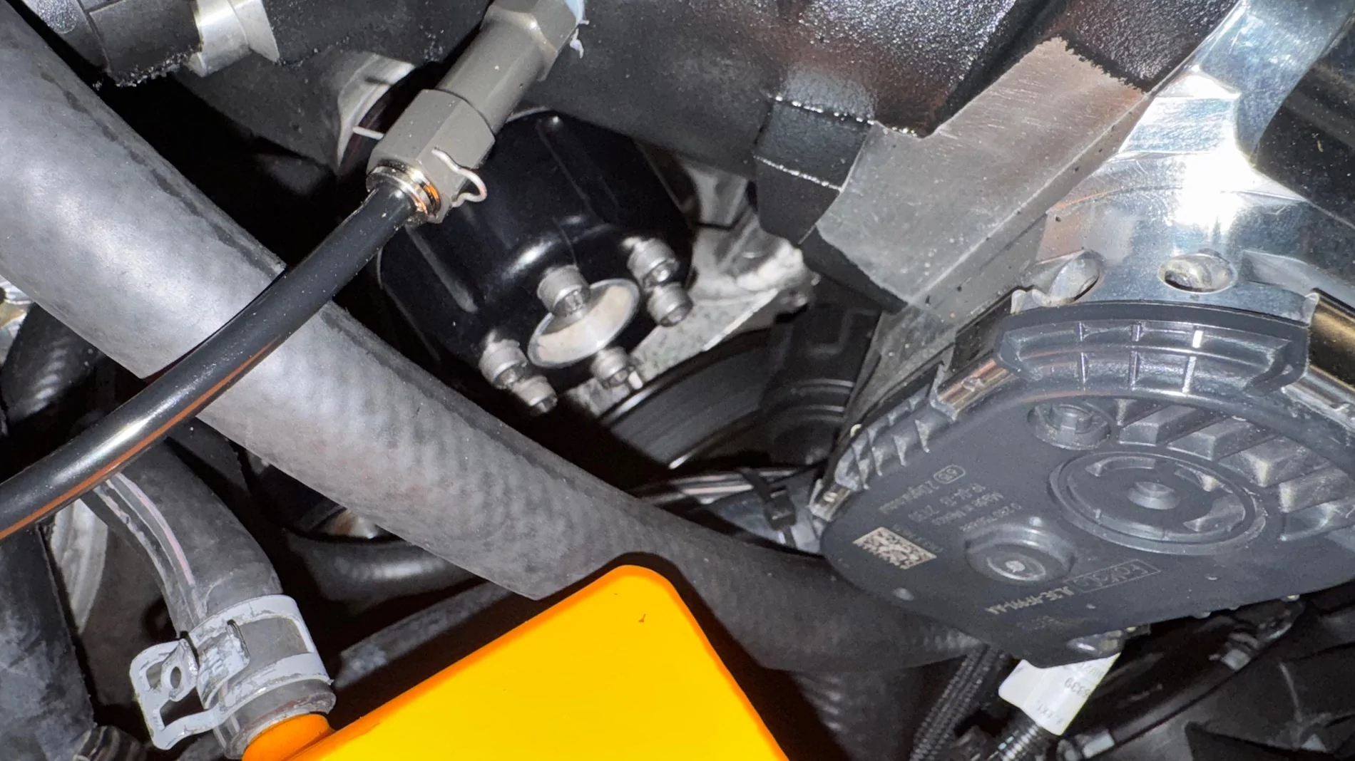

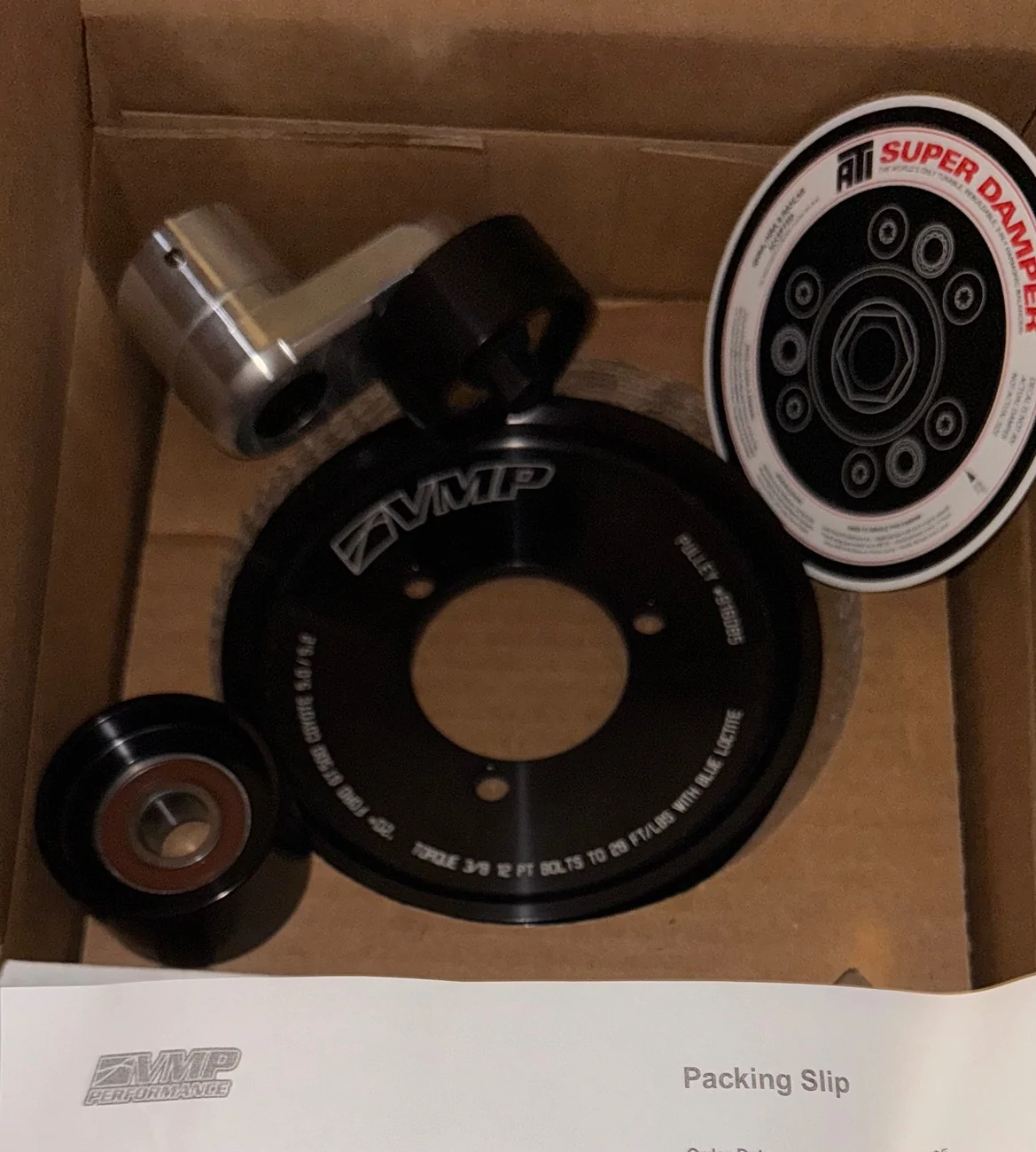

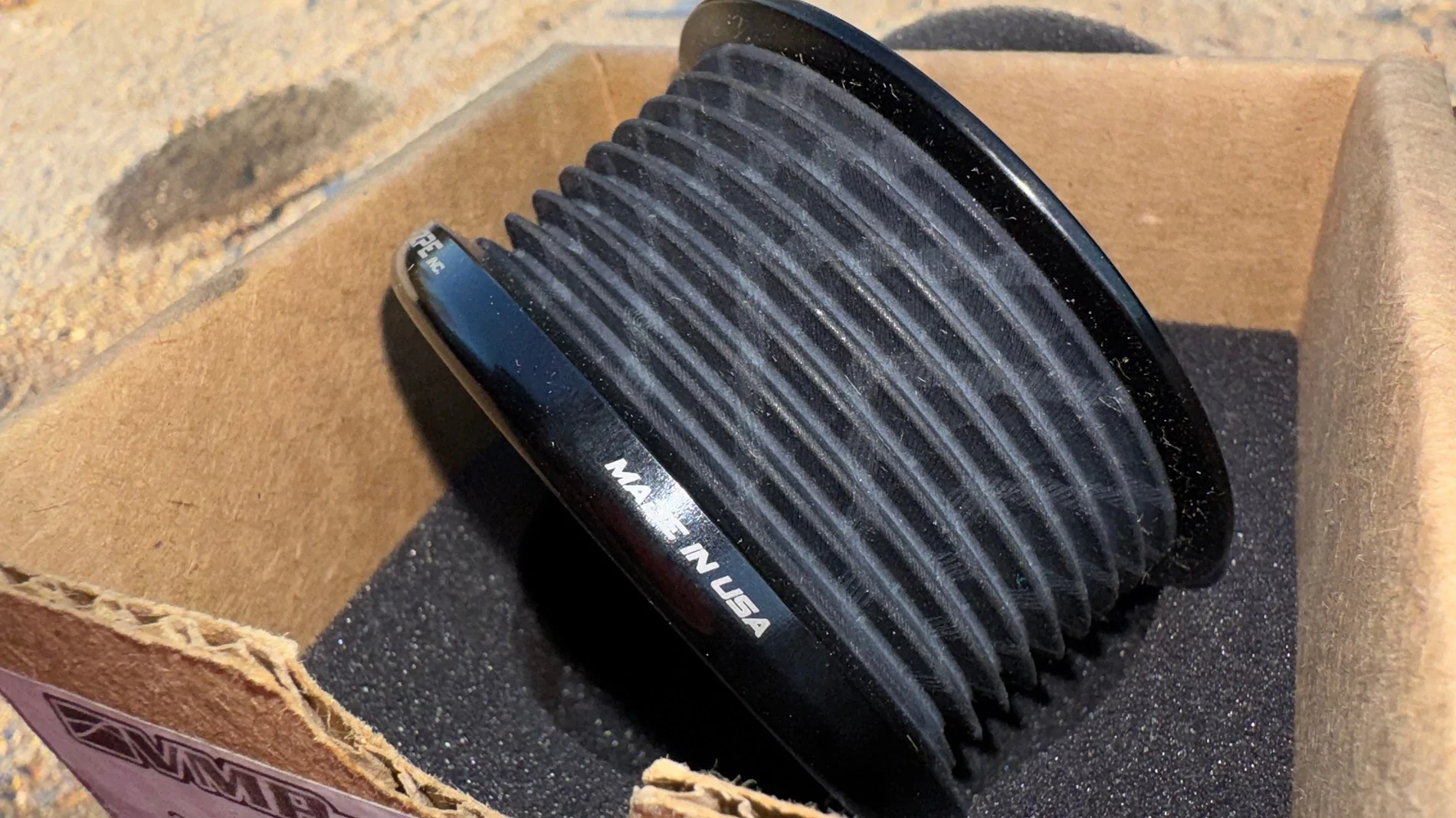

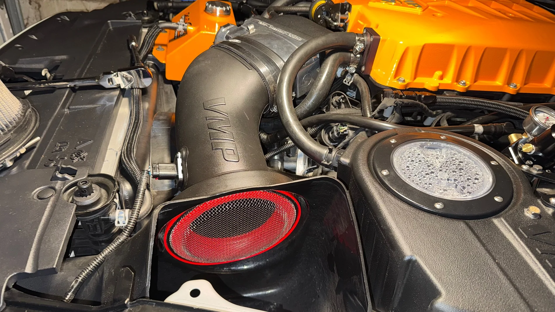

We are about to fix the belt slipping. A little more ribs and some texturing.
VMP Griptec 8-Rib pulley for Odin
ATI 8-rib Balancer
Mach1Racer
Mach1Racer
Oct 10, 2022
345
556
Everywhere
Mach 1
8 rib pulleys kit installed

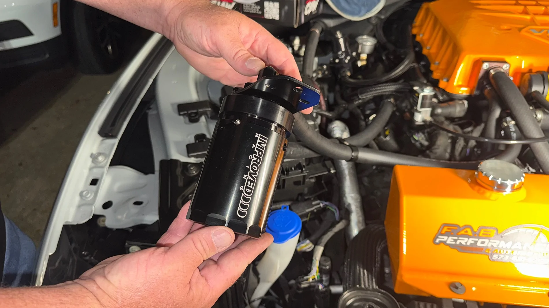

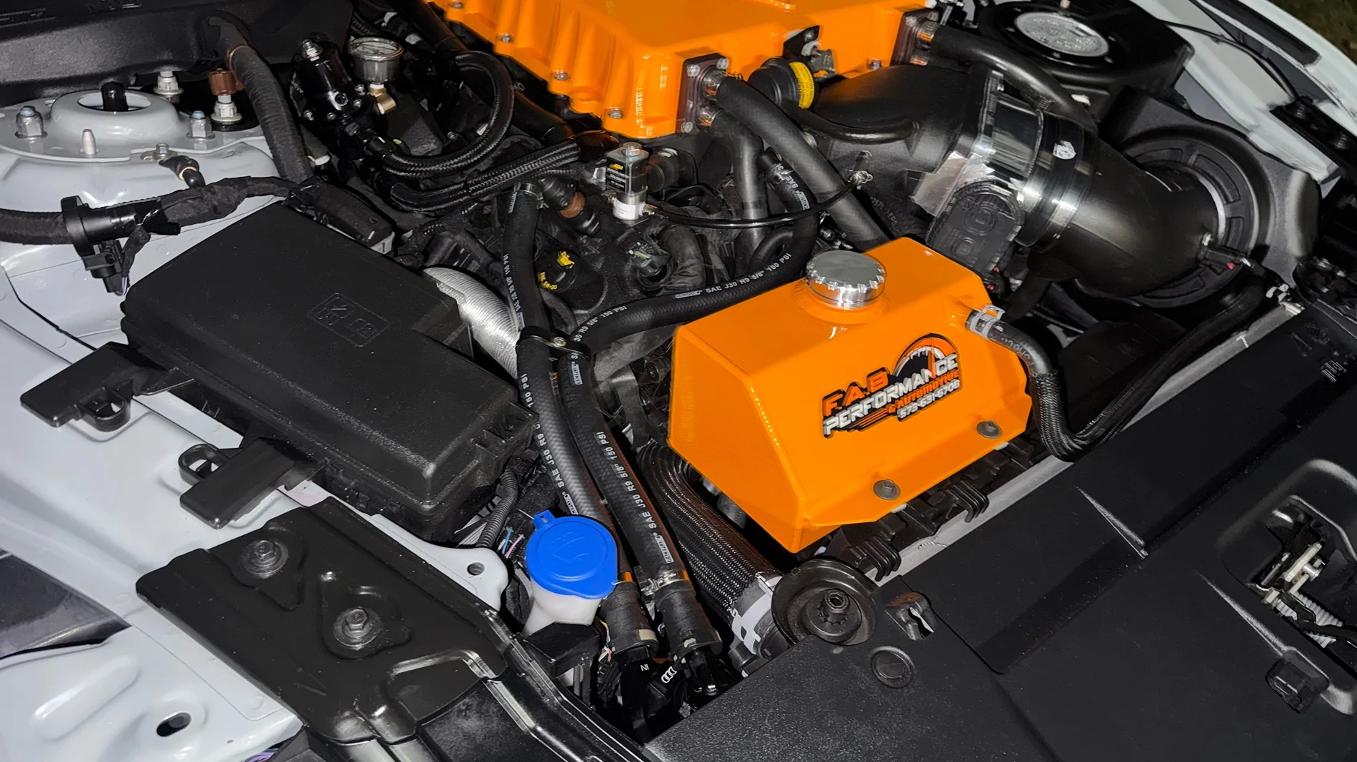

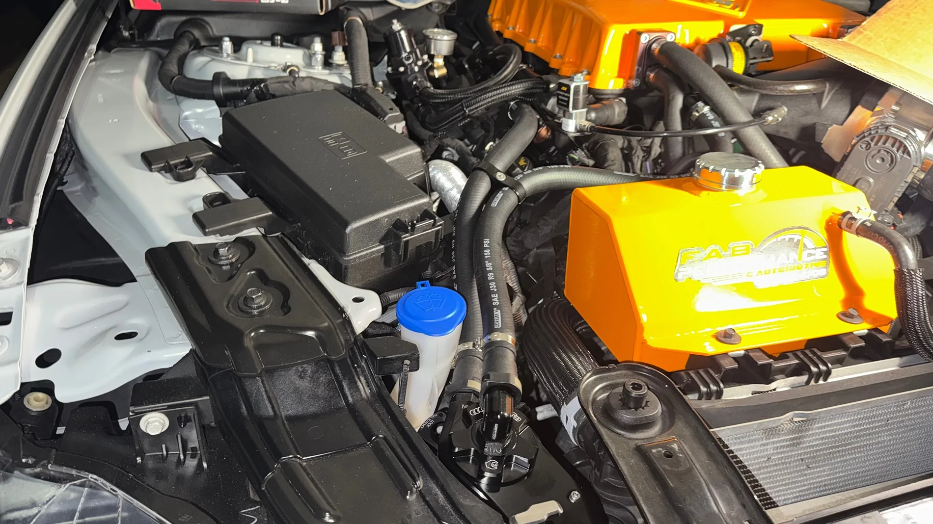

The next thing to tackle is a Catch Can Setup.

What are you doing with the driver side bank?
We weren’t get the oil from there for the most part. So, I haven’t done anything special for it.
I’m open to suggestions. What you got?
Ideally you would want another can, but if that side isn't producing oil vapor like the pass side then nothing to really fix. I run a separate can for each bank that is open to atmosphere and they collect a similar amount of oil/water/fuel.
Ok, I will look in to another can. We come this far already…

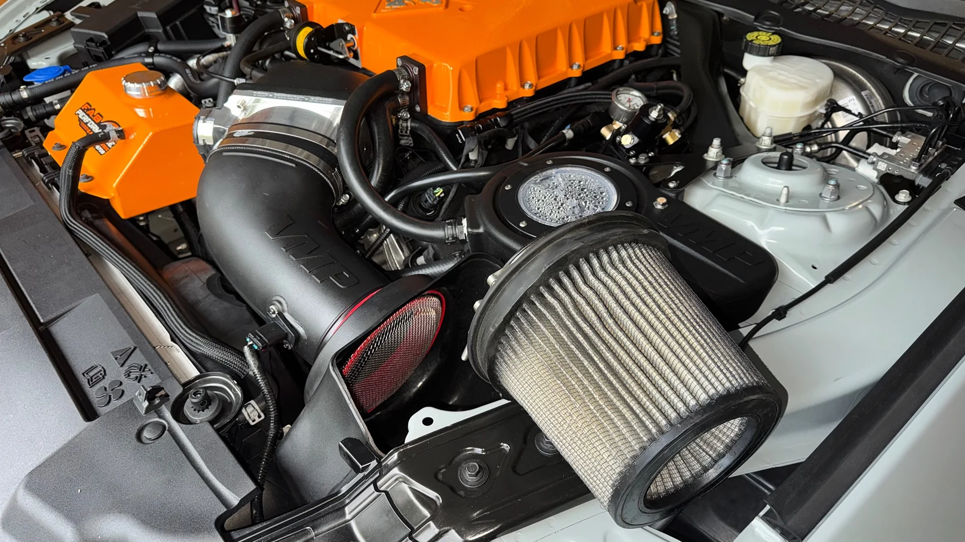

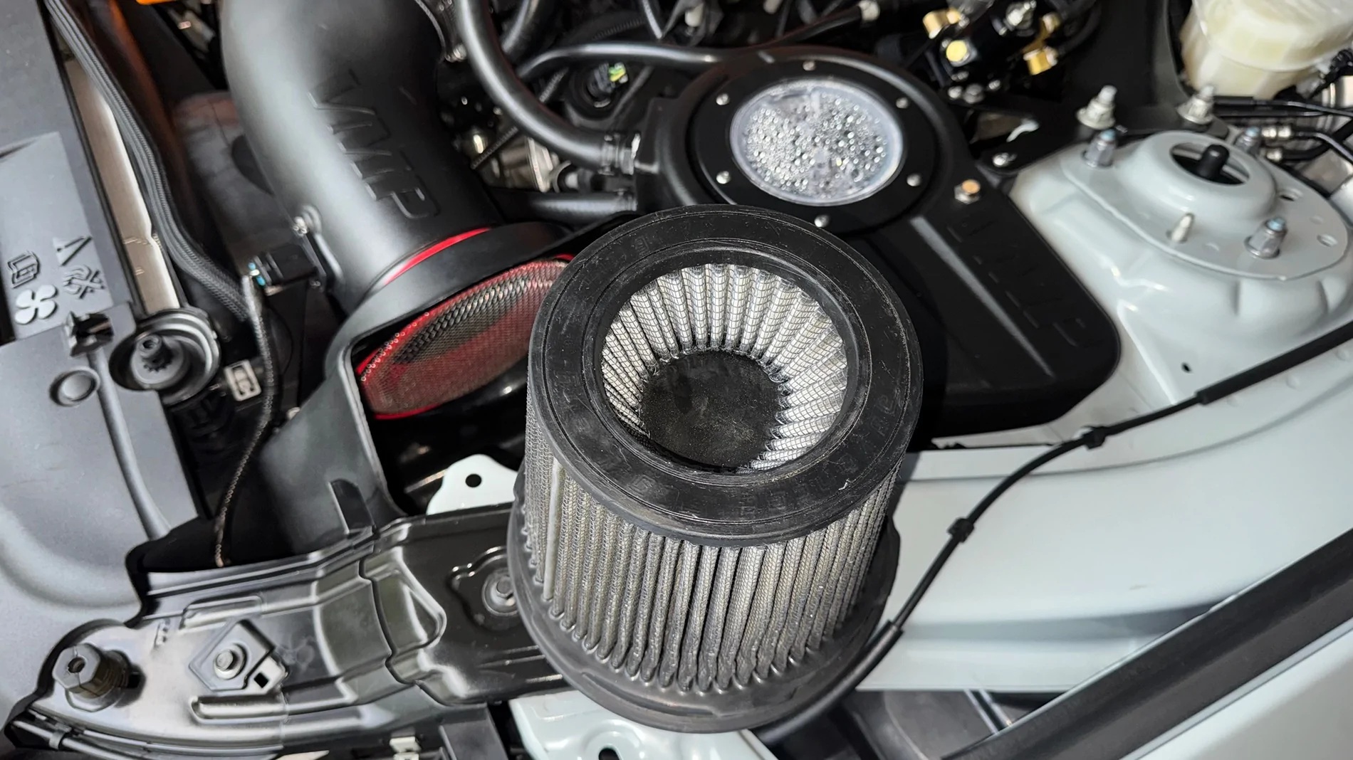

Gonna see is going to “turbo screen” on the intake will remove some restriction and pick up a little more boost.
I really think the filter on the Odin Kit would have benefited from being larger but there is no space for that.
